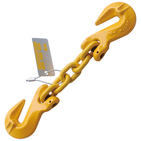

There is always a tendency to ‘yank’ or ‘jerk’ no matter what you’re doing. A short link of chain
as pictured above can be really handy and there’s weld on hooks that you can link a chain onto
so it’s a known fixed position without any fear of movement or slipping.
