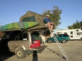

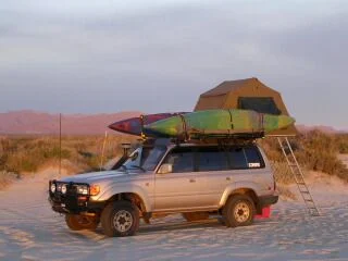

I'm running 4 78" load bars with Yakima A Towers. Fully loaded with 2 kayaks, Rooftop tent and awning I can definitely feel the difference. Even with just the Rooftop tent, which weighs in at about 115lbs., give or take, there is more sway. I'm running 850/863 OMEs, and usually carry an additional 150lbs of gear in the back on a daily basis.
I wouldn't do any real crawling with that weight up top without being REALLY careful. I do not, if I can help it, carry spare tires or gas on the roof, but try to keep relatively lightweight items up top.
