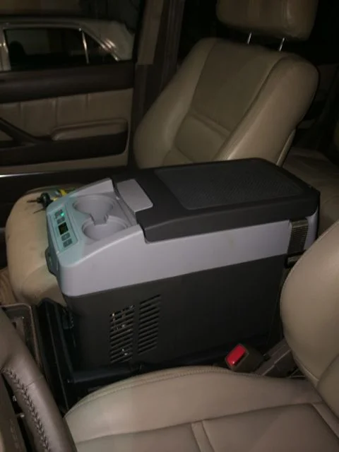

I am currently looking to purchase a frig to replace my center console, the “Benchmark” Dometic CF-11 that is no longer available new from the manufacture. We know it fits in the 80 series so lets look at its size to compare the others that are currently available.
(9.3 in W x 14.1 in H x 21.3 in D).
ImageUploadedByIH8MUD Forum1402366266.314552.webpImageUploadedByIH8MUD Forum1402364212.745832.webp

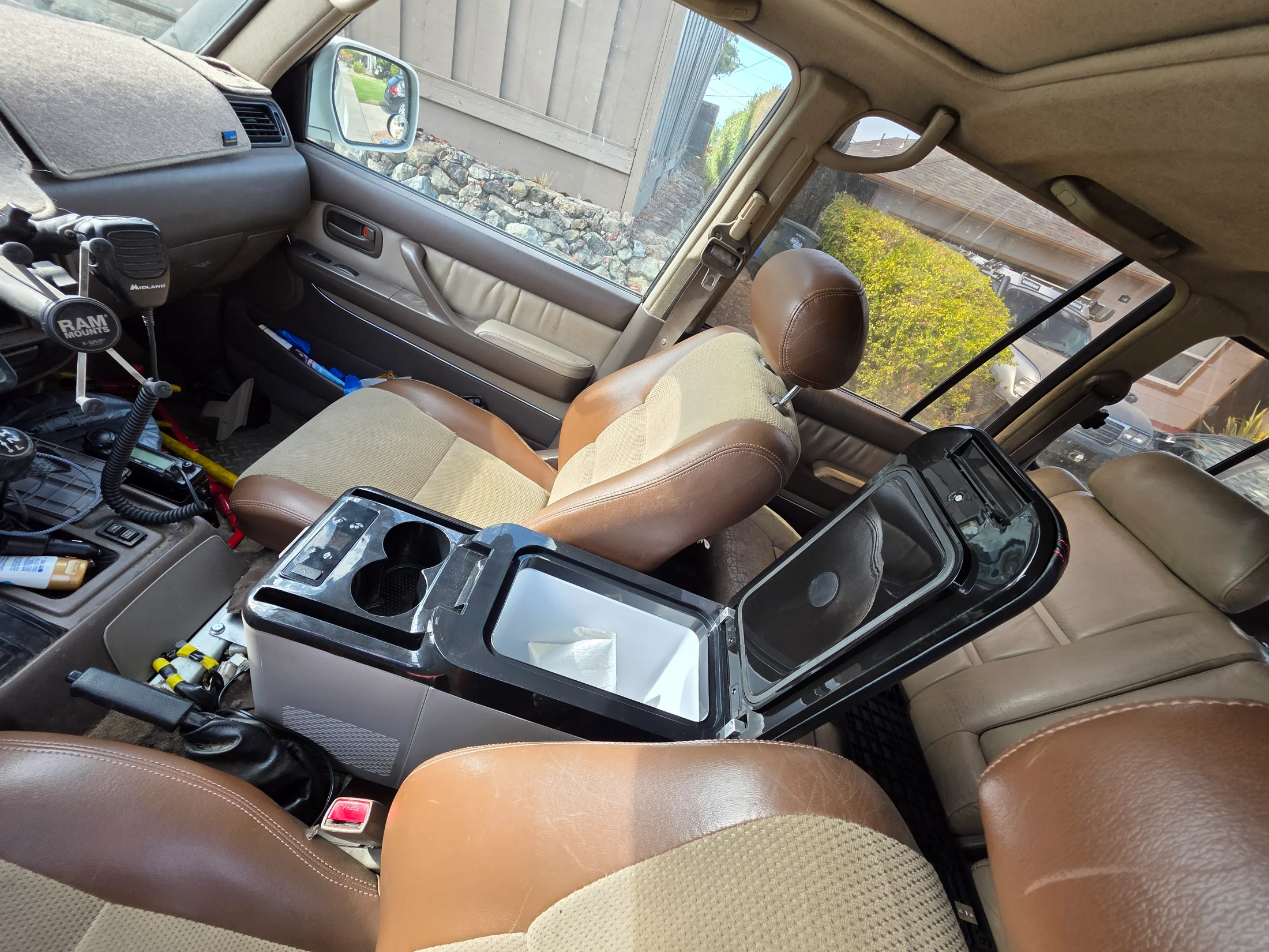

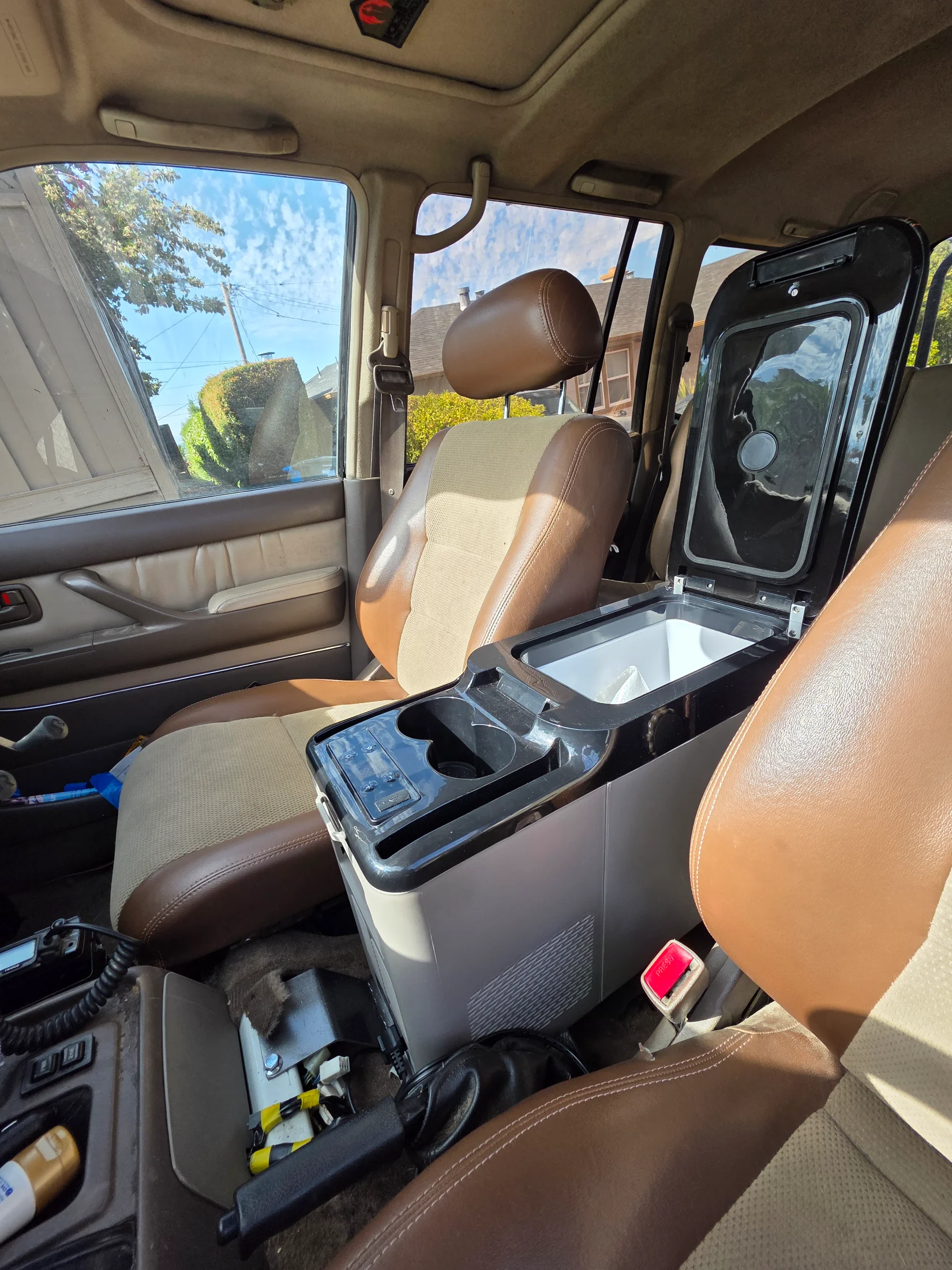

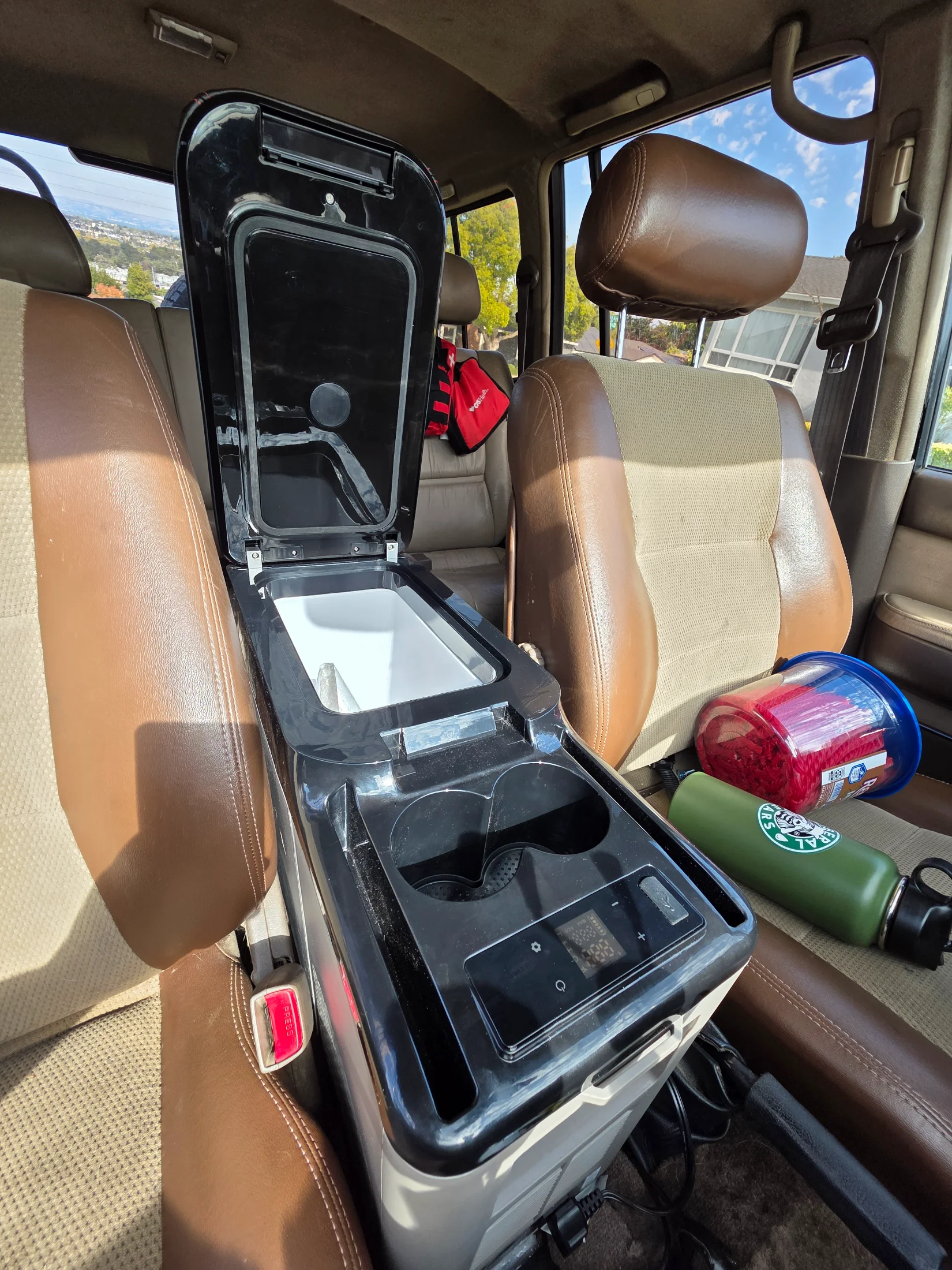

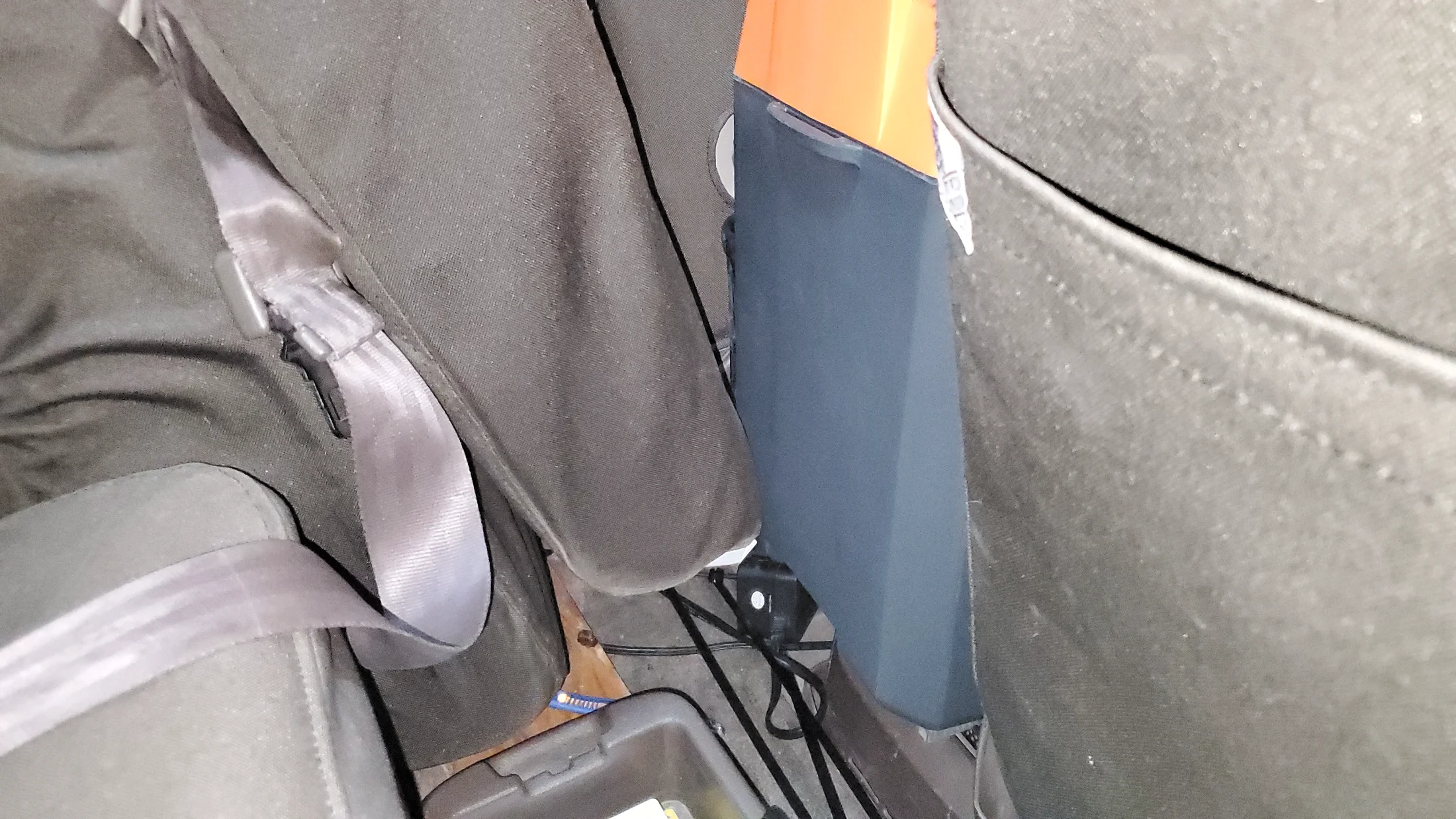

I made a mount for the bodega one for a friend. Here is how it came out.
I also made a cover plate fir the shifter console
View attachment 3994601View attachment 3994601View attachment 3994607
NICE, I wanted that one, it has USB ports in the rear, but it looked to big. I guarantee the 2nd row seats dont flip forward.
Originally, I slid it as forward as far as possible try to retain the rear cup holders but not enough room when 2nd row is flipped forward so I pushed it back till it hit the 2nd row seat. still need more trimming for the exhaust vents.
Its all compromise
With the bodega where I put it the rear seats do not fold forward. Something the owner does not do.
He came with the bodega and asked for it to be installed.
It was pushed back to make the top as low as possible, its bit high even that far back.
Three fingers, and there is a Tape measure with in 1 finger.. Love it

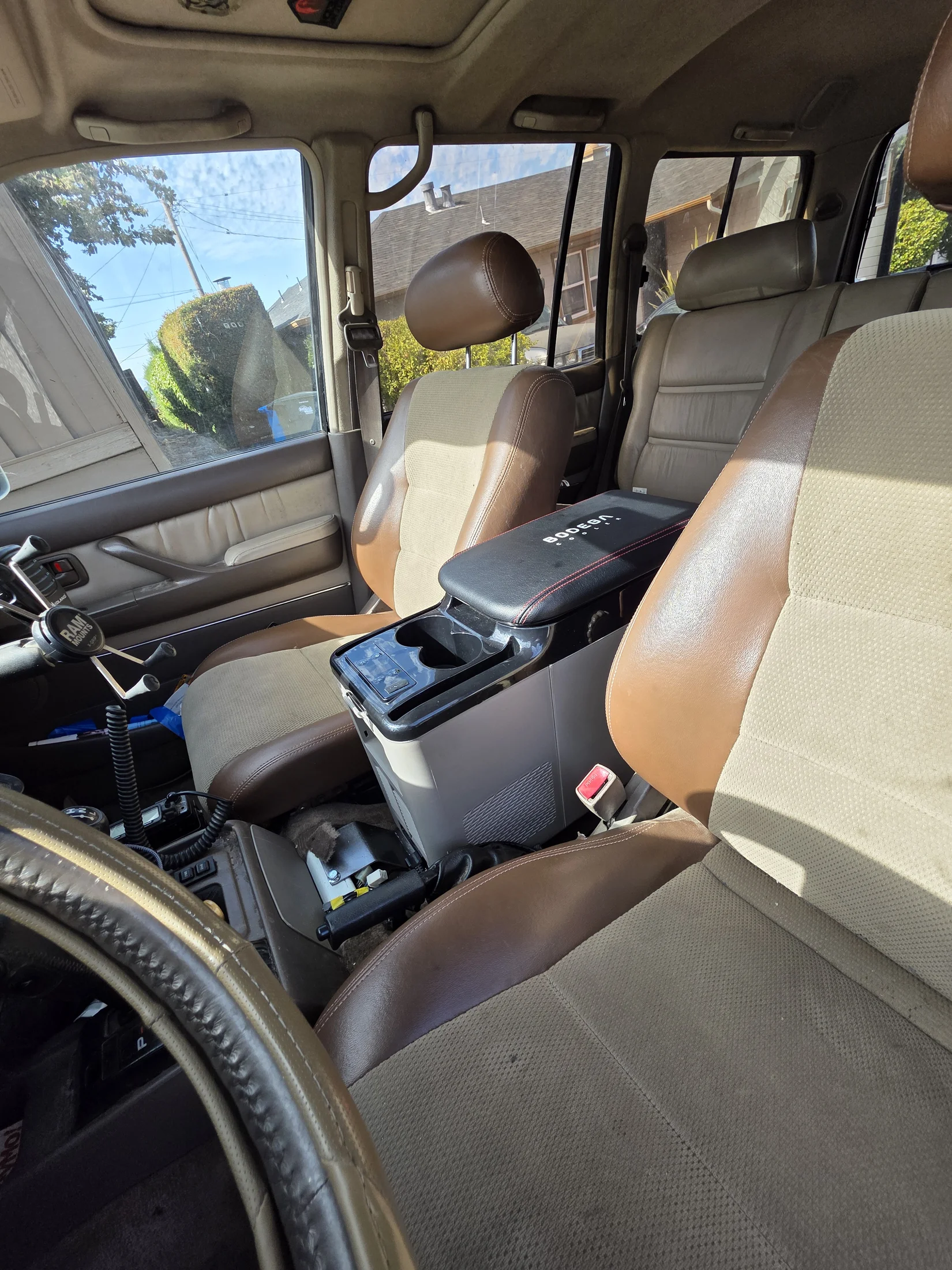

How is the height as an arm rest?
Mine in the current position is about 4.5" higher than a fzj80 arm rest.
Im on the Lx450 bracket & can lower it 2" to 4" lower, but as one lowers it must go back.
I also have a AC converter below it.
I maybe can lower it 2" more & slide it backwards 1"
I could also just lower the rear, tilt it per say.
I deffinatly have some descisions to make before final fitment.
