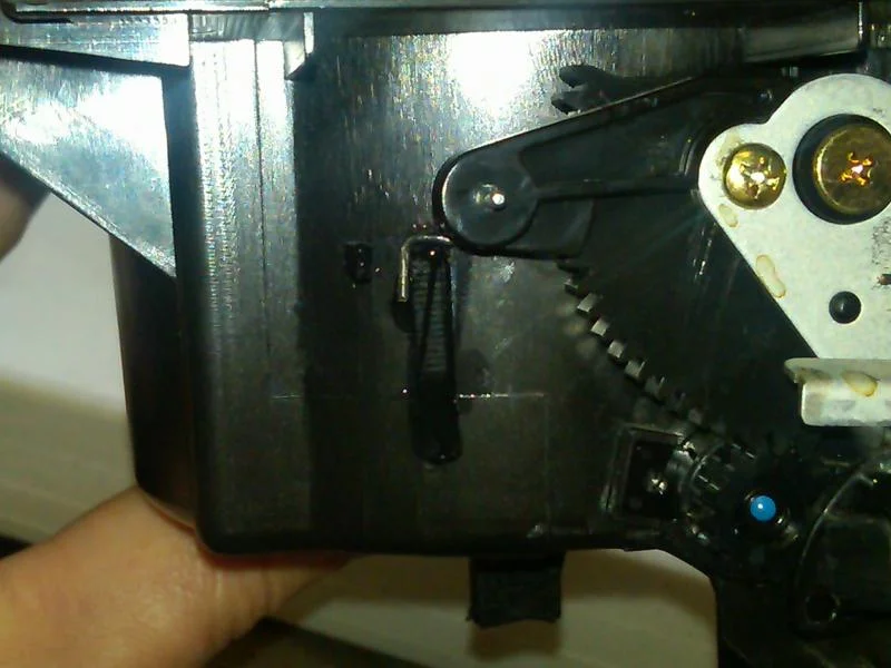

Not a big deal but want my smooth action cup holder cover to work again. Took the center console apart to see what was going on. The cover is slow to open - even stops mid-way through - and is making a clicking noise.

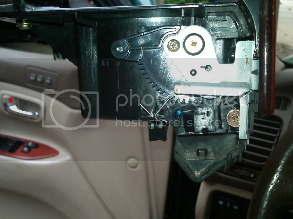

The arrow in the photo is pointing to the end of the spring and doesn't look right, in terms of not being attached to anything. Plus, it's making the clicking because it is moving during opening.
The video might not be much help as you really can't see what's going on, but the clicking sound is coming from the elbow part of the spring as it moves during opening.

Do you mean you realized you could've removed it with three screws, or you could remove it with three screws after removing the entire center console? I'd like to pull mine out to compare it to yours just to see if there's something obvious. My shop builds machines that assemble things like center consoles, we've usually got plenty of these kind of compartment door openers laying around, but they're all custom and not usually interchangeable.
^ the later - looks like I could remove via the three screws only after pulling the entire console out. I say "looks like" because I haven't actually unscrewed it yet - maybe it is additional attached somewhere else - will try tonight and see.
Ok think I figured it out.
There was a tab broken off in which the spring wire attached to (arrow at bottom right). I glued a new, longer/strong tab on and in testing it prior seems like this will fix it. The clicking sound was coming from that spring wire moved over the gear as the cup holder lid was opened and closed.

It was some type of resin my partner had at work - said it actually bonded (melted) the two plastics together. It certainly is strong enough to hold that little spring wire.
Door works smooth as new.
