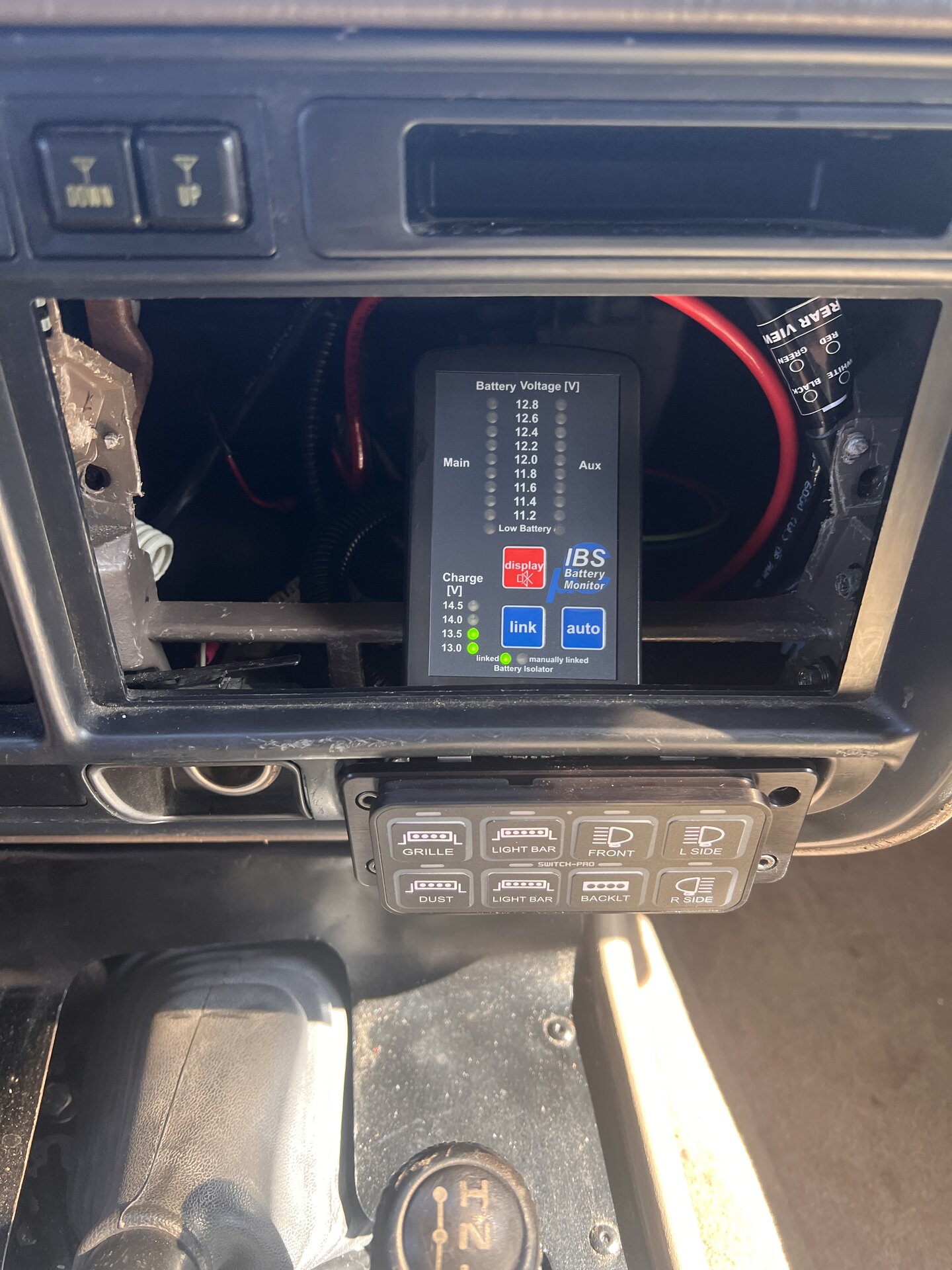

I would like to mount a CB radio in the double din location. I have not found anyone who offers a double din CB.
Perhaps a single din CB, but with which bracket what mount?
Also trying to find a location for the dual battery monitor.
Curious to know what others have done.

That would be a great idea, get both of them in the double din spot. Hadn't thought of that. I don't use the radio any longer, so, might as well make it useful. Maybe @NLXTACY will make me one :)
