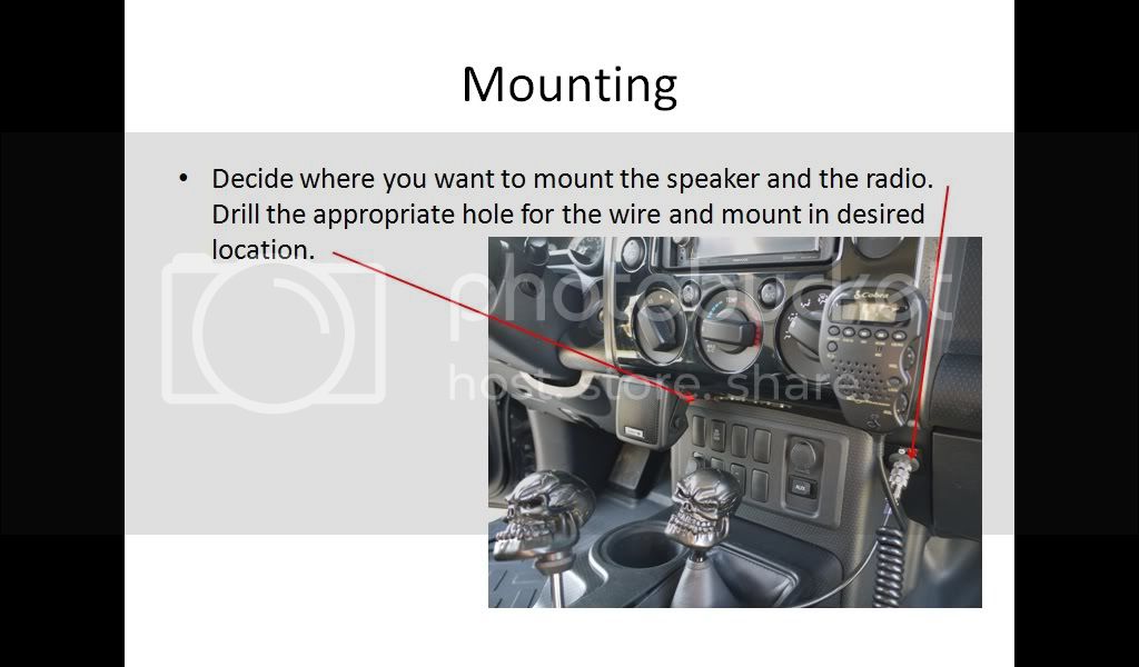

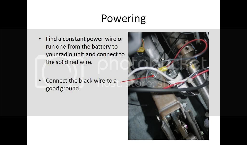

This thread is meant to just help you with some of the things I ran into that were not easily explained on the website. The Company I got the CB from are pretty good about posting on their site how to install most of this stuff.

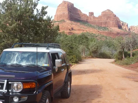

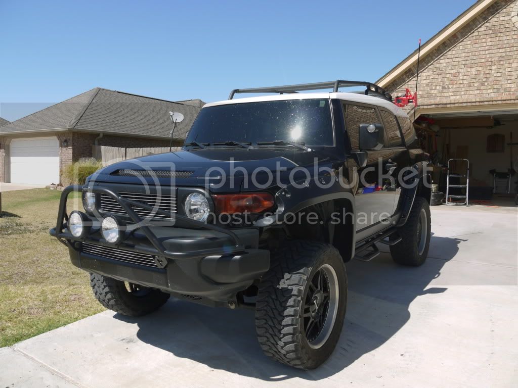

Here it is with the antenna mounted. Now to just get some time off work so I can trail this thing.

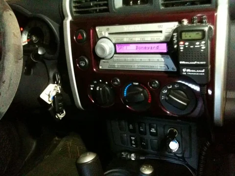

I went with the Midland portable option. Here's my mount. You can see power from cigarette lighter, and antenna connector to cable under driver's side dash. I velcro'd the connector so when not in use, it stashes behind the dash.

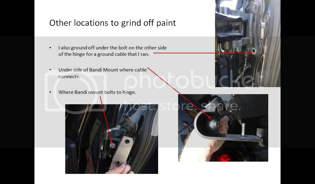

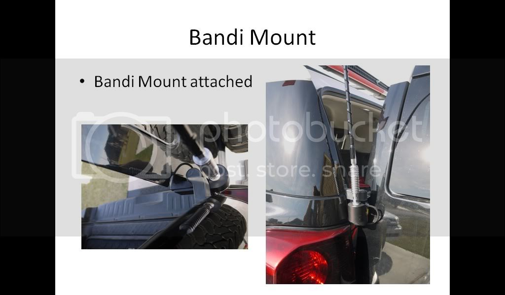

I am not knocking the write up here, but there is some misinformation. You do not have to unbolt the door hinge to install the Bandi Mount. The best way to route the cable is to drill a 3/8 hole in the door just below the upper hinge and install a grommet, then route the cable through the waterproof conduit between the door and the jack compartment.
You really dont need the additional ground wire on the mount either if you clean the area up properly. I remove my mount every 6 months or so and clean/inspect the mounting surfaces just because I am that "anal" about the bonding.

VegasNick, thanks for the info. I may have been over zealous in my grounding methods, it was my first install. Great looking FJ!

Regarding tuning, my SWR wen't from 2+ with just a whip, to 1.3 with a spring, to 1.0 with a spring and quick disconnect. The antenna really needs to protrude past the body. If I were to do it again, I would mount off the front bumper.
