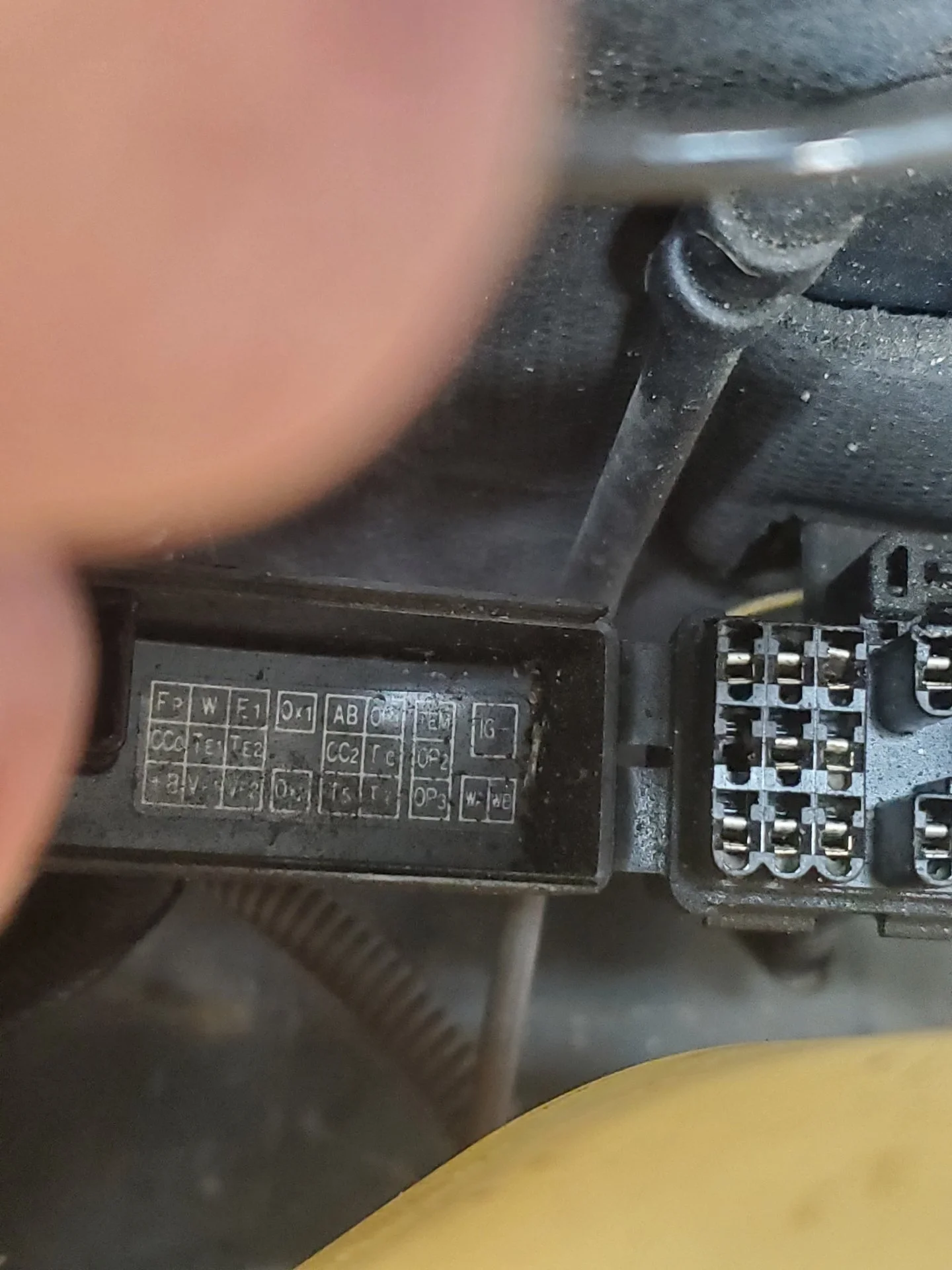

Your '94 is OBD1. The diagnostic port is located on the passenger side of the firewall. To read the codes you need to insert a jumper (paperclip will suffice) between TE1 and E1. Turn on the ignition and count the flashes of the CEL. Flashes are in 2 groups - 2 flashes, pause then 3 flashes would be Code 23. There may be multiple codes. Do this and post the codes here and we can help with the next step.

Can't I just get a obdm1 scan tool or is that obsolete
There is an ODB1 scanner called TOYOCOM. Not sure how available they are. The paperclip will give you the same results at a fraction of the cost.
For the 94 with odb1, there is no sensor after the Cat. So the check engine like is probably not related to the missing Cat. My guess is either with the EGR or the O2 sensor. You do gain little bit more power, especially on the top end but you will get a little worse gas mileage.
