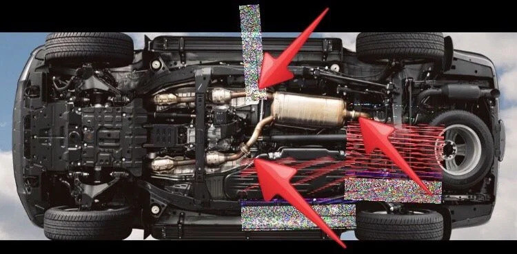

Muffler case is 24" x 10" x 5.5". The stock muffler is roughly 28" x 11.5" x 8". Most Borla Mufflers are a straight through absorption type. This design is a hybrid absorption with a single expansion chamber... it was designed for V8 engines.

If the rear resonator does not restrict the exhaust then leaving it in might be beneficial.
Maybe one of your options could be a mid-section bolt on.
If there is no recourse with removal of that resonater like others have stated what would be benefit with keeping it? Only because the Borla muffler is louder then stock perhaps?
I'll wager there is a sound difference w/o it, somewhere. Probably a bit more noticeable to pedestrians that have just been passed by, than by those in the vehicle. The Borla will be louder, but this particular unit is very mild as far as these types of mufflers go. Adding a rear muffler might be key to getting it as quiet as stock.
