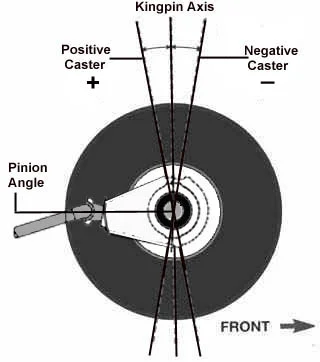

negative castor you mean........top to the rear , bottom to the front. i do 4 degrees on mine.
hmmm yeah top back, some people/pictures say positive some say negatave is top back....
They are wrong
Postive Caster is always towards the rear of the truck.
5* is a good number.
They are wrong

0* means the kingpins are directly above each other.
5* means the top KP is moved to the back of the truck. Picture the limbo ;)
Or picture this.....
