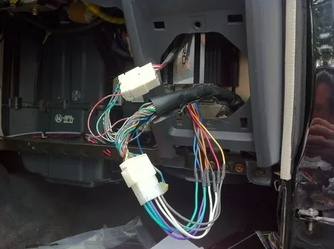

So I pulled the dash off today to figure out why the sound would not come on with the amp. Apparently the amp plug behind the dash does not go strait to the plug at the factory amp location. It ties into other circuits such as the lights and antenna.
I am still using the amp wiring for the rca's because that seems to work just fine. Instead of running new speaker wires I figured out which pins on the other amp plug went to the doors and modified an adapter that's supposed to be used for the head unit. Now the sound comes on with the computer and sounds much better, so i am pleased:bounce:
rewired amp
