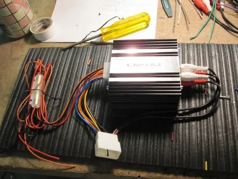

I'll start this off with the wiring for the amplifier, mostly because i cant seem to get it right

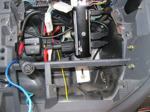

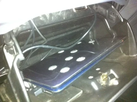

Basically its a netbook(running centrafuse front end) tucked in the glove box, 7" capacitive touchscreen, and a carnetix power supply to juice it all up. The amp is a small NITRO and seems to be about 25 watts x 4 and fits nicely in the factory location. Everything works fine except i don't get sound (even though the amp is on, shown by a green led) until i turn the lights on! Once i do the antenna pops up and the sound turns on. Even after i turn the lights off the antenna stays up and the sound stays on until i turn the car off, or......if i turn the music up too loud the sounds cuts out and the antenna goes down! then i just flip the lights on and off again and back to the music.

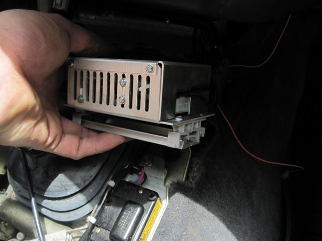

So what i did to keep the wiring behind the dash to a minimum was to pin out the factory amp connectors from behind the dash and found(at least i thought i found) that they pin through to the factory amp location. same plug and everything. I bought two amp connector kits which have four rca's and 8 wires. perfect for rca in and 4 speaker outputs. i wired the power for the amp seperatly.
If i have everything powered up (amp is on and computer is playing) and i unplug the amp (from the amp location side) the antenna goes up, plug it back in and the sound plays fine.
Another thing i have found is if i dim the dash lights, i get a terrible buzzing sound!
Connector color codes from the package are as follows:
yellow = 12v constant
red = 12v ignition
blue = power antenna
blue/white = remote turn on
orange = illumination/dimmer
black = ground
speakers are the usual
Currently the blue is hooked up to the ignition but it doesn't turn on unless the lights are turned on, i thought they might be switched with the illumination so i tried to power the orange and the dash lights would go on with the ignition:whoops:
