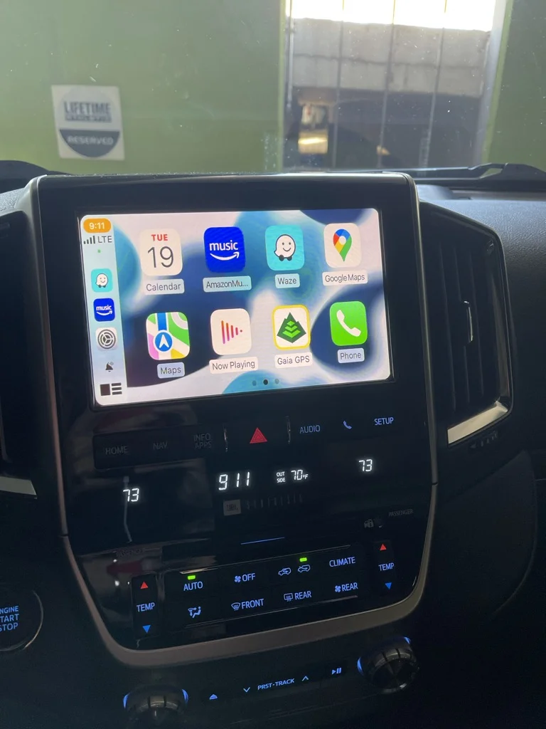

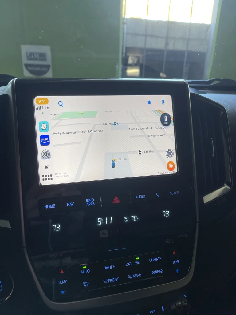

CarPlay works in a 2020 Land Cruiser

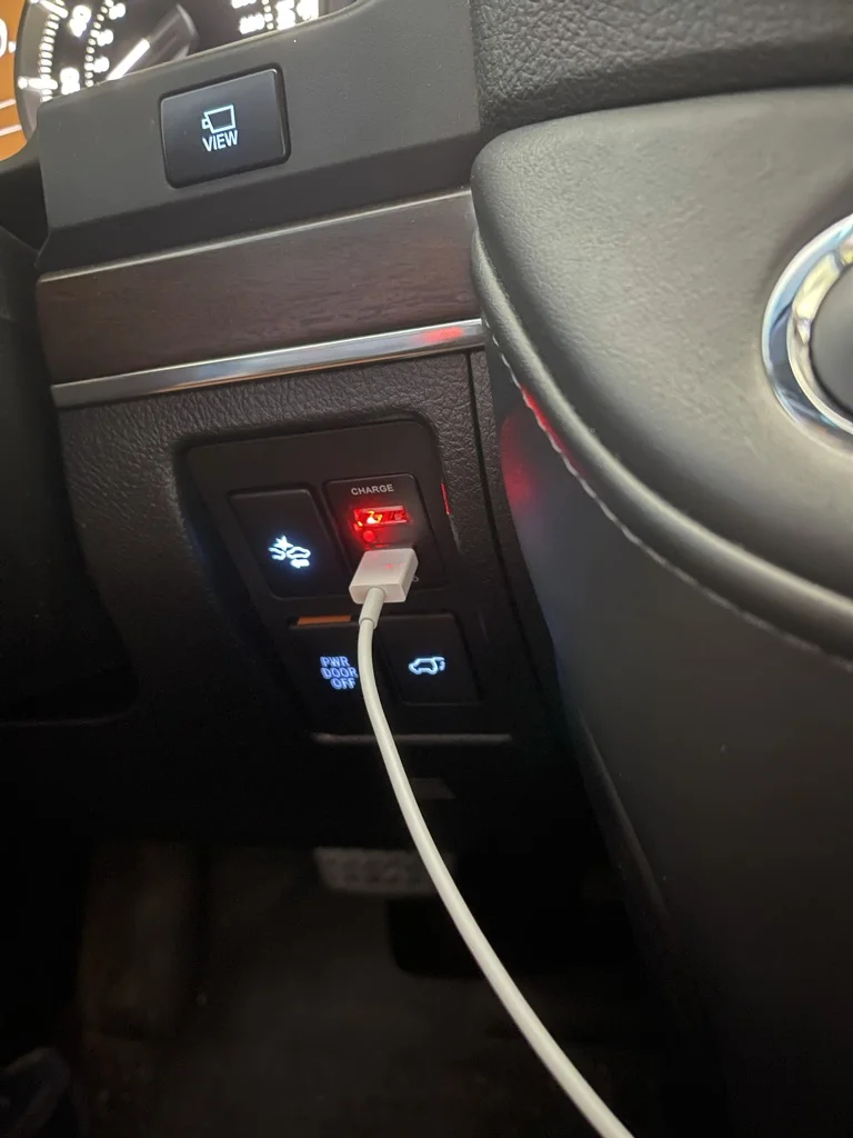

So, I was able to do a quick test today. Drove for about 15 mins twice and both times my battery level increased while using carplay and connected to the USB slot. First time I placed the phone in the wireless charger pad and the pad light indicated that it was charging (no idea if it really was). The second time I just placed it in one of the cup holders and the charge again increased from 30% to about 40% by the end of the trip. Beatsonic's product page says the phone will charge while connected. Looks like this is accurate.

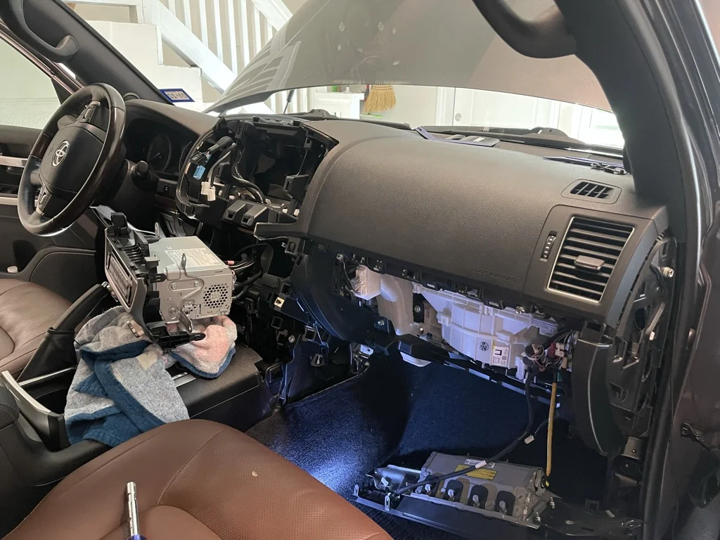

Couple pics of the setup and of the ordeal to install. So far, no complains.

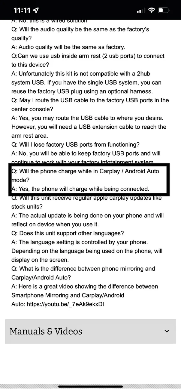

Well, that's encouraging on the charging for sure, though their site does indicated the product doesn't support fast charging. It would be really interesting to see if any of the wired to wireless CarPlay adapters that are available primarily for factory CarPlay work with the Beatsonic to convert it to wireless. The Beatsonic only adds CarPlay / Android Auto - it doesn't add the ability to install and run Android apps on the unit itself, correct?
It looks like you had to take the glove box and passenger side airbag out to install the Beatsonic - is that really necessary? The other units install behind the factory screen and don't require removal of as much stuff to do the job.
Correct. No additional apps or anything else. Just CP/AA, like regular OEM units for other cars. Yes, they recommend that you remove the glove box and drop the passenger knee airbag to access the lower compartments. The two boxes go in that area, as opposed to behind the screen or radio units. In the YT video they say that although there is space for installing the boxes behind the screen, doing so may cause heating/interference issues, so I stuck with their instructions. The boxes however do not get in the way of the airbag and one must disconnect the battery before manipulating the airbag to avoid accidents.

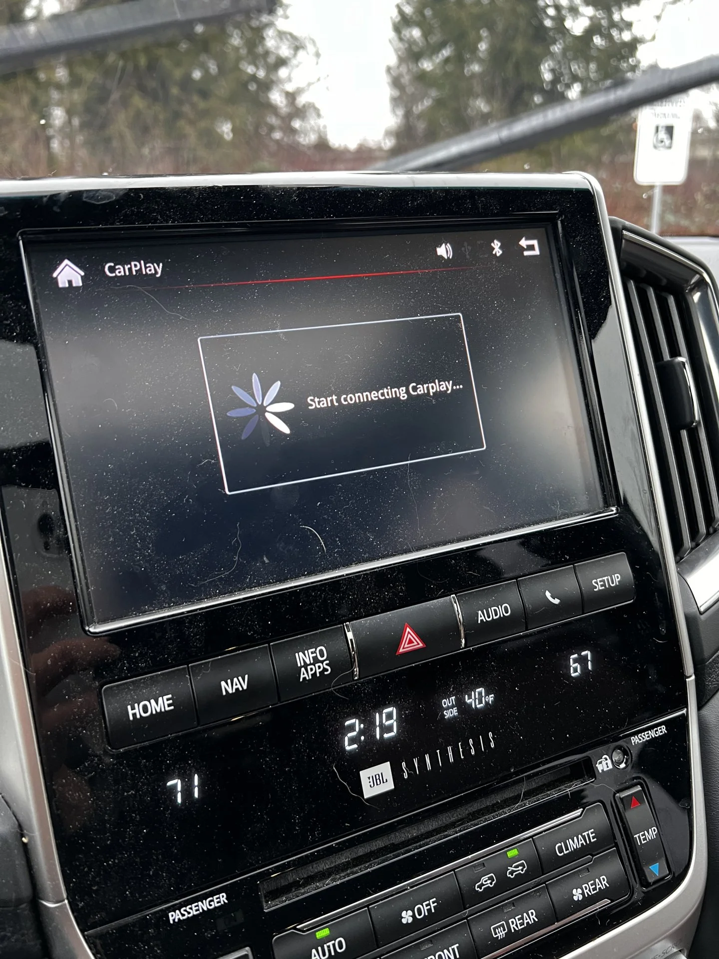

I have the Naviplus unit and recently noticed that it spins per the pic and doesn’t load CarPlay. Anyone have similar experiences or a fix? Was working just fine for the past 6 months
^^ I think I fixed it I forgot that it connects through Wi-Fi primarily and then Bluetooth. RTFM’d my way back to stable connection so far.
It's actually the other way around. First is Bluetooth, then WiFi. It does the handshake via Bluetooth, then it connects via WiFi. You can actually disconnect BT altogether after the connection has been established and it will still work. Obviously not the other way around.
Couple pics of the setup and of the ordeal to install. So far, no complains.View attachment 2816269View attachment 2816278View attachment 2816279View attachment 2816280View attachment 2816281
What USB charger is that? Does the fact that they light up bother you at night?
