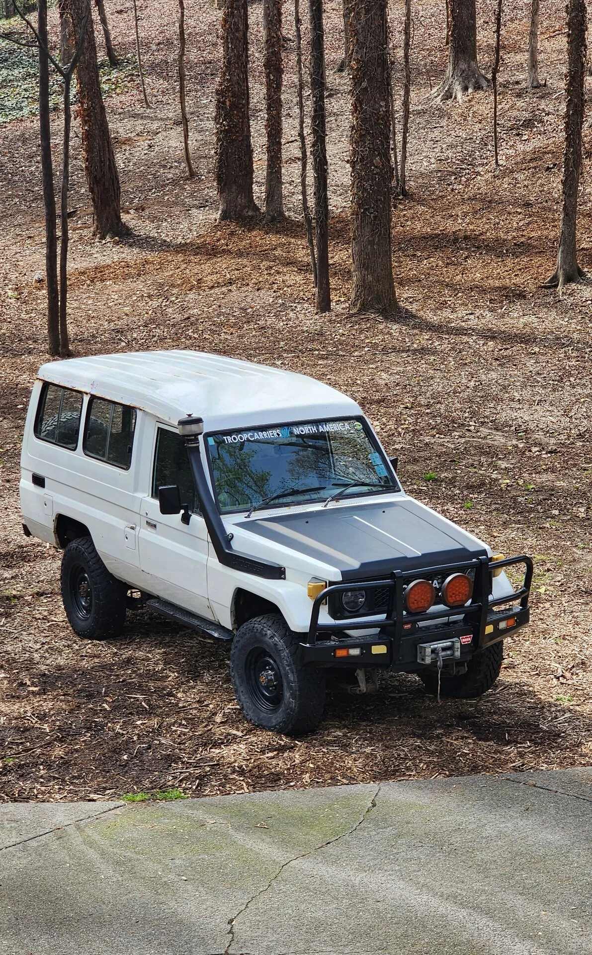

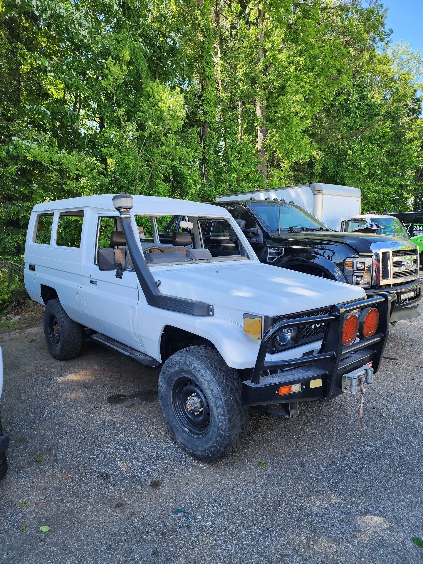

I've been out of the game bringing back Cruisers to life for a few years. i bought a 1989 HJ75 Ttoopy. I finally got the itch again......and long story short is I bought a Troopy in need of some major repairs. It has all the basics needs except looks.........by a long shot. It has a 2H engine that's actually in decent shape and has been rebuilt at some point over the last few years. It runs and drives, but minimal gauges work. With 666,666 kms on the odometer that's a tough prize to work with......... good luck right??
I've been through the whole rig. It's not terrible except for the body work and rust. The frame is completely solid and the diesel engine is a tank and currently has no leaks. It's definitely something the other half........aka....Mrs. Roe will not enjoy.

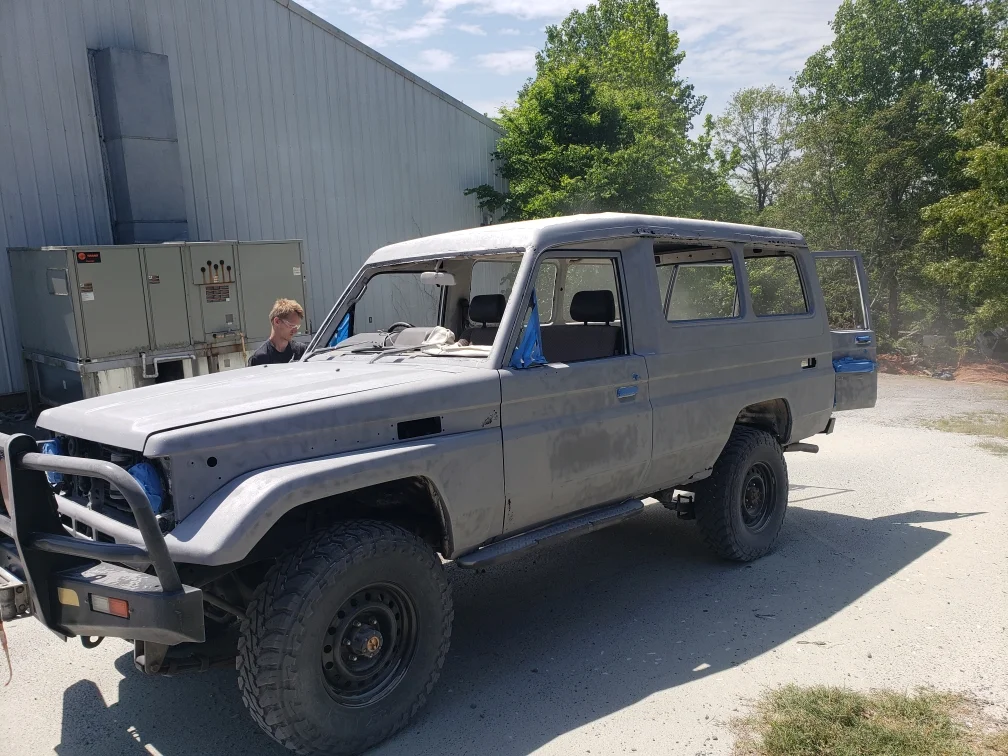

A little backstory is that I've been trying to get this vehicle back from SLC for the past few months. Sitting in these salty conditions have done a number on it.
Part #1:
Prep& Strip
- Media blasting......I've never tried this, but it sounds fun. Dry media blasting.......more to come with a video link.
- Removing the side windows was a chanllenge. This may evolve into gullwing windows since the original windows are on their last leg.
Mechanical work
- 2nd Battery install and ReArc system.
- Rear locker rework and run new compressor lines.
- Auxiliary fuel tank gauge repair and re-establish connection and functionality.
Will provide updates as it progresses.

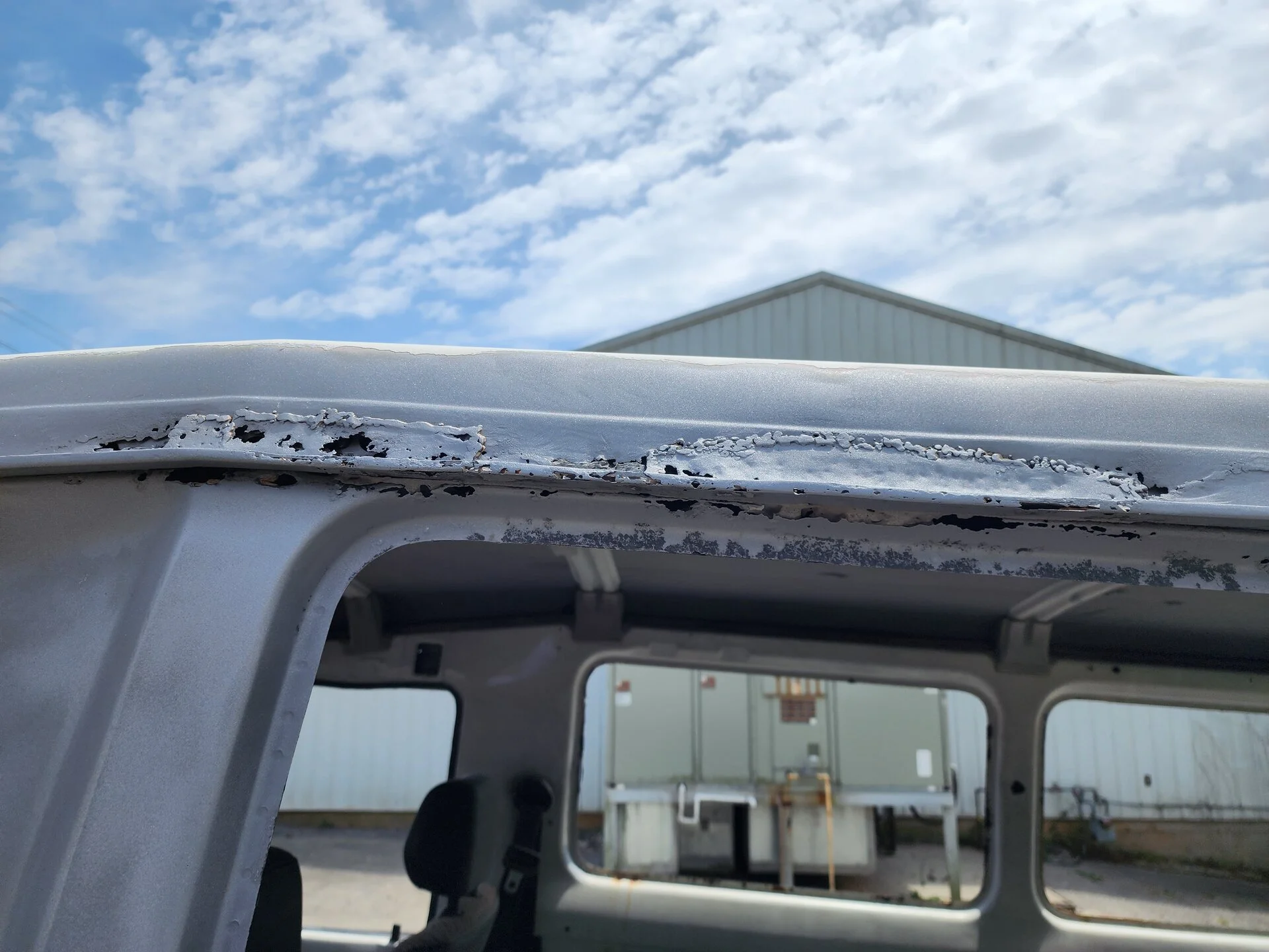

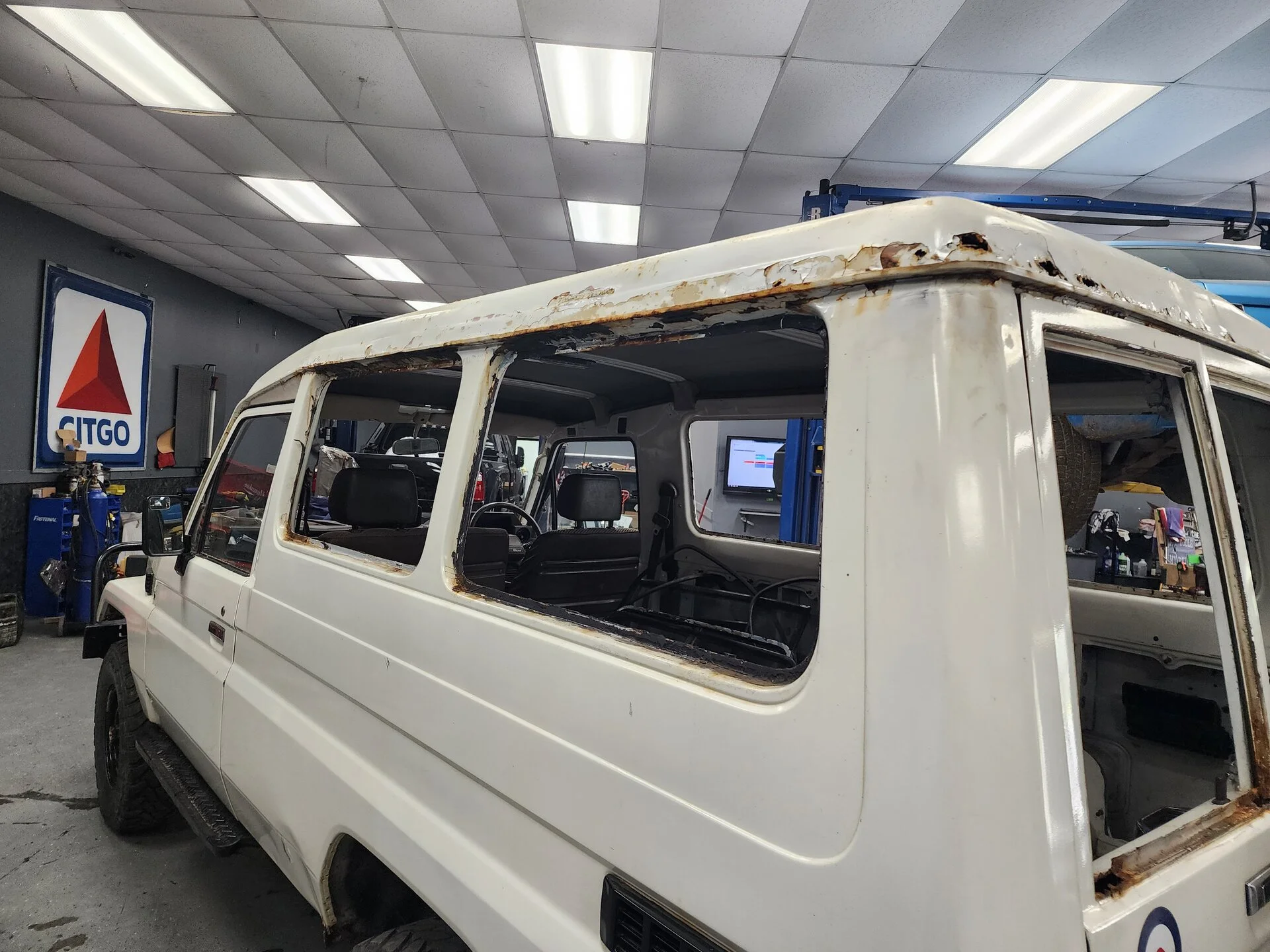

Congratulations on your troopy, there's a few around in NC- one in Wilmington, the outer banks (mine) and one in Raleigh (ONSC member with an Alu-Cab). I think there is another one or two silent holders. I have an Alu-Innovations top just not installed yet. They were willing to sell direct, and send to an international airport, where I had to pick it up. I am dealing with some roof rust before putting it in place. If you are interested in the Alu-innovations shoot me a PM. All of the pop tops that I'm aware of use adhesive to bond to the sides of the roof (roof is cut approx 2.75" above the drip rails), and also mechanically fasten to the roof support brackets. You would want to take care of the rust in the gutters and sides of roof before installing one.

That's depressing. Talk with @Hokie LX about what it takes to repair those roof skins, lol.
Good luck with the roof rust. Just finished repairing all the roof rust on my 60 and did a quick write up here.
Full details in my build thread. I’m excited to see your results! It’s a satisfying project.

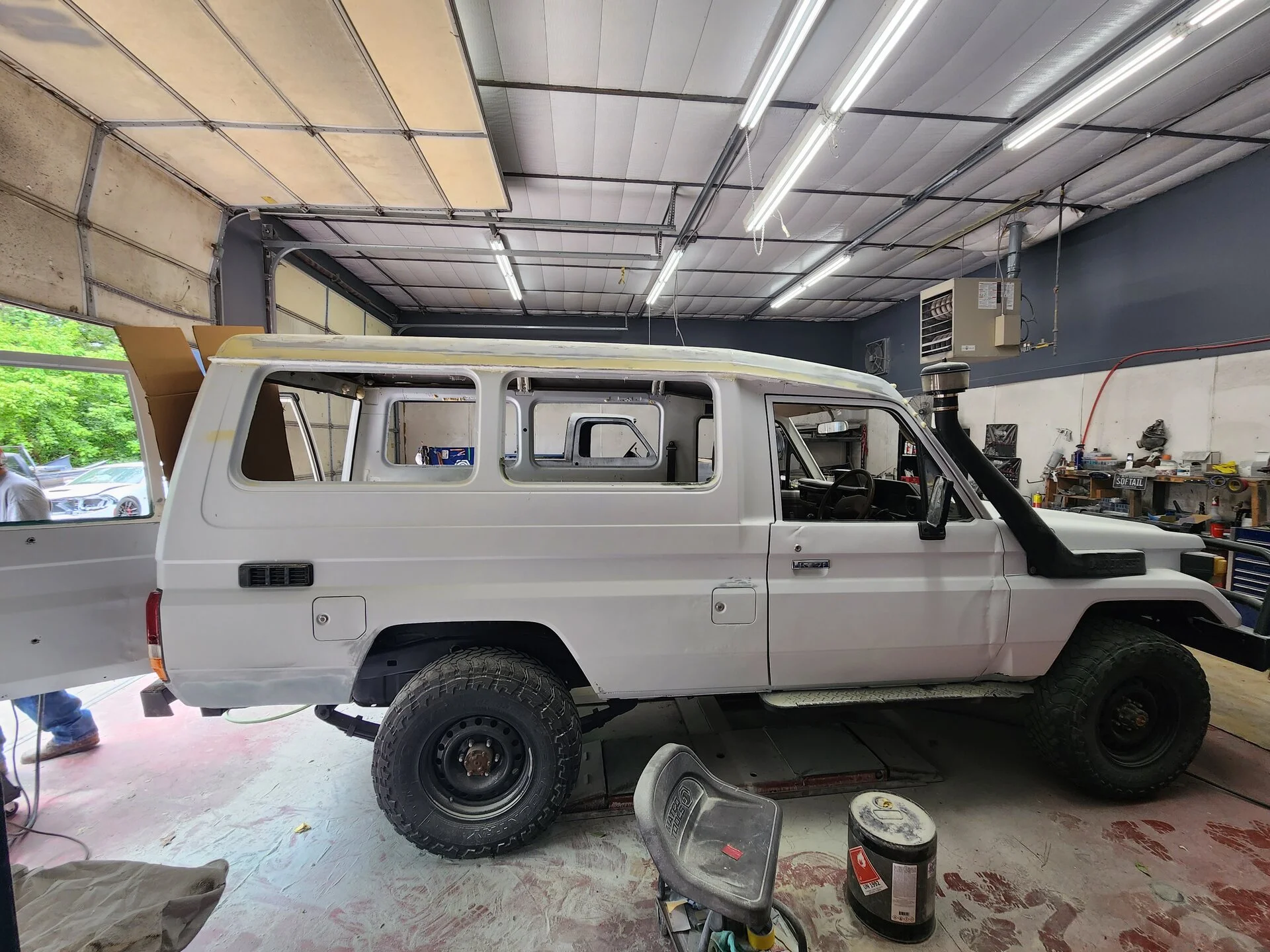

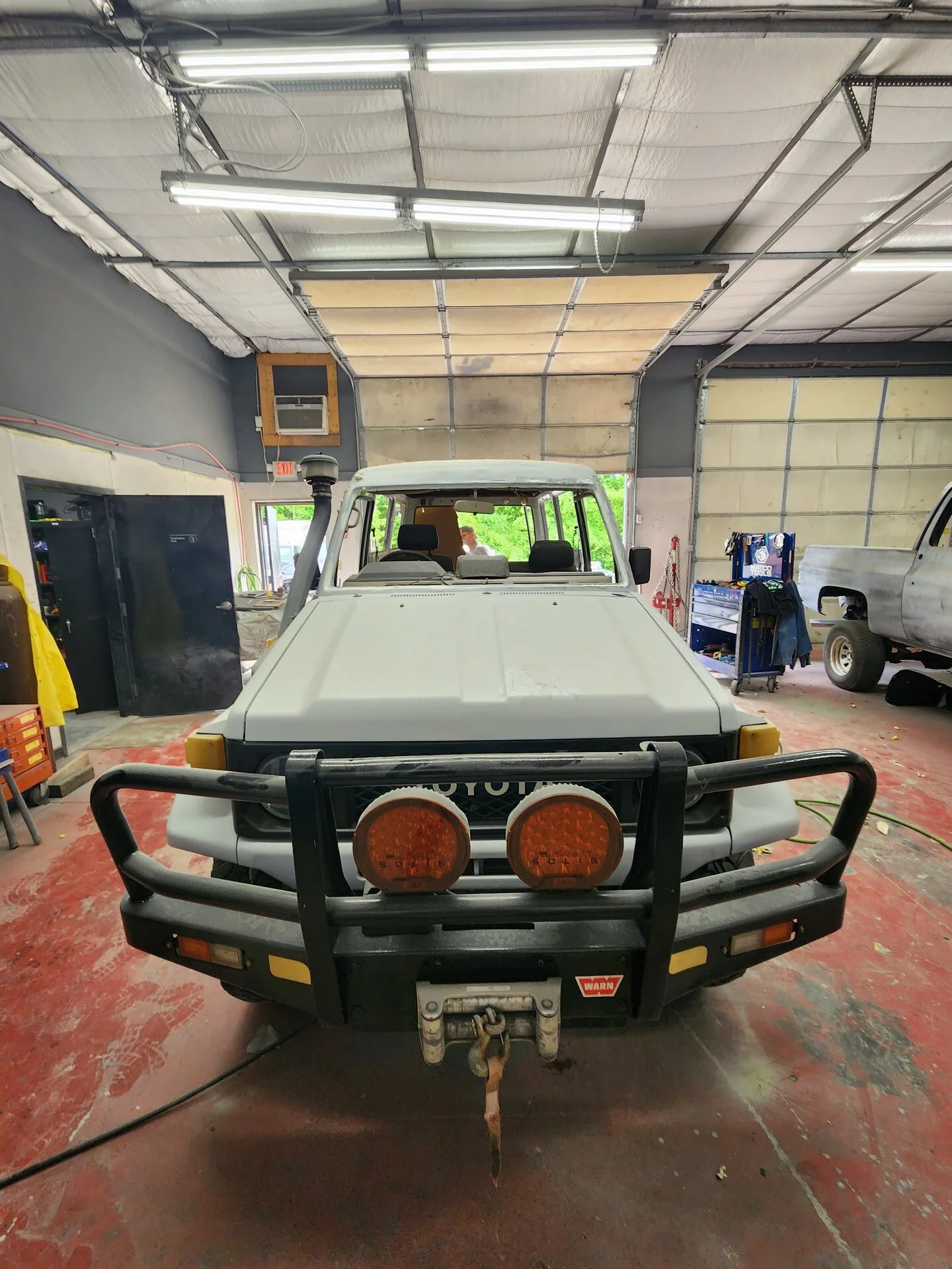

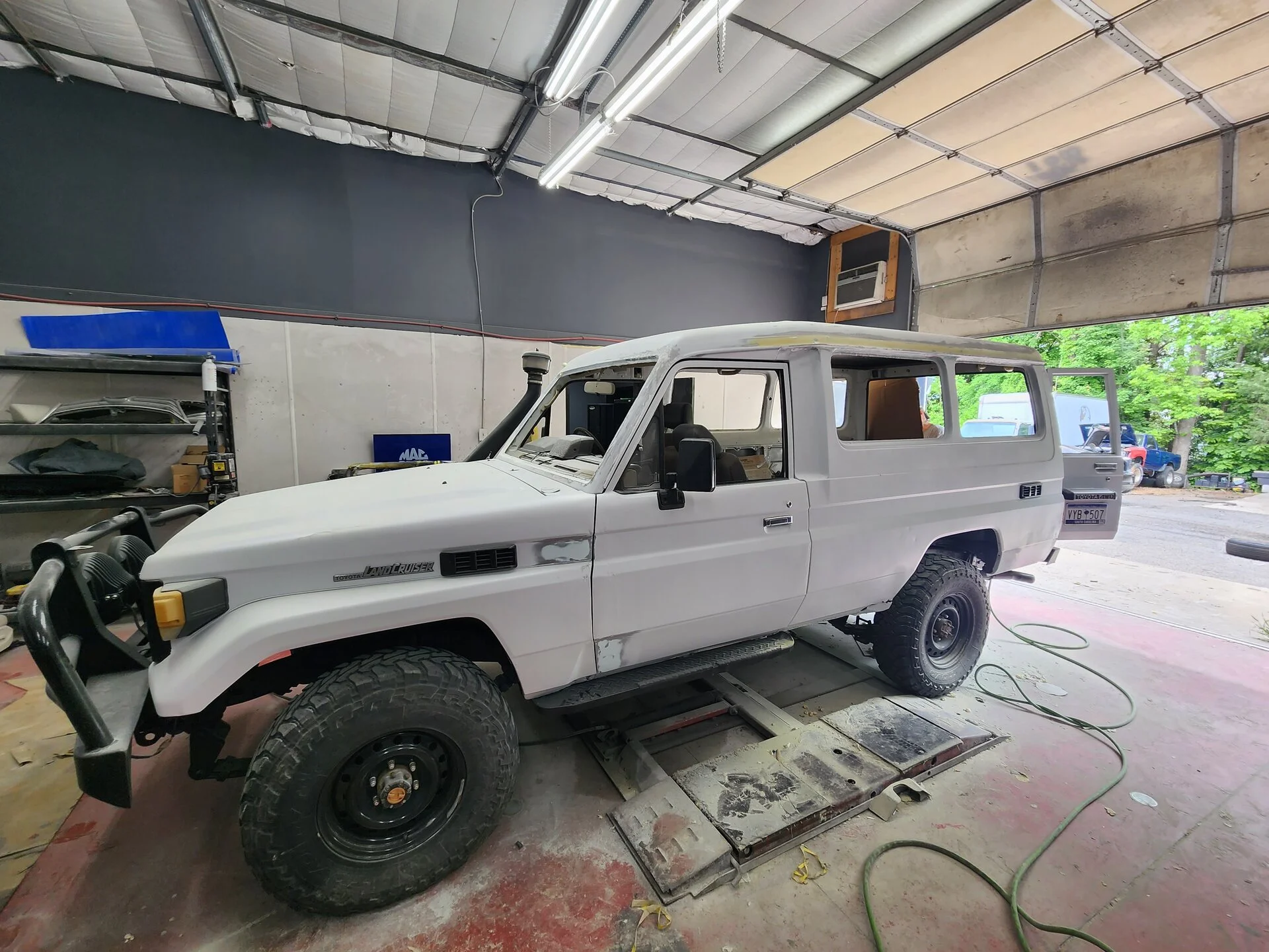

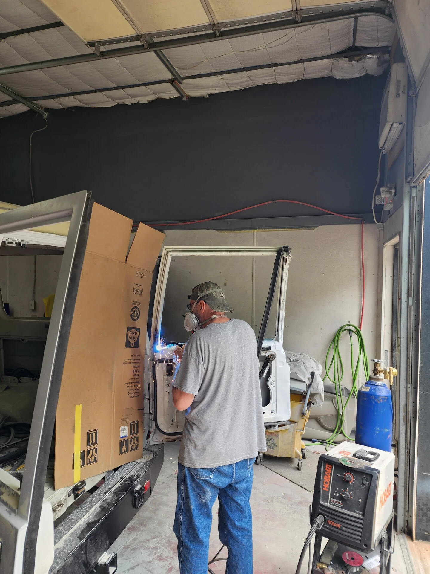

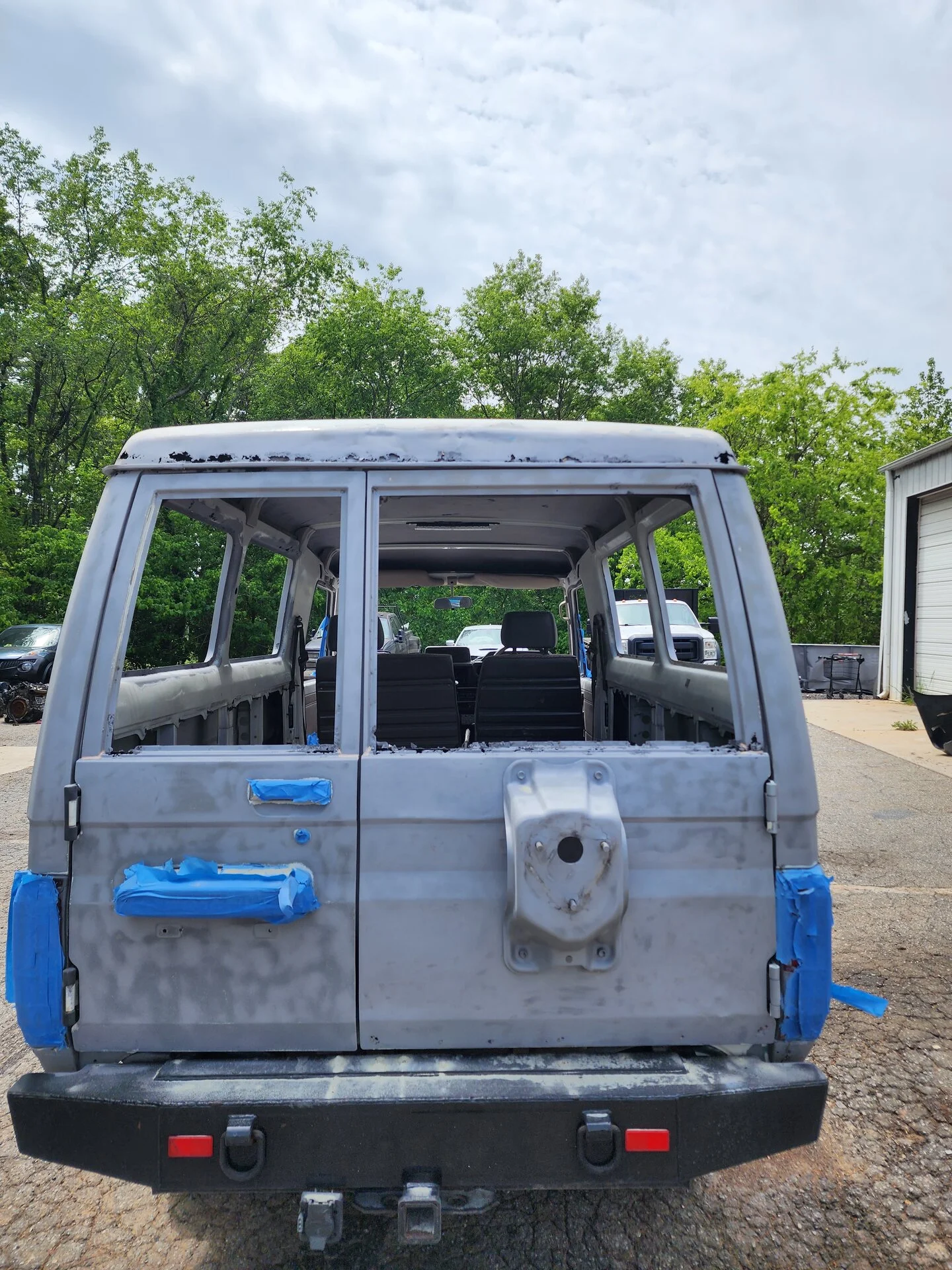

2nd week of May 2023 update. Body work made substantial progress. All the roof areas have been opened up and rid of the old bondo. Essentially all open rust areas are now patched. The window sills have been repaired and getting ready to fully epoxy the entire body. I left a lot of dents throughout until I fully figure what I want to do with this thing. We pulled so much bondo out it was insane! We used some body filler to smooth out the roof line. The gutter areas were the worst and took a lot of metal work. This Troopy isn't ready for a full resto just yet, but I'll get it on the trails before the end of June.
