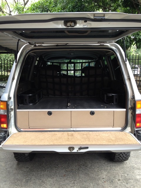

I just welded some ears/tabs to both ends of my 4x4Labs rear bumper wings.
Just buy a big square padlock like:
Good ideas. :)
No need to spend on locks for the Cargo drawers. If you can’t open the bottom half of the tailgate, drawers are not accesible. Cons: you have to open the lock and remember to put it back on every time you need to access the cargo area.
