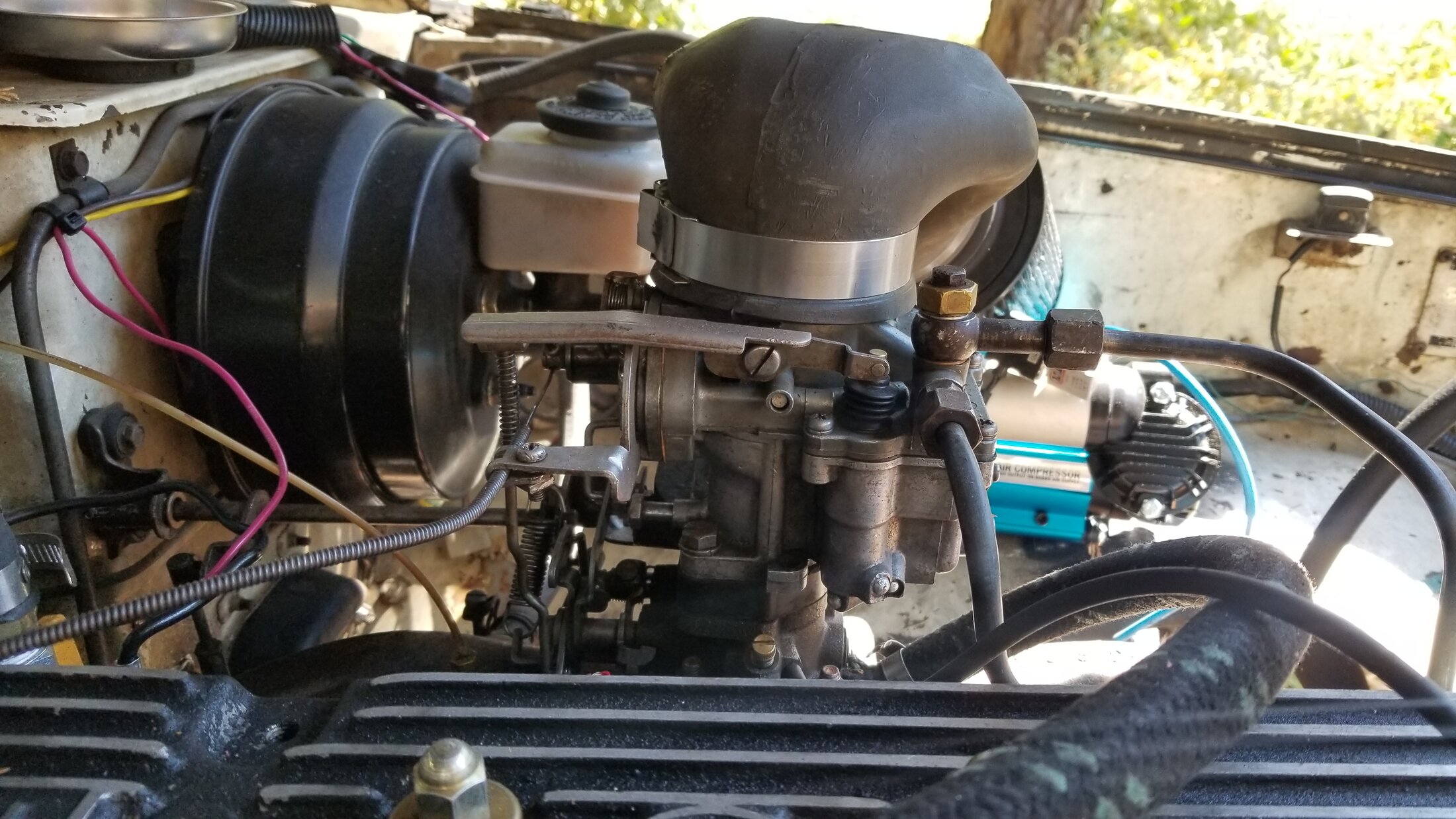

I noticed today that the line running to my Carburetor Solenoid Valve has no voltage. As a test, I hardwired it to my battery, it opens and closes and idling improved.
There are several posts (like the one below) that discuss work arounds for a failed Carburetor Solenoid Valve due to lack of voltage from the Emissions Computer.
The solution being tapping into a keyed power source and keeping the solenoid actuated (open) continuously while the engine is running.
The only drawback to this work around that I have come across is a slight decrease in mileage when decelerating. Not an issue with this old pig!

Thanks for the confirmation @65swb45.
I have an HEI Distributor (internal coil). I assume using the positive lead coming off that would accomplish the same thing?

I ran a line from the Positive side of the coil in the dash board and out the same port that the temp sensors uses to keep that wire as much out of harms way as possible.
I had thought about tapping into the ignition circuit- but - felt this was an easier way to understand my logic if someone else needed to get under the hood.
My rig has been de-smogged. I might at some point try to figure out an ignition hard wire from the smog harness - but - that’s at the bottom of my list of things to do at this point. .
