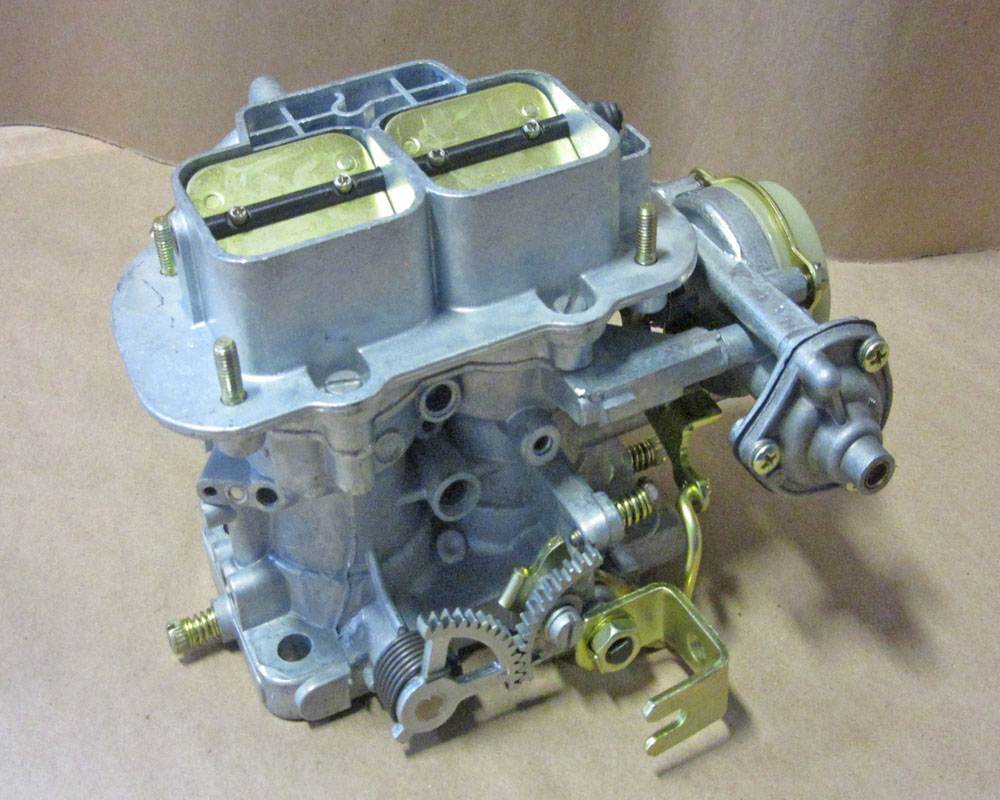

I am trying to find a carburetor adapter plate that fits onto a 1f motor - to either a Weber 38 or an Aisin 2 barrel. Can someone please shed some light on this. Seems like when Toyota went to the 2f motor they made the intake about 6mm larger in both directions. Is red line the only option for an adapter plate? My project had a Holley 4412 on it, I have the adapter plate for it. Is there a different carb I should be looking at. I have read a lot of posts, a lot of people say to stay with the Aisin others say they have had good luck with the Weber. I simple want something that will start all the time - the Holley won’t give me that, can’t seem to get the low speed idle down without the carb dumping fuel in.

Man-A-Fre still sells the kit with the Weber and adapter plate (along with some other stuff). I have this on my '70 FJ-40 (1F) and it has worked great for many years.
