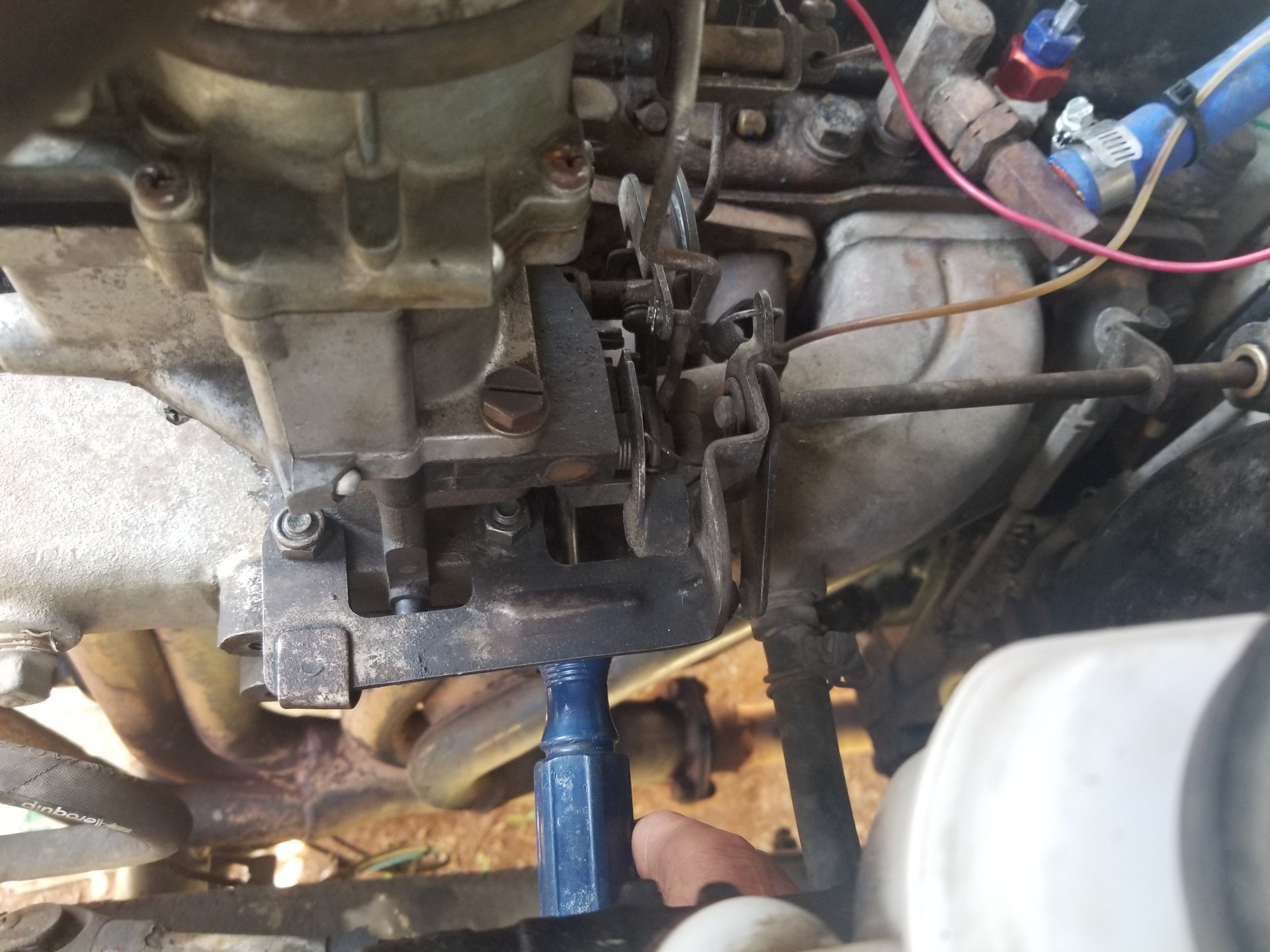

If you've completed a rebuild kit you should know where your idle speed screw is. Here's mine.
As Pin_Head said, you can't see it. I feel around for it. I know where it is 'cause I've completed a rebuild kit or two.
ya, no i know which one your talking about and where it is i was just not sure if to mess with the low end idle i should mess with which screw: TP, Fast idle, or throttle...so i have my answer: fast idle screw (idle speed screw)
