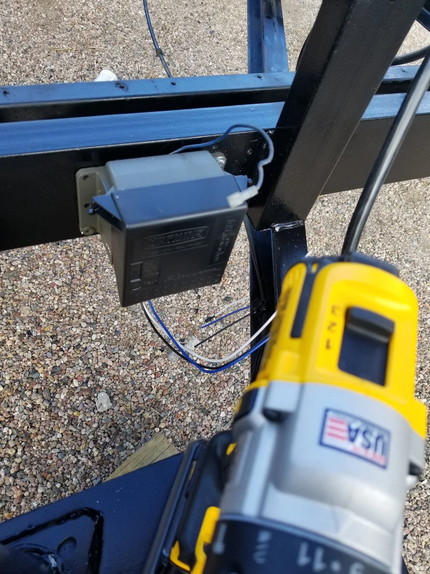

i've started stockpiling some parts to completely rewire the trailer with a new breakaway battery, all new led lights, extra lights added to the outer edges of the fenders so i can see them when i'm backing it up in the dark (which apparently happens a lot more than i'd like), a new winch to make putting dead rigs on much easier, new deck and some rattle can and conspicuity tape to make it a bit more obvious. plus, i'll have to massage the right fender out (the jeep did a number when it went up onto it), cut off the lights and brackets that jerry fixed (and the jeep bent again), make a new bar to keep the ramps in place, and create some sort of storage for straps, chains and binders.

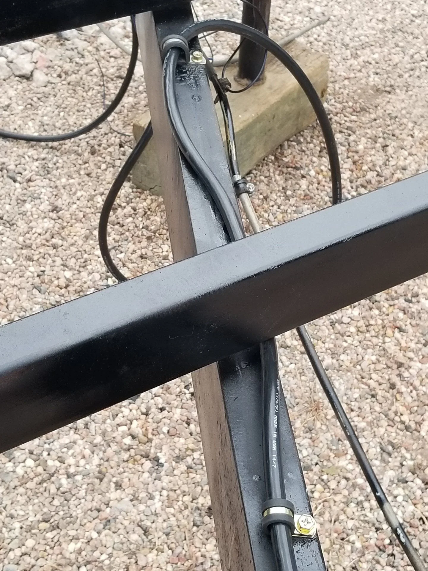

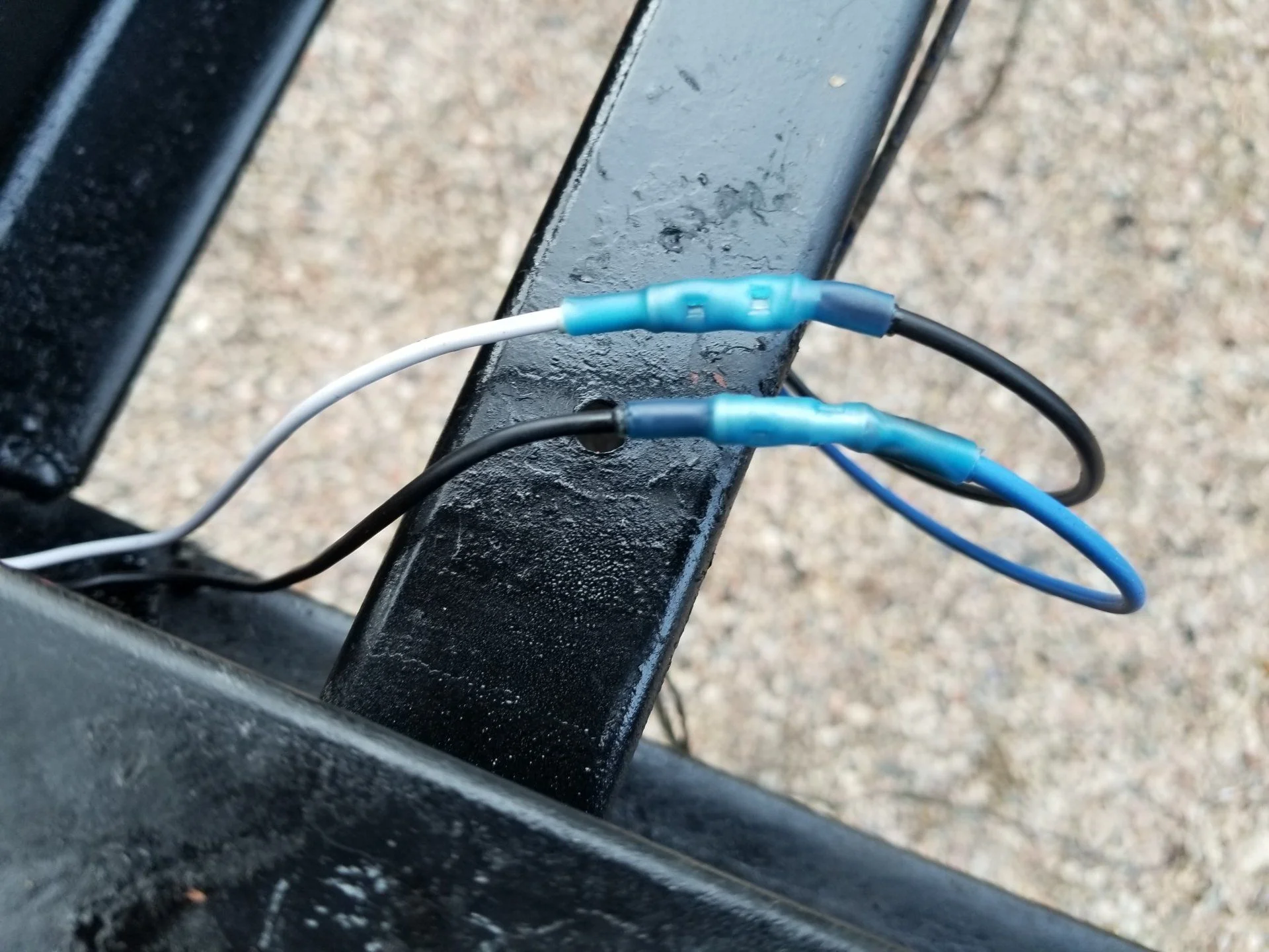

i plan on running the wiring into a junction box because i've found too many friends trailers where the green corrosion working it's way down the wiring and i'm hoping to stave it off from the rest of the harness. i also have a lot of heat shrinkable/glue butt connectors so i can throw away those dam scotchlocks. and ill top everything off with greasing up the hubs since they've gotten a workout.

Be sure to check out the suspension. Especially the shackles, equalizers, bushing, u bolts, brakes and bolts. I rebuilt my really old trailer and found most were shot and or ready to fail. I found E -trailer had everything I needed cheap. Throw the scotchlocks away. They create more problems than repairing anything.
Messing with trailer light wiring over the years has taught me to always, always, always run a ground wire to each light and reject those lights that don't have a dedicated ground wire. Wire it as if the whole trailer is fiberglass, create a complete ground wire system & do not trust the trailer frame to be the ground. I do run a wire from the ground buss to the trailer frame, but I do not use the frame to conduct ground.

My experience has been that grounds are almost always the cause of trailer lights not working right. Usually because the ground for one light has failed for whatever reason and that causes all sorts of weirdness. By bussing all of the grounds together they stay sealed (I use those adhesive lined H-S butt connectors for all of the ground connections) and aren't subject to corrosion or fatigue decaying the grounding.
I've implied it, but haven't said it explicitly so I'll say it just in case. I first run the grounding wire clear to the trailer light connector without connecting it to the trailer frame anywhere. I then splice in another branch of the grounding wire and connect that to the trailer frame. I usually do this at the tongue somewhere.

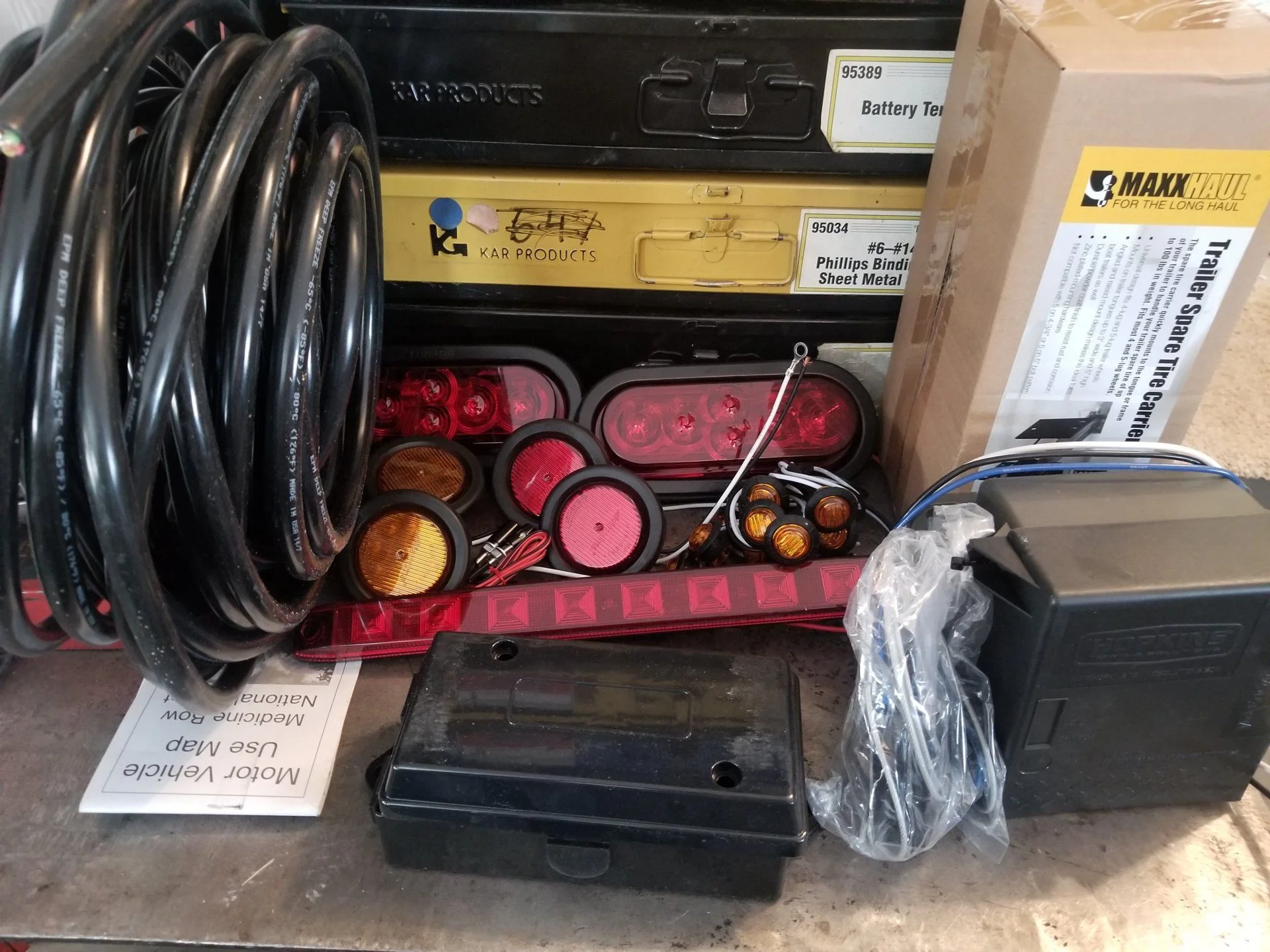

i'm one of those weird chicks that gets turned on by car parts for Christmas. i actually got new dewalt driver kit and money, but i used the money to go shopping. in this pic is the wiring, all the lights, the new breakaway setup and tire carrier. the spare tire is ordered and i picked up a 9k badland winch that's not pictured.
still need to pick up the phosphoric acid and order the rest of the deck as i only got three pieces to band aid it together. i'll order seven more pieces. i still haven't figured out what i'm going to do about the one board that's half width. (10 boards measuring 7.5", one board measuring 4.5") also i need to grab a new plug and from work and the new deck screws are on an order that hasn't shown up from our trailer supply vendor.

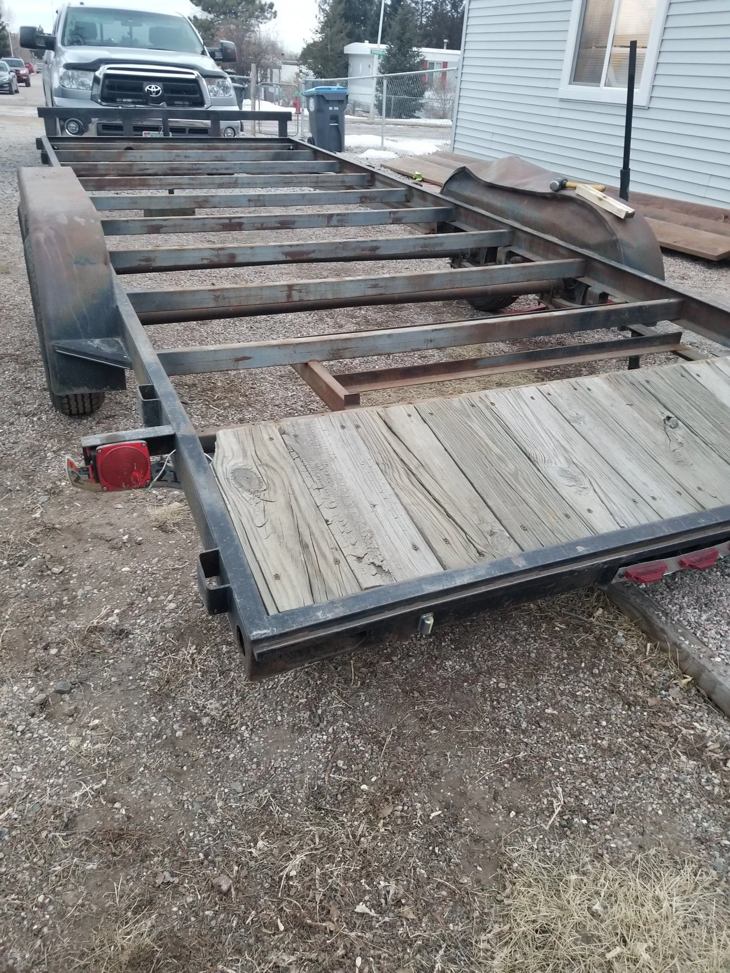

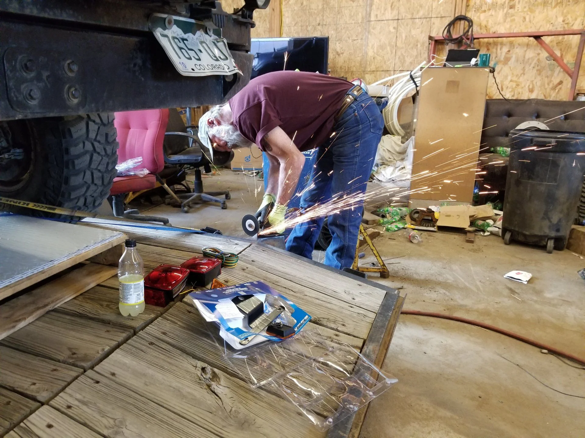

tonight, i stripped off all the wood, stripped the lights, and started pounding out a fender folded by a fullsize with no steering.
plan for tomorrow is more fender pounding and spray the ospho. maybe get the drums pulled and inspect/clean brakes and grease everything.

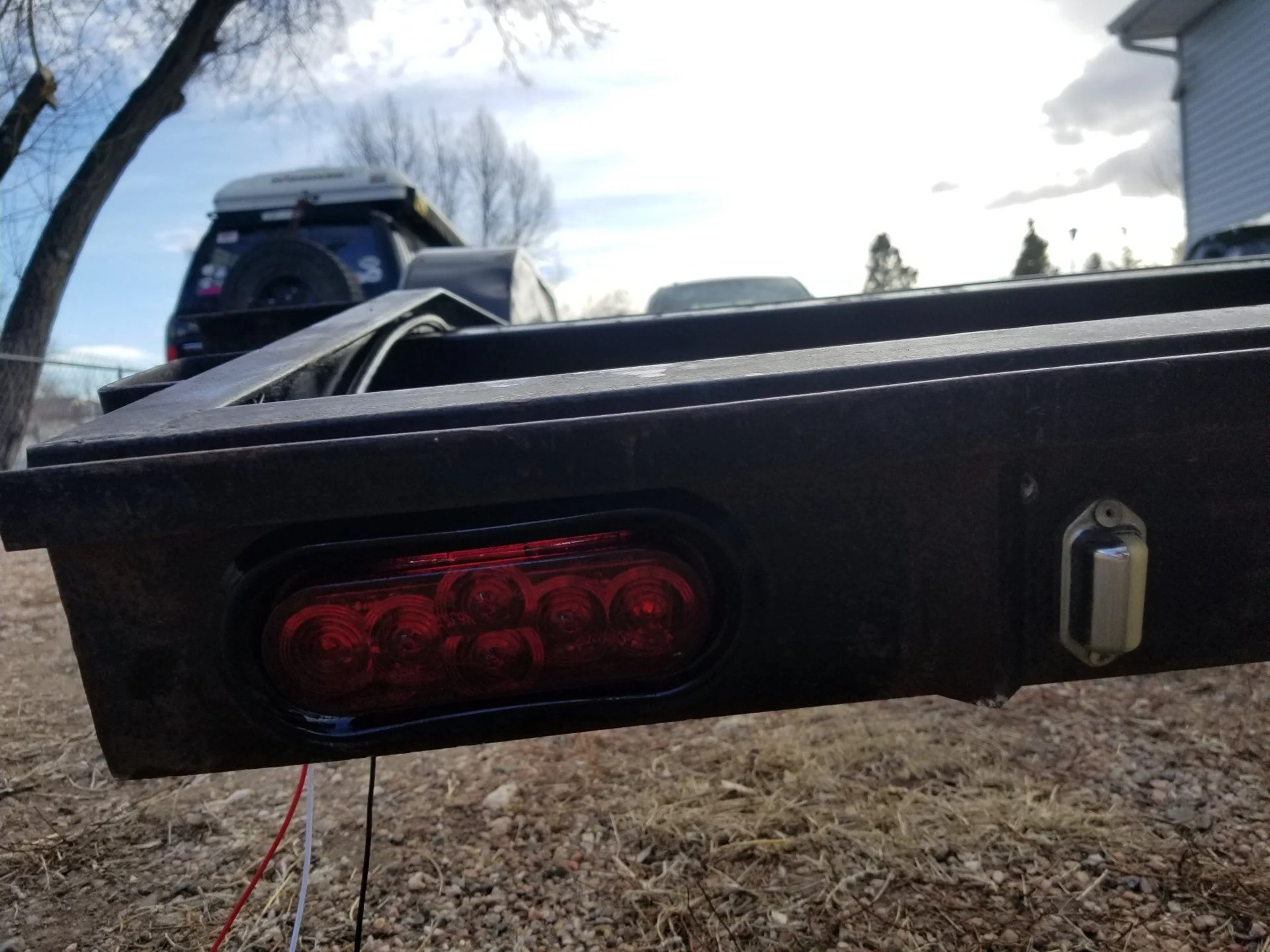

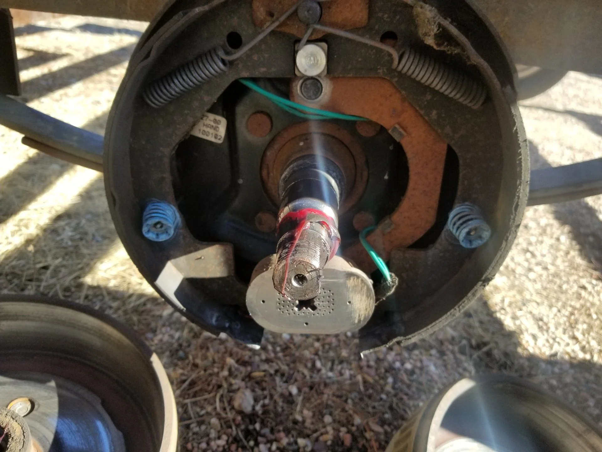

got up last saturday and took a block of wood, the floorjack and a bfh to the right fender and beat it somewhat into submission, then stripped all the old lights, cleaned up the rh brakes and drums, added a bit of grease as they really didn't have a lot, and sprayed the frame with ospho. the ospho takes a while to dry, so i was done with that project for the day, but sunday was five cans of sos black paint, mounting up the new breakaway switch and battery, relocating the license plate, installing lights (led baby, led), running new 7 way wiring, and started wiring the lights into the 7way.

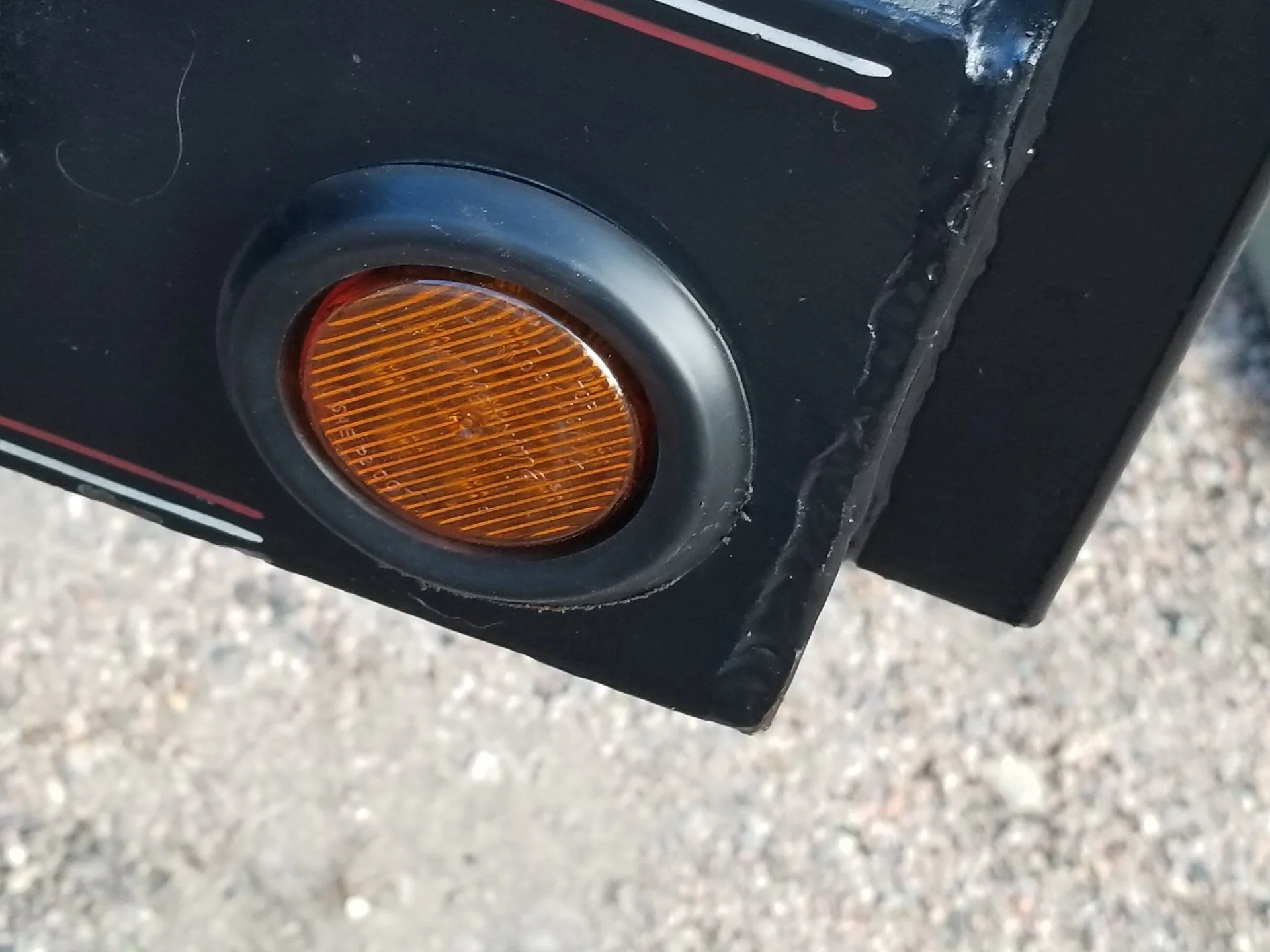

i still need to get the rear middle light in (have to drill holes and that dang frame is not pleasant to drill through) and add the four fender lights (but the fenders are hard enough that i didn't even get one hole drilled before it destroyed my holesaw :O )

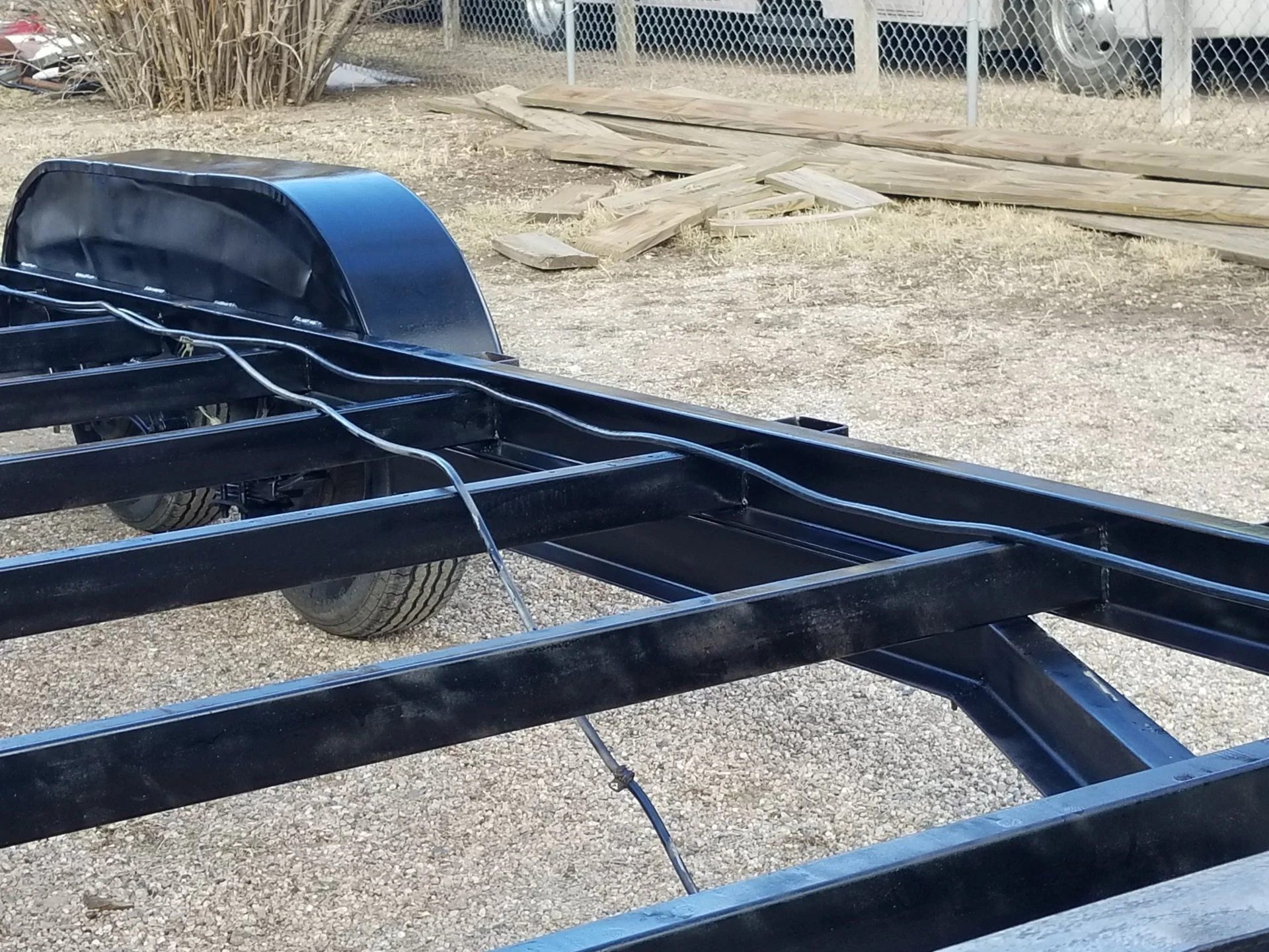

proof that i don't know how to work on trailers....i used heat shrinkable butt connectors with glue instead of scotchloks ;)

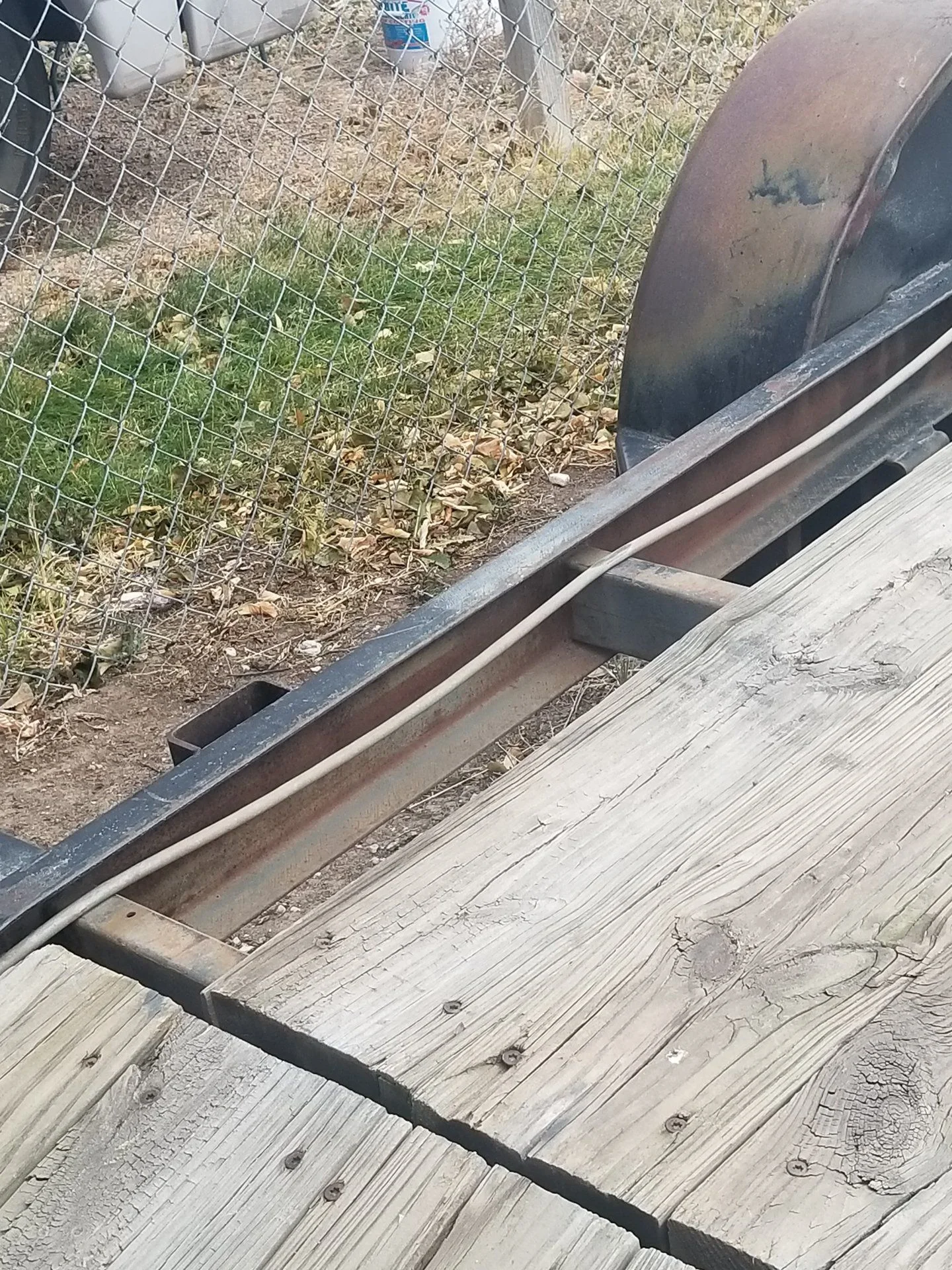

surprised the front lights worked (they actually were the ones that i had the least issues with) considering almost all of the insulation was missing. fortunately, it appears mice had nested in the frame in the past so their bedding must've kept the bare wire from contacting metal
hope i don't wipe out the license plate lights, but the plate got bent a few times just going in and out of the shop parking lot, so moving it up higher was a requirement.

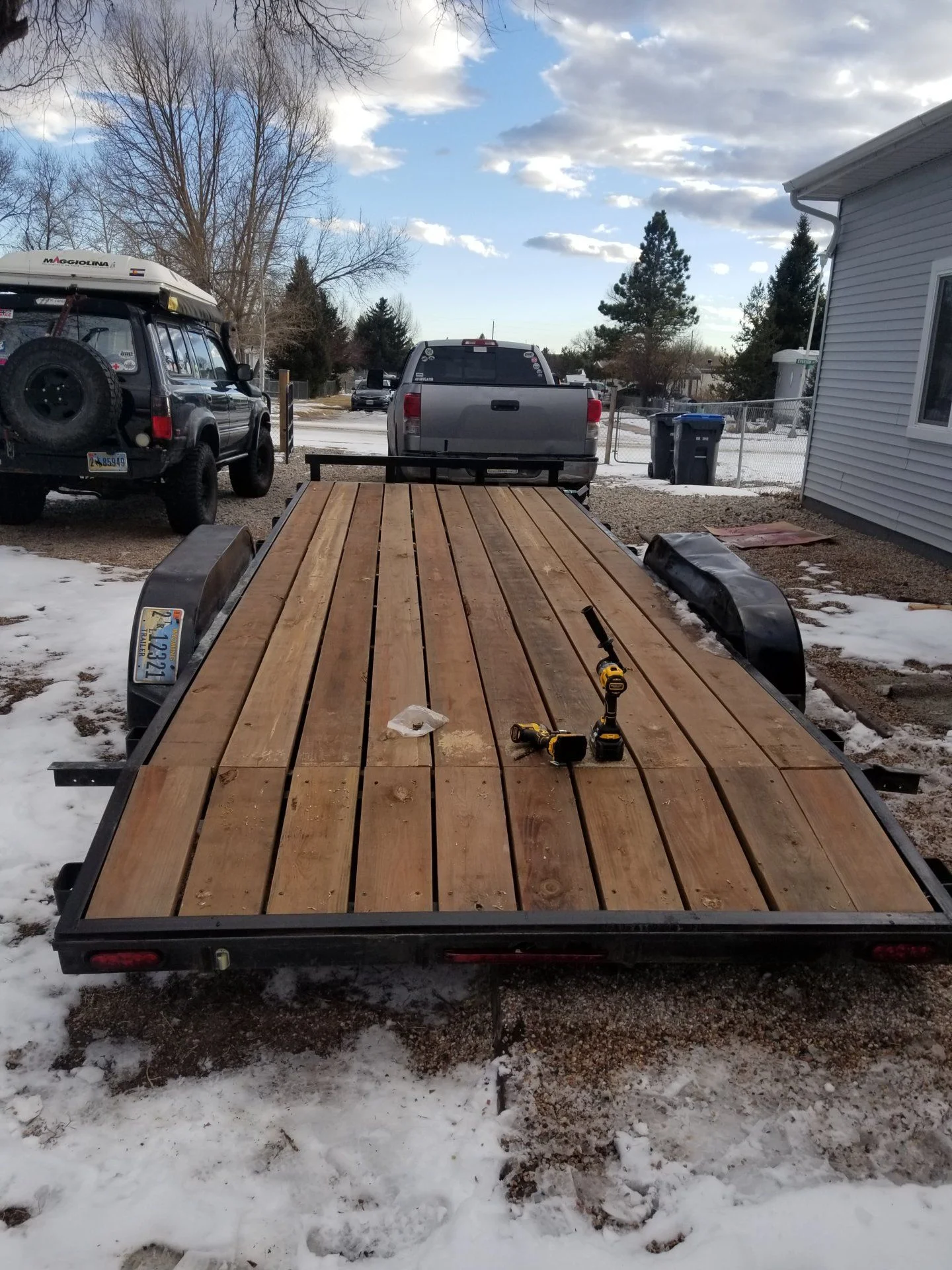

was really nice to plug it into the truck and have everything working, and have lights in the fender fronts so i could see them backing it up the drive in the dark
things i learned/didnt think about. didnt need seven way wire, only six, since i don't have power going to the trailer. the junction box i put under the front of the frame was just a tad too tall and broke. i could've notched the boards there to clear, but i'd rather not. i'll get another box at some point and move it to the front of the frame vs underneath
the tire carrier is normal on the side, but blocks the fender light so i'm going to move it up front.
no one can cut a straight board :(
ospho really should have more than 24 hours to dry, even if it is windy. it was bleeding through the paint a few days later
good luck finding a 15x5 modular white wheel....even when you find one, get the tire mounted, it will turn out to be 15x4.5
this was two days after i got the deck on ...blizzard in denver was bad enough i had to stay down there. but everything on the trailer worked great (except for the fender lights in the front of the trailer that you couldn't see because they were packed with snow) ;)
