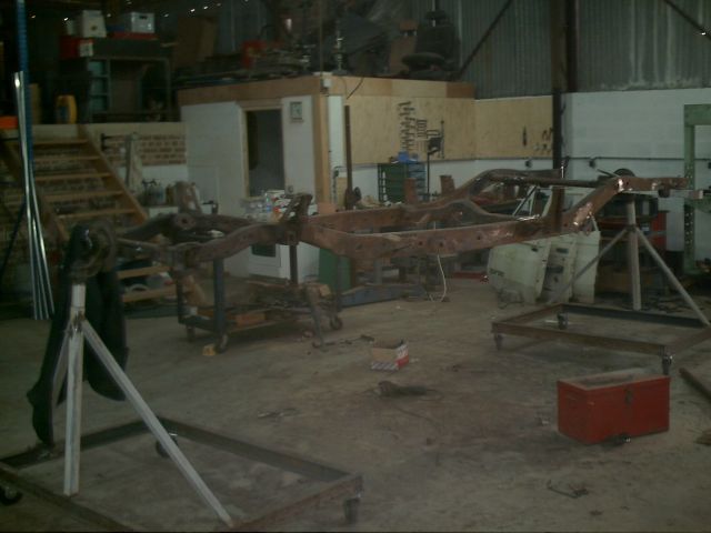

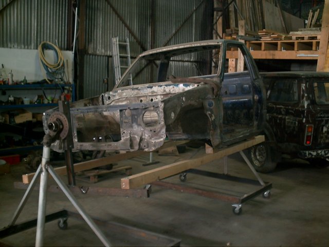

mine made mostly from misc. scrap I had laying around. and some hubs from a mcpherson fwd car
Denis- now all you need is the calipers to lock it into position. Way cool.:cool:
To shave some weight I drilled the discs and use a "D" style quick release pin -or whatever you call them- through a caliper hole and the disc for locking in position :D
The CV joints are also gutted and cross drilled to fit a removable lever for rotating the hole thing. I'll try to find a better pic but you get the idea.
