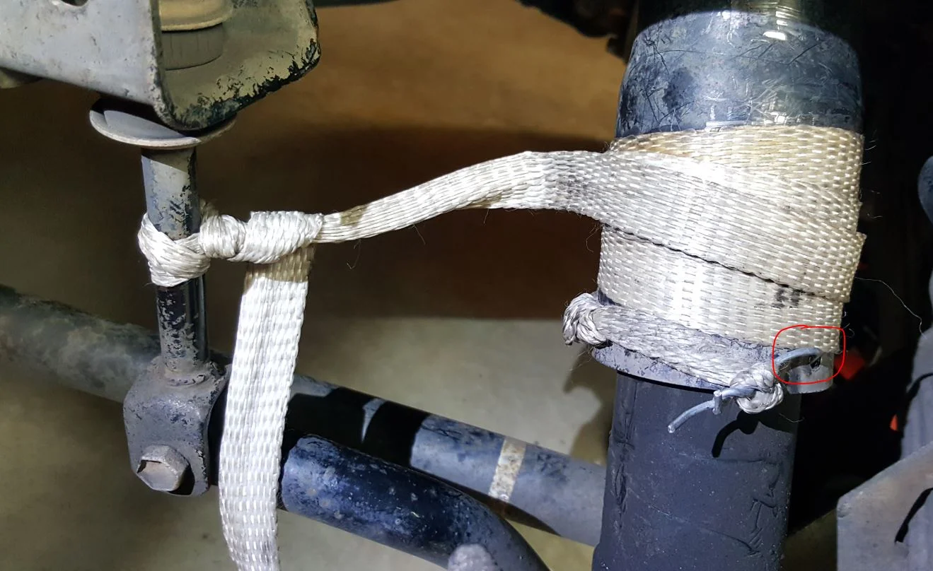

I just did my rear suspension and I found a new trick: Support the rear axle, put a vice grip on the top nut, release the bottom of the shock first and slip a strap-type oil filter wrench on there with a long breaker bar and you can crank that shock as hard as you want. Worked good for me! :beer:

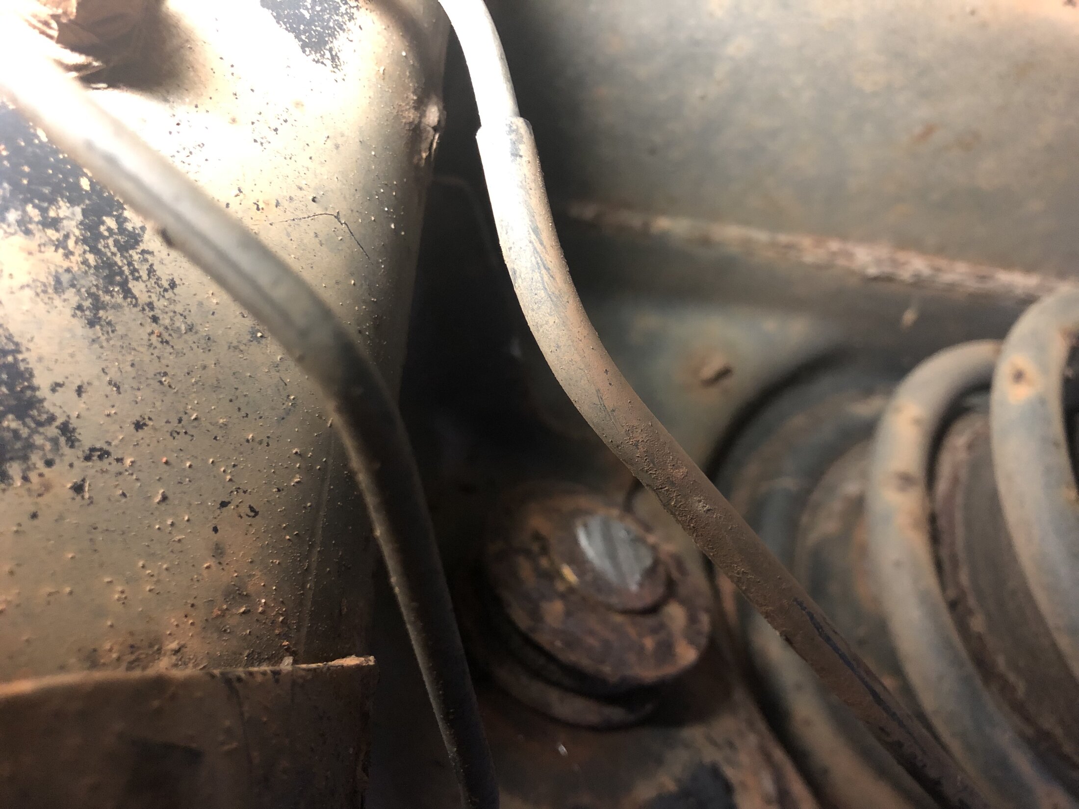

So, I have made some good progress on my 2000 Land Cruiser. I'm to the stage now where I'm installing the OME lift but, the rear shocks are being a pain.
The top nut that holds the shock to the frame is just now wanting to come off. I have soaked it with Liquid Wrench and it still won't budge. The worst part is, you can't see it when you are turning it. It's the shock on he passenger rear by the exhaust.
If someone has a tip for removing it I would appreciate it. And yes, if I could cut it off I would.

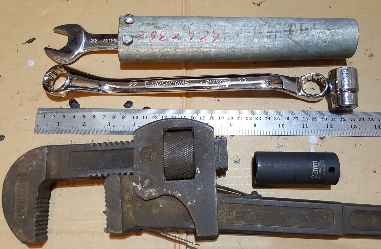

What did not work:
Sockets - the regular is too shallow. The impact Sidchrome is too tall to get there.
Sirchrome box-end wrench - too long to fit at a correct angle.
Sirchrome open end wrench - too short to exert enough force and the extender won't allow it to fit;
Monkey wrench to hold the shock from spinning - the shock's shell is too soft for a proper grip. Besides, it is problemmatic for a one man gang to operate both wrenches.
What worked:
Old as the world technique to hold large force of shock spinning with friction created by multiple turns of a rope.
Shorter box-end wrench with an extender.

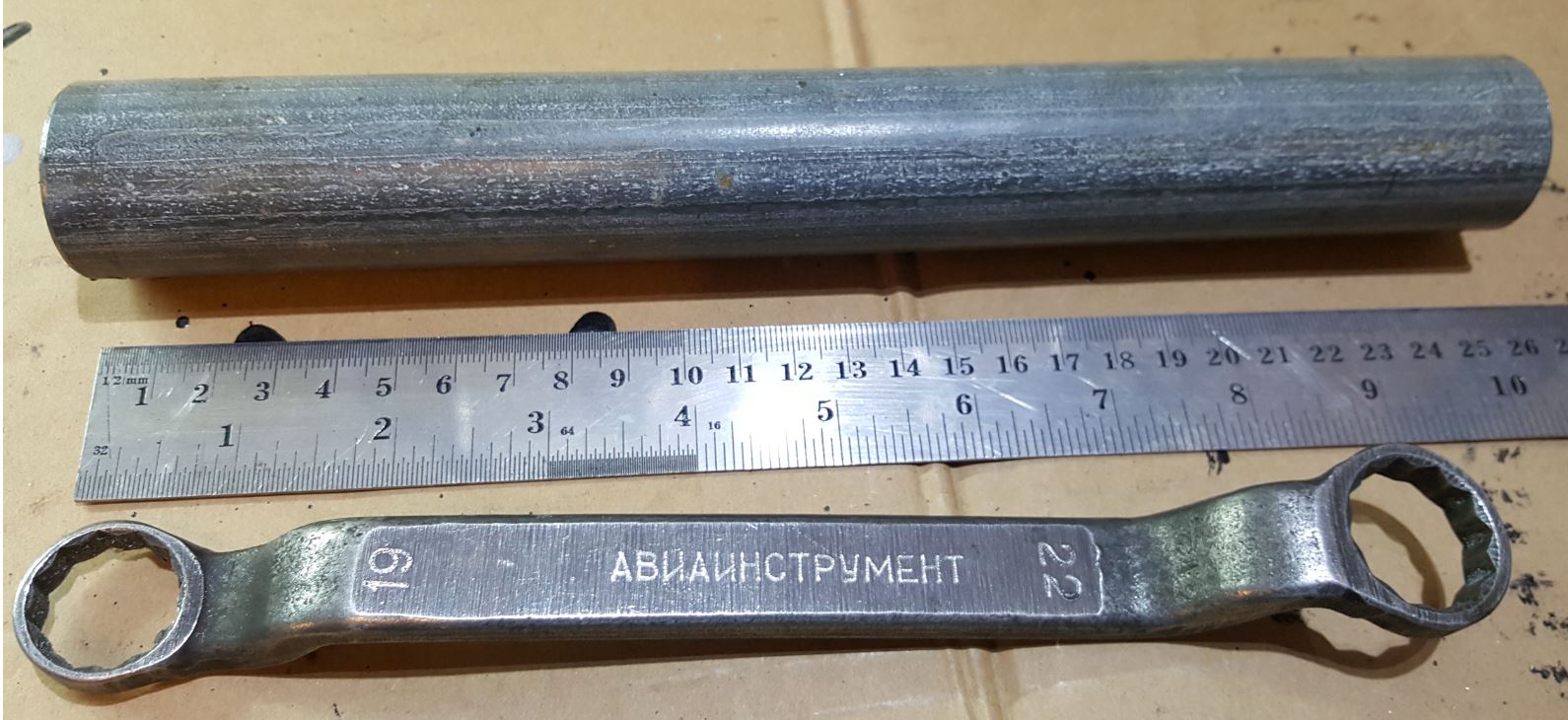

UPDATE:
Was trying to undo another shock with another rope and found it too stretchy to break the top nut on the shock. Used 2.5mm wire instead and that made all the difference. I am sure even 2mm wire would do.
I liked the strap tied to the sway bar link. My strong suggestion after putting in my Koni's is do not attempt without gear wrenchs 7/8 for removal 15/16 for Koni raid install. I used an 8mm allen held with an 8mm box and the 15/16 gear wrench for the install. Oh, and drop the spare first.

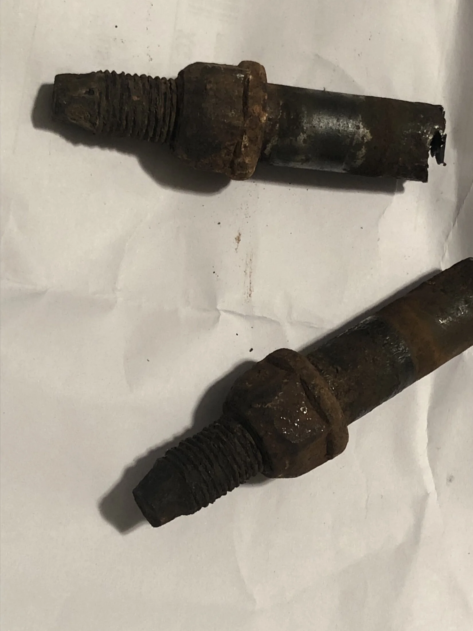

I’m working on this now, myself. I gave up on trying to ratchet the nut off from the top. I used a reciprocating saw to cut the stem. This left me with a section that couldn’t pass through the retainers. So then used an angle grinder to cut the lower most cushion retainer (new one on order). Pulled out the old cushion in this section and the cut the stem again so that it could pass through the remaining retainer and frame mount. Pulled out the upper section with ease.
These nuts were not going to come off easily :)
