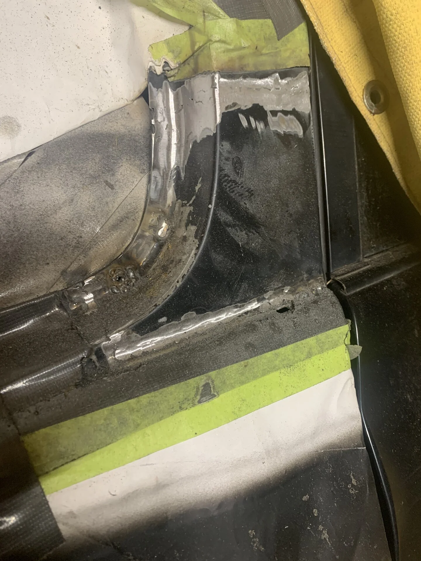

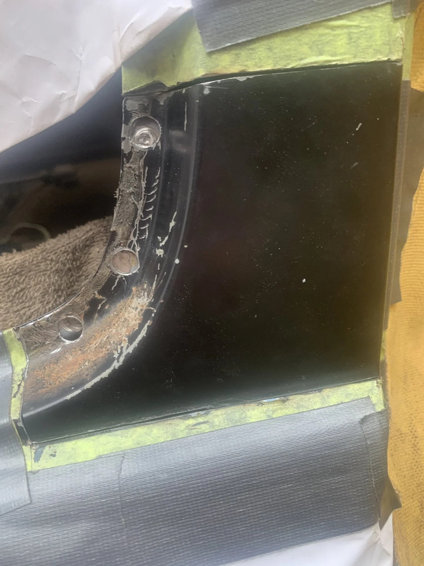

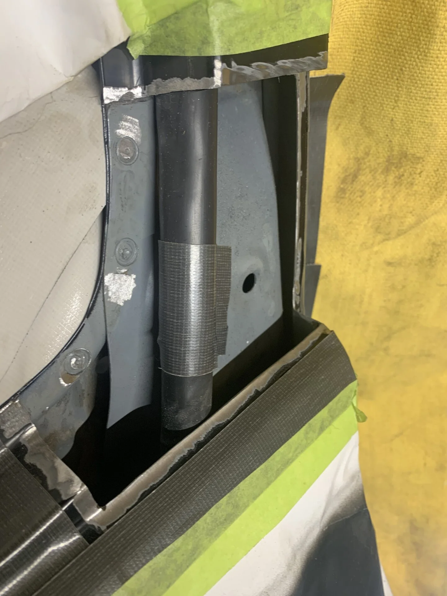

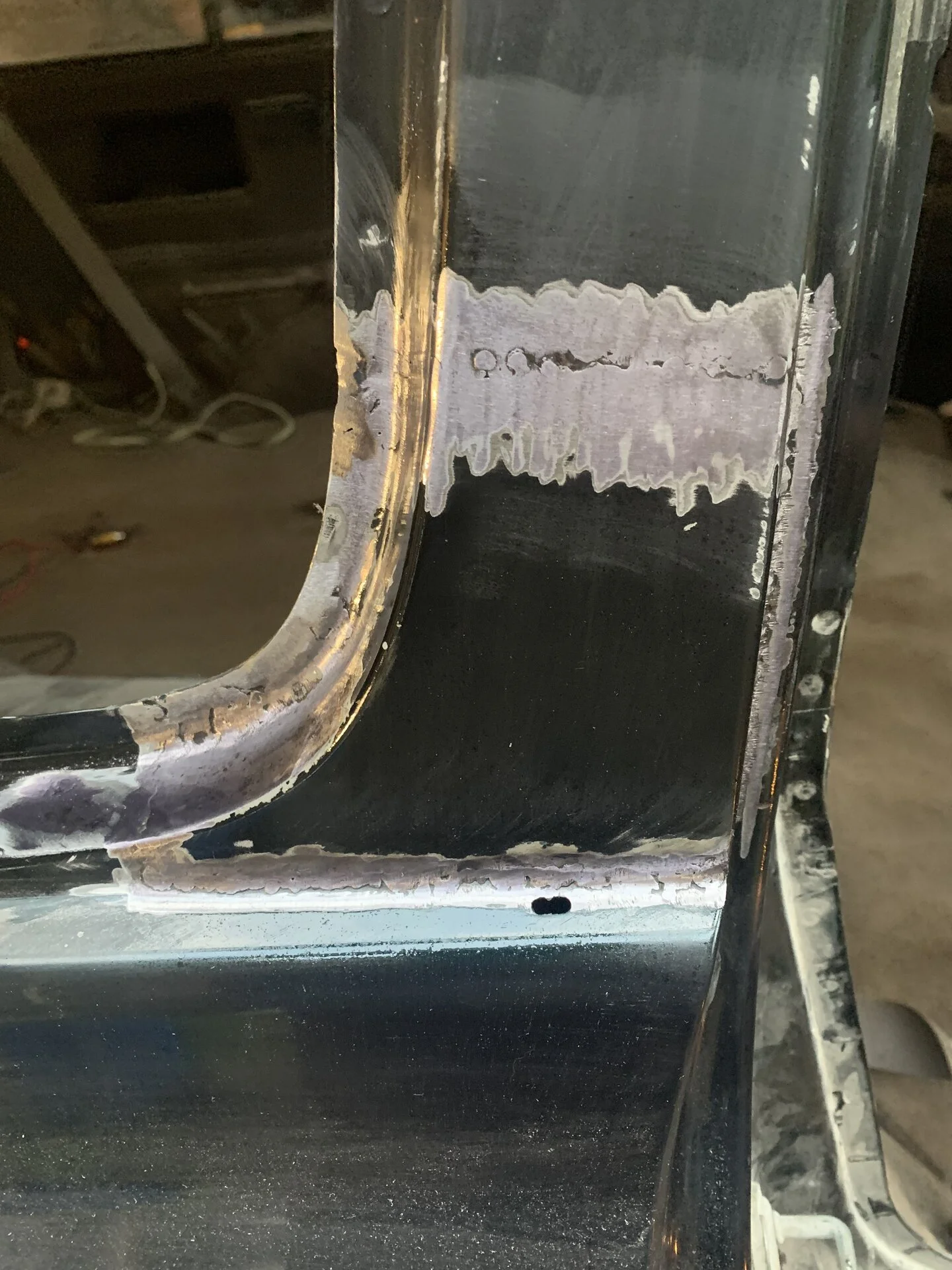

Think it is trimmed enough. I think it is a little warped from being spot welded to the other structures. Will have to be careful when tacking it into position to maintain surface uniformity at all joints. Have to run done errands now, so will be after lunch when I get back to it. Might rain as well. D’oh.
First round of tack welds done. Something strange happened to the lower spot weld hole.

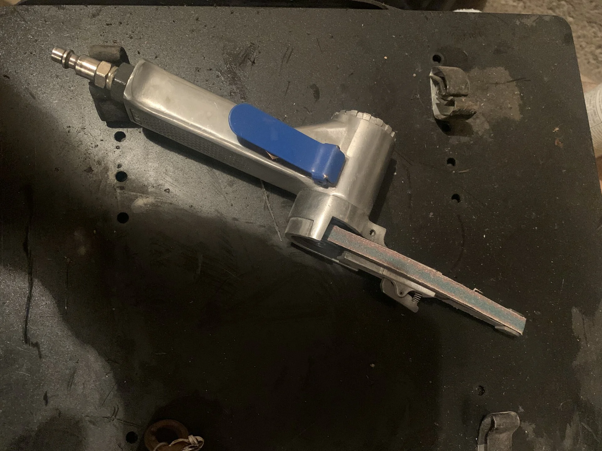

Was sanding down the welds with my mini-air belt sander and I think the electric motor for my air compressor crapped out. Damn! Will have to look into that tomorrow. Looking good though. That tool was one of the best purchases this past year.

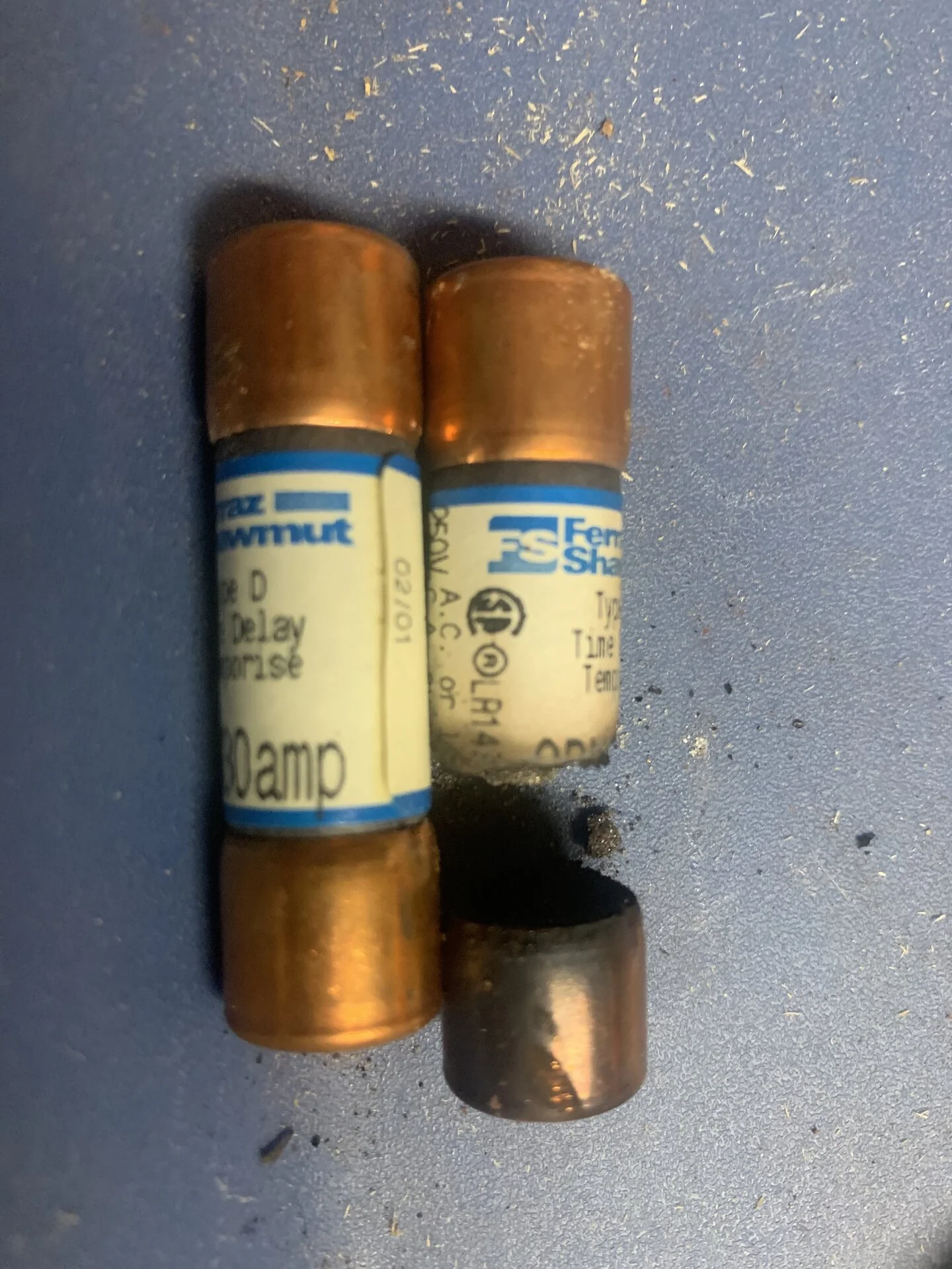

Turns out the motor was fine. Had it checked at a shop in town where they tested it, and it ran fine. Told me to check the wires between the panel and comp. So, I did when I got back home, and traced the wires back to a switch box that contained some cartridge type fuses. One of the fuses was blown. I had completely forgotten about that box which I had installed. It was hidden by a plastic sheet hanging down from a shelf I built above the electrical panels. I dug up my orig receipt. Purchased the comp at Costco on 26 Sept, 2001. Paid CAN$804 incl taxes. I think the Baldor motor along today would be around US$500. The shop says it was a quality motor. Had to go back into town to find the correct fuses. Ended up going to three places before I found them at a speciality electrical store.

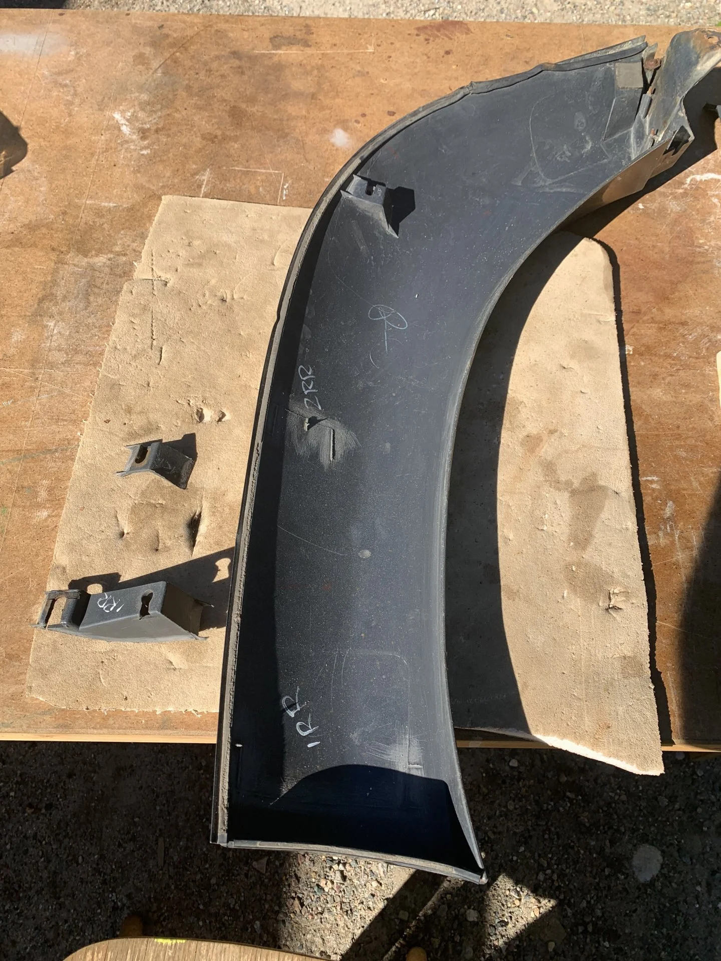

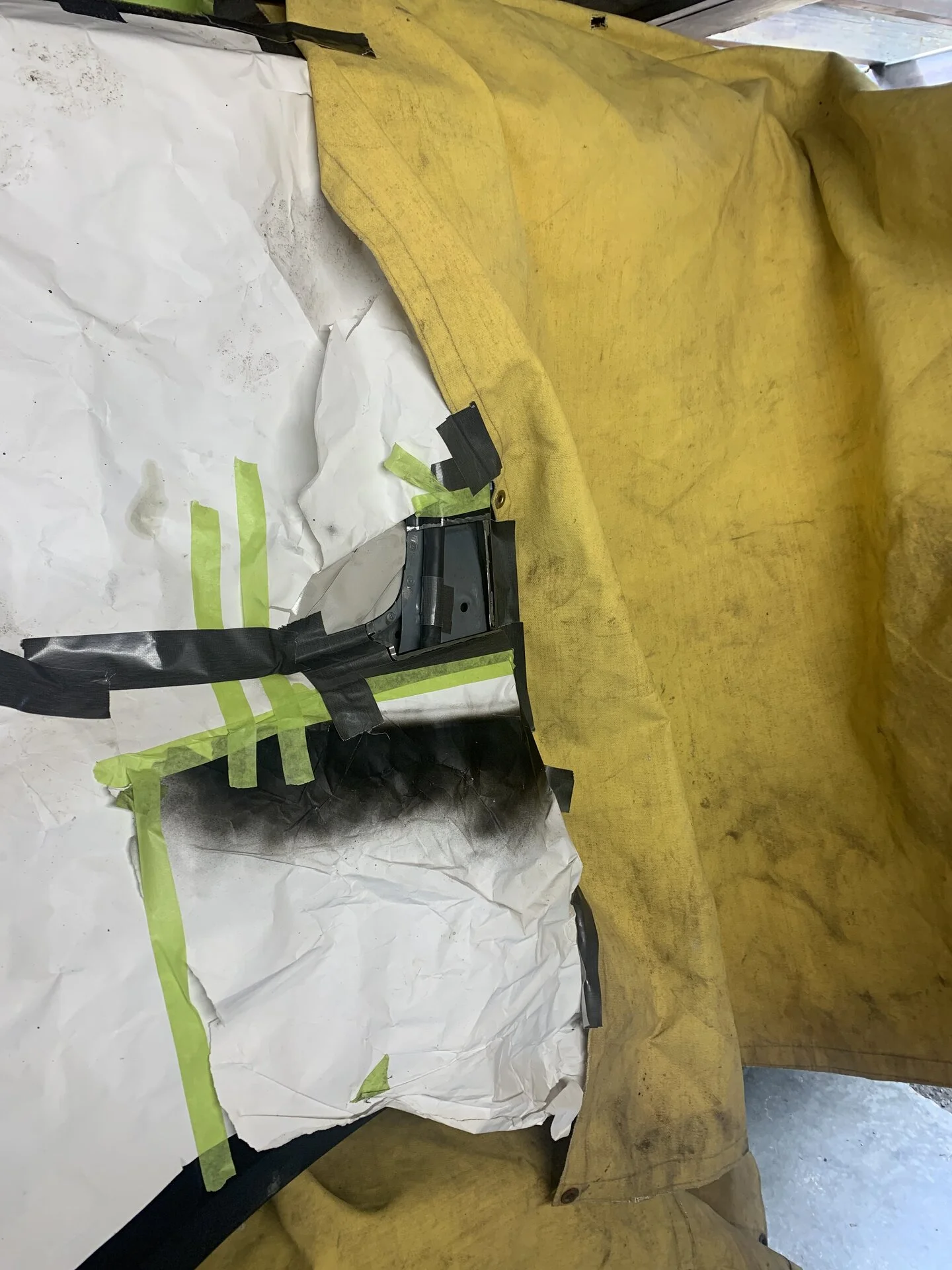

Working on the PS rear flare which got ripped off years ago. Also doing the same for the DS front flare. Warm enough today in the sun to paint the bottom of the LRA fuel tank. More pitted than I remember. Has me a little concerned.

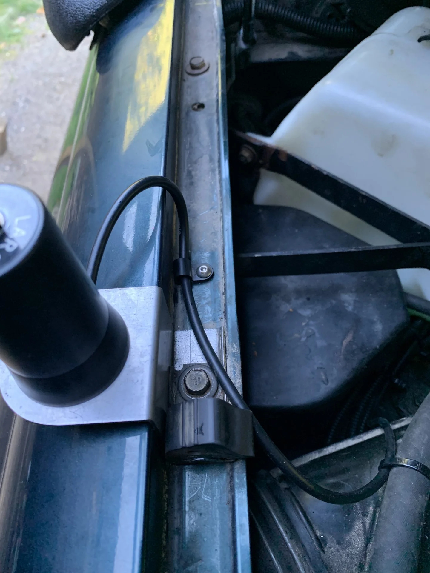

Ext speaker for Yaesu unit. Hot glued it in place, but it later fell down. Just going to screw it to the dash even though I don’t really want to. Tried Velcro as well, but it is too floppy.
Antenna cable tied down with P-clip.
PS Rear Fender flare repair. Used tried and tested JB Weld.

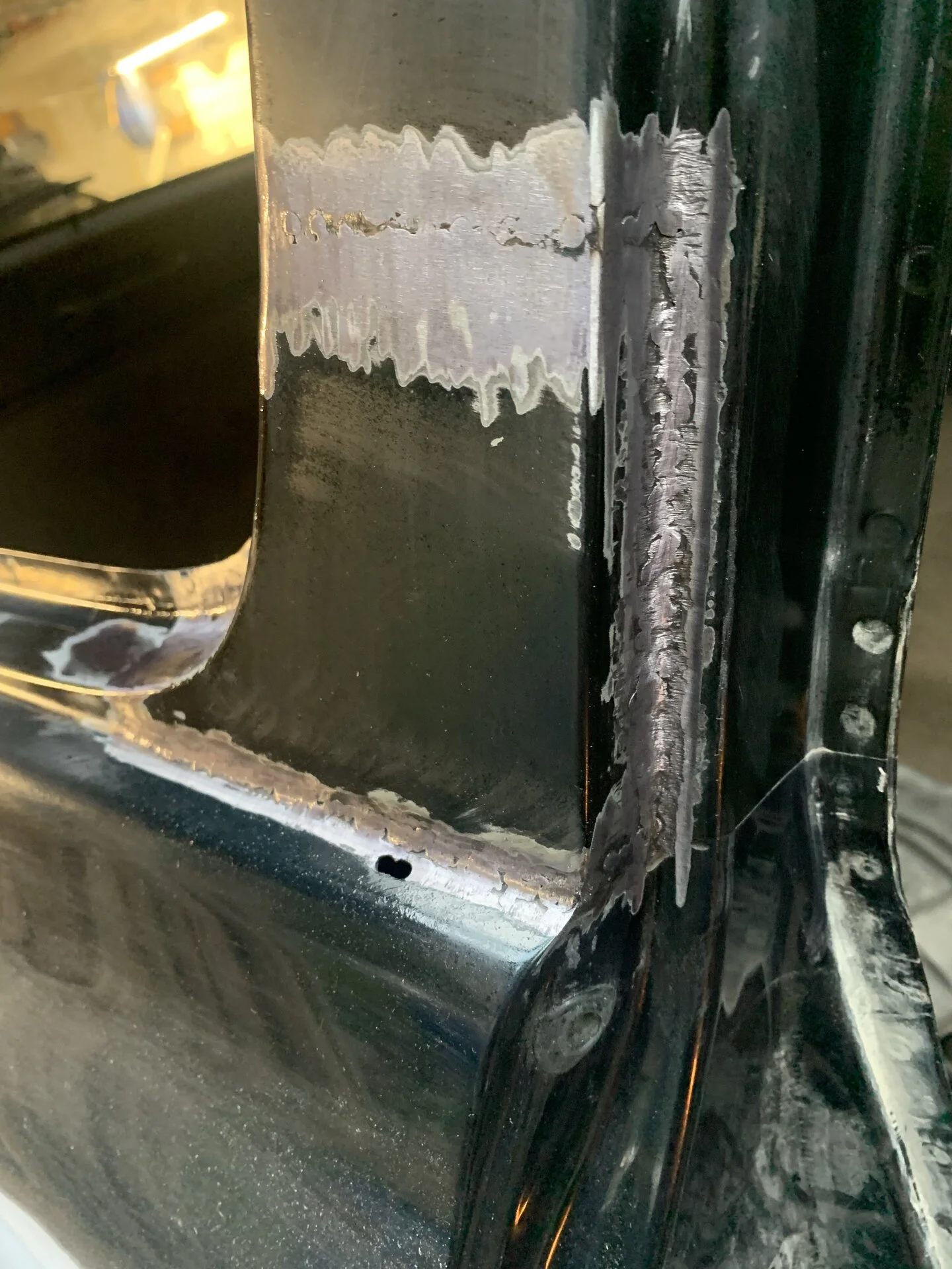

Took a break for a couple of days. Did another pass of welding/grinding/sanding. A coat of rust converter, and then body filler tomorrow. Now thinking of making one of those cargo doors to replace the window(s).

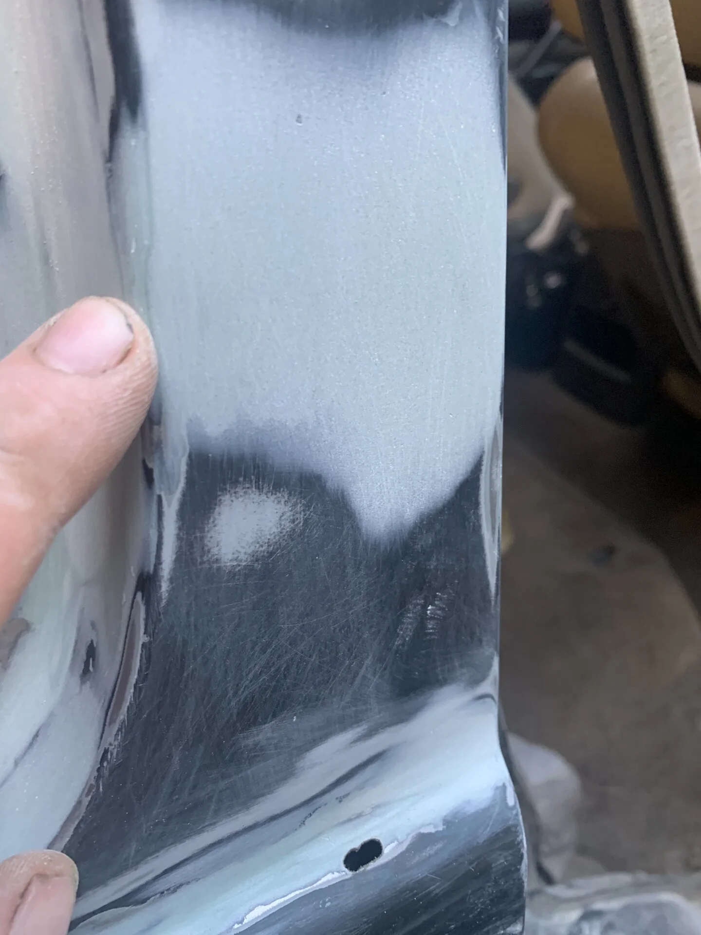

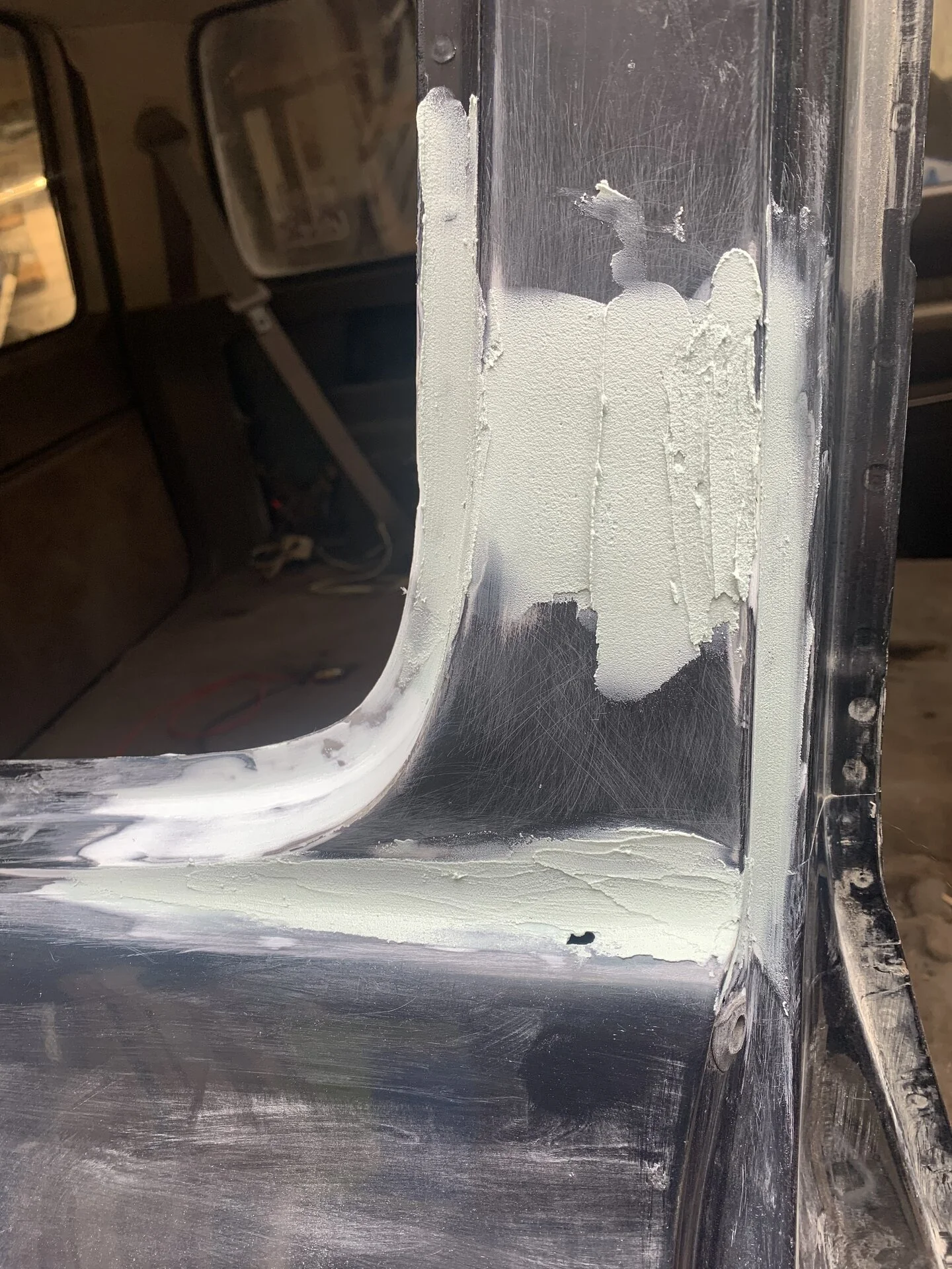

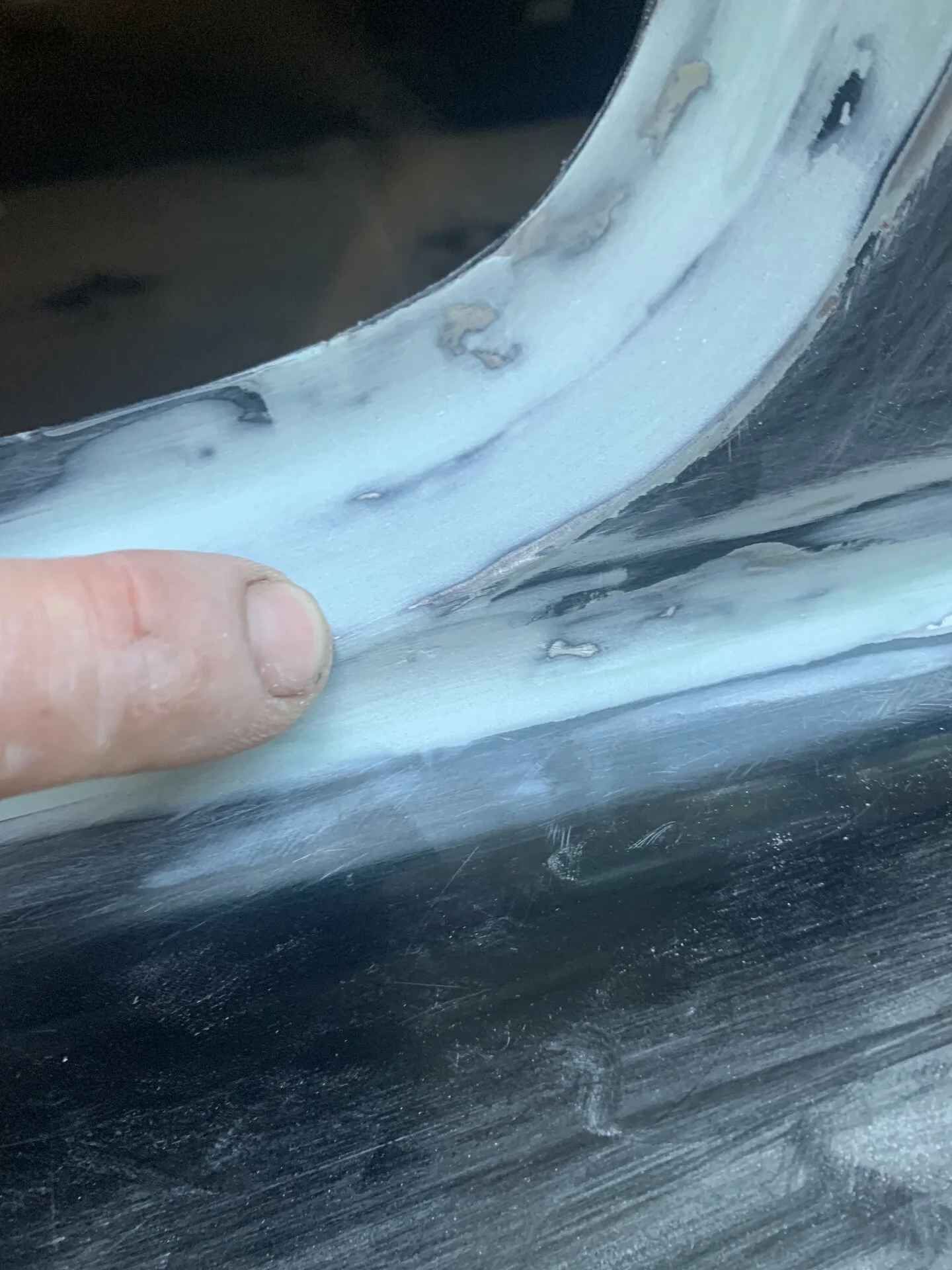

First coat of body filler.
Going to grind/ hammer down some of the metal high points, and then another skim coat. Hopefully, after that some self-etching primer.

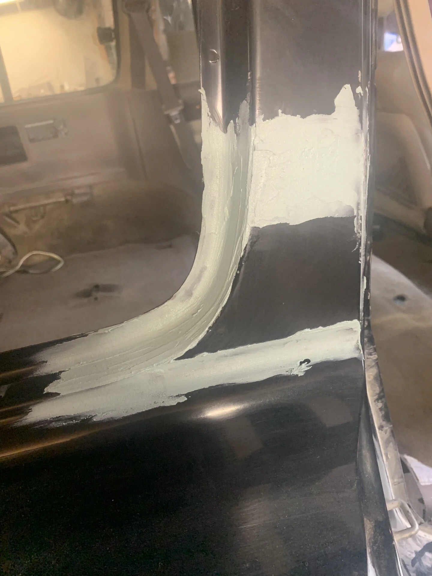

Second coat of body filler.

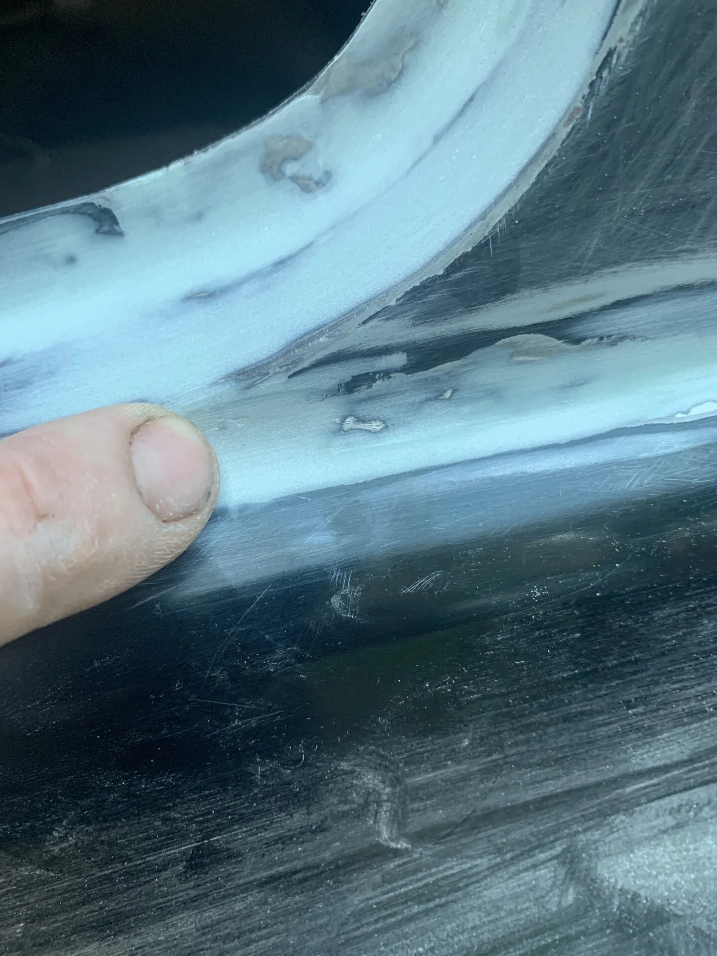

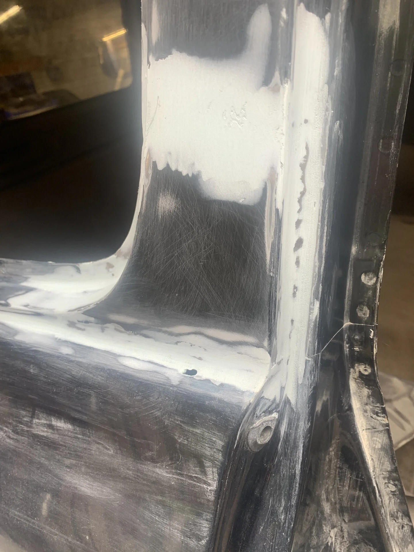

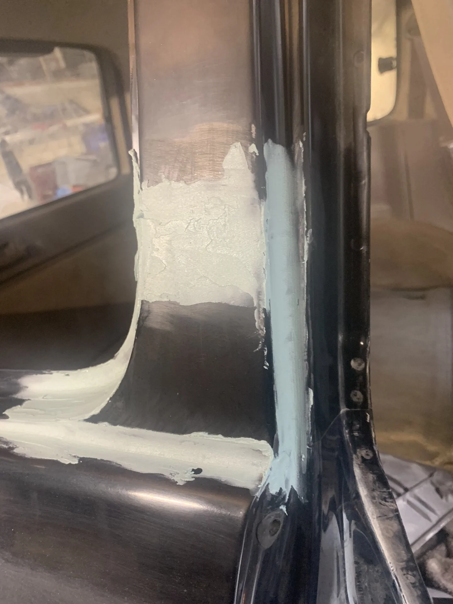

Getting there. Flat area seems good as well as window channel area. Can’t feel the welded sections in those areas. Will finish it off tomorrow.
Had a nasty headache most of the day. Still have a few low spots, mostly around the bends where the welds were. Rest is good. Hit it with some 400 grit paper, but will need a add a bit of filler in the low spots. Also knocked down some of the high spots again with a punch and hammer.
