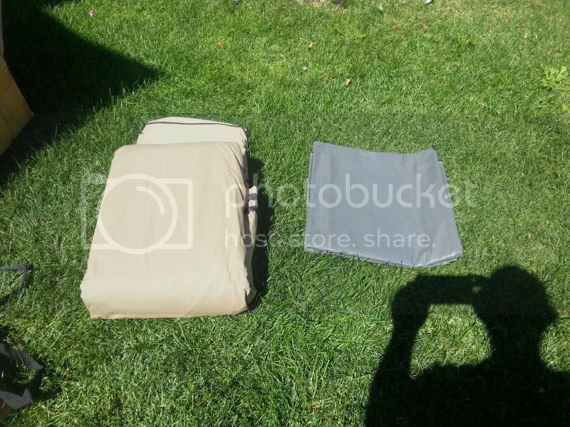

so one of the bags comes with the walls and floor of the awning room..

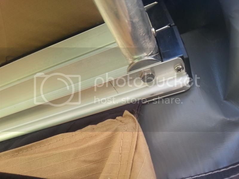

pull out awning as usual and slide in rubber slip thingy through the channel at the base of the awning
then pull out side poles and extend and feed through holes on the other end. (had to open up the holes a tad with a drill)

packs into it's own carrying bag.

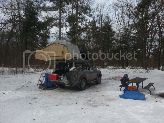

anyway, quick follow up/report after a fun winter camp with the kid..just trying to get more use out of the RTT! :).
but first off, the rtt cover survived that ice storm we had during the holidays. probably one of the worst ice storms I've seen here in 25 years. the cover was caked!
Anyway, junior and I went for an overnighter end of January (was also curious to see how the inside looked). It was dry and clean.
but when I was closing it up, I noticed a frozen spot on the bottom surface of the mattress in the middle where the tent folds. I'm not sure if it was from condensation from our backs or from some moisture getting in on the blizzard drive we had and it freezing (around 10 to 15 below Celsius). not much and I knew it'd dry up easily.
The zippers were fine and set up and take down was just as easy. But what I would do next time if I knew it was going to snow, is drape a tarp over the roof to make take down easier by keeping snow/ice away. it was a little tricky to try and brush snow off and there was a combination of ice and snow stuck to the material. with a tarp, you can gently slide it off and try and get all the snow off before folding it up.
But regardless, I would suggest you air your tent on a regular basis out on a sunny day to dry off some condensation inside.
this time I took the mattress out as some snow had gotten in. easy job anyway to set up and close up.
I would also suggest you take the mattress out NOT through the main entrance but the other end/window. kinda tricky as it's a huge piece that you have to fold/half roll to get out and with the overhang, It was like a circus act trying to stay on the ladder while pulling the mattress (that wants to unfold itself!) out. lol.
Still enjoying the RTT every time and I'm super quick with set up and take down now!

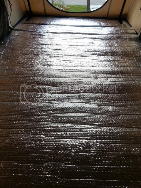

hey folks. just thought i'd update this with one small mod to see about making it a tad warmer. i know a guy who works at one of those indoor soccer domes and i asked what kind of insulation they used for the winter time. he gave me a small piece of this reflective bubble pad thingy (which i was initially going to use for my jungle hammock). anyway, didm' have much but i had enough to line the bottom of the sleep pad.
and here it is folded up and under the sleep pad.
what's nice is it protects this bend on the pad from condensation which i sometimes get. while driving on long rainy days i've noticed some moisture is getting in from the zipper/seams. not much and never a big issue if you open it up and air it out from time to time. we had a good week or two of rain and when i opened the tent there was just a thing line of condensation along this bend (the rest of the tent/inside was bone dry)
going on my 3rd season/3rd winter of ownership and looking forward to the next winter camping trip. will try and get more of the insulation material or something similar and i'll cut pieces to line the roof and the sides. this should reflect/retain more of the body heat. we've been fine with good sleeping bags too.

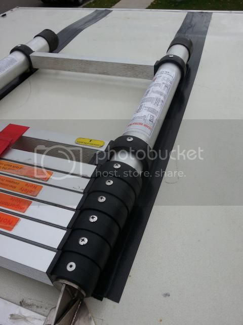

lastly, there are some scratches under the base that the ladder rubs up against. so i just covered it with some duct tape, no biggy.
just gotta make sure you lift up on the ladder as you're extending it.
