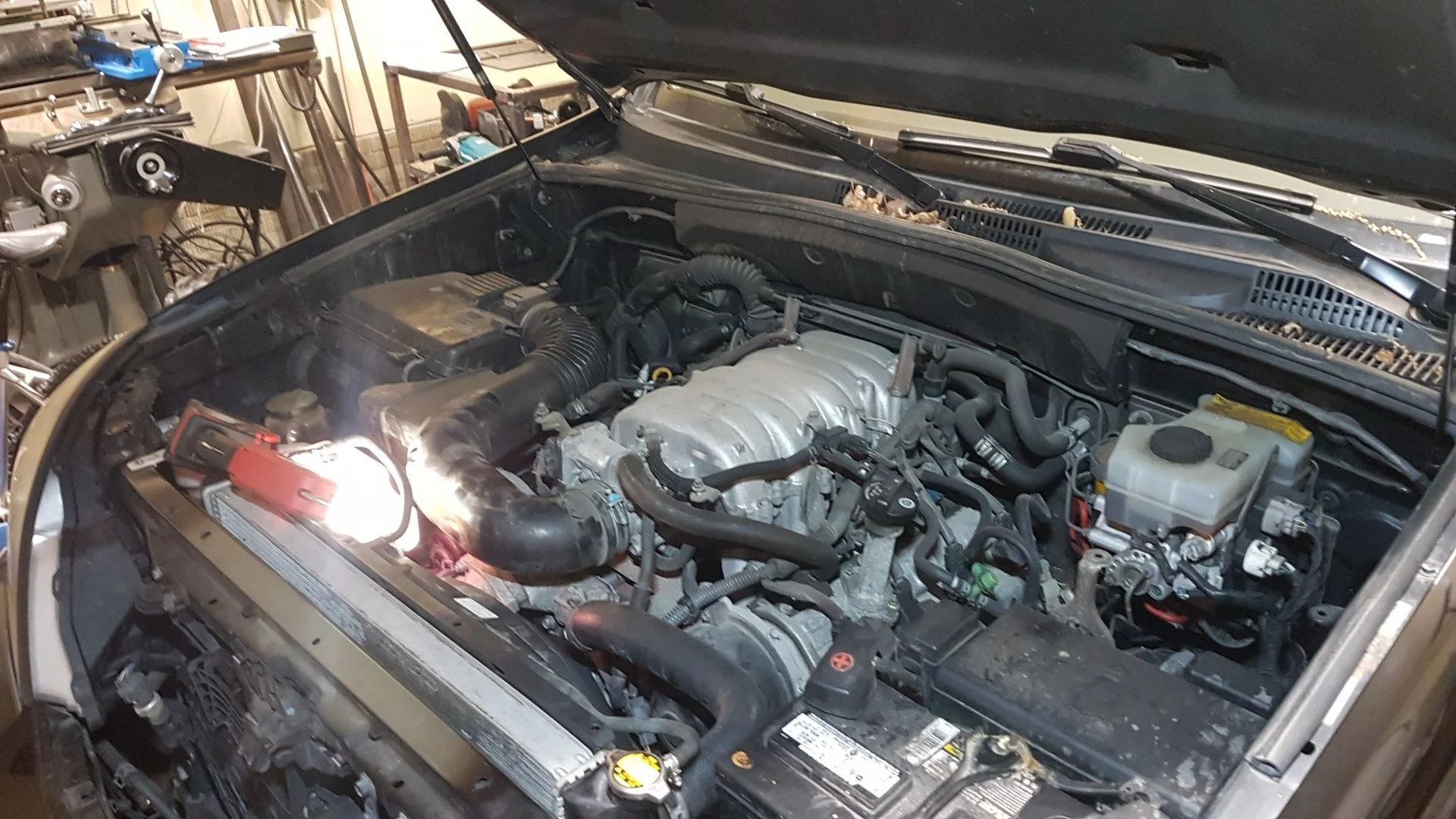

Timing belt, water pump, fan bracket, thermostat, pulleys, radiator hoses, coolant, radiator cap, accessory belt
Also have transfer case actuator o rings and CVs to reboot at something point
Back up and running. Took 5 days working 8pm to midnight amd waiting 12 hrs for permatex and a 250ft lb torque wrench delivery
The gxor timing belt parts list has gates 38001 for an idler pulley but my engine had a 102mm instead of 90mm on the tensioner. Haven't seen any posts on this so I don't know if 04 2uzfes need the 90 or 102mm tensioner pulley, Lexus parts online had both options. I ended up just pressing out the bearing and would recommend that you just buy the bearing instead of the entire pulley
166303-0W010 - 102mm
166303-0W030 - 90mm

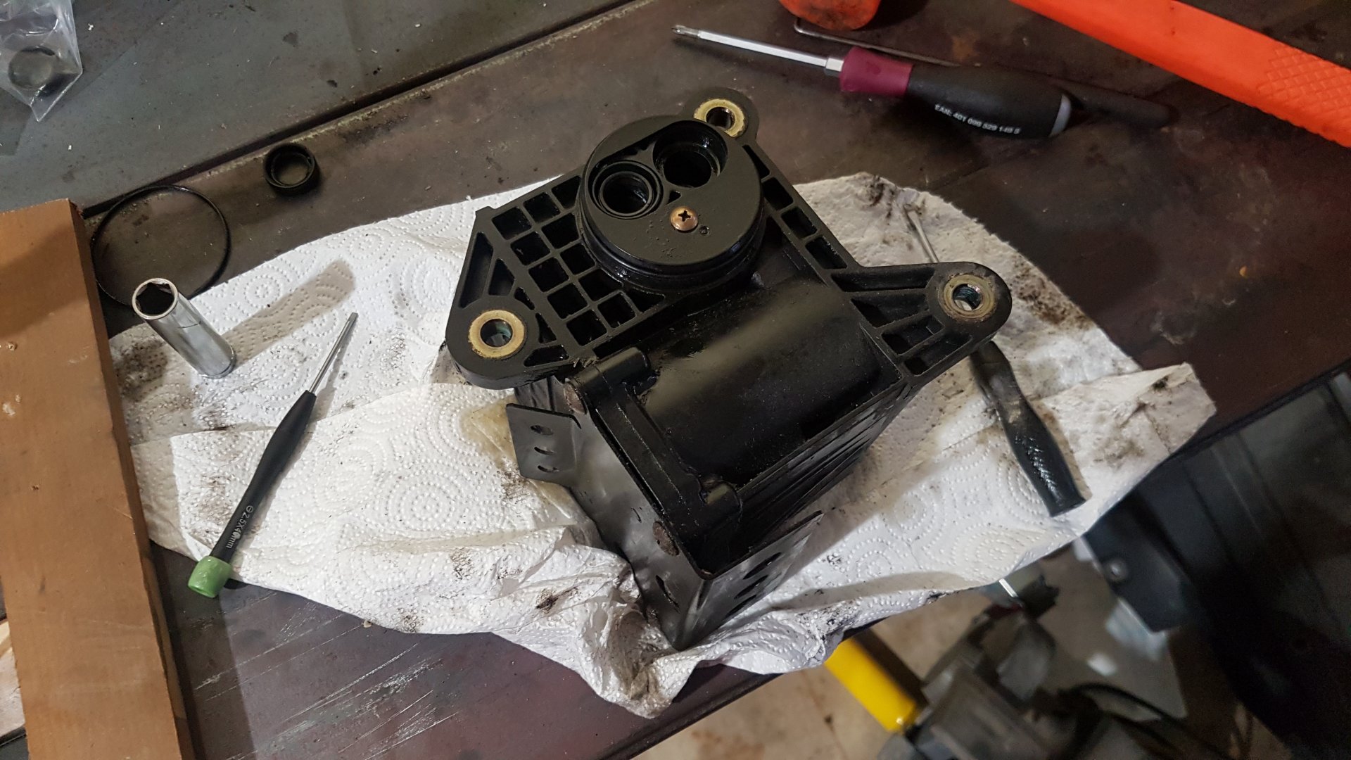

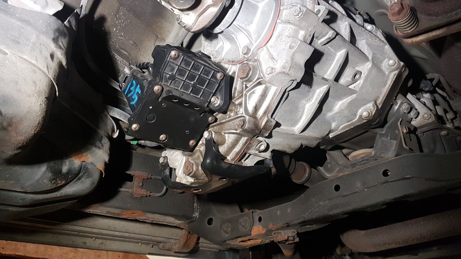

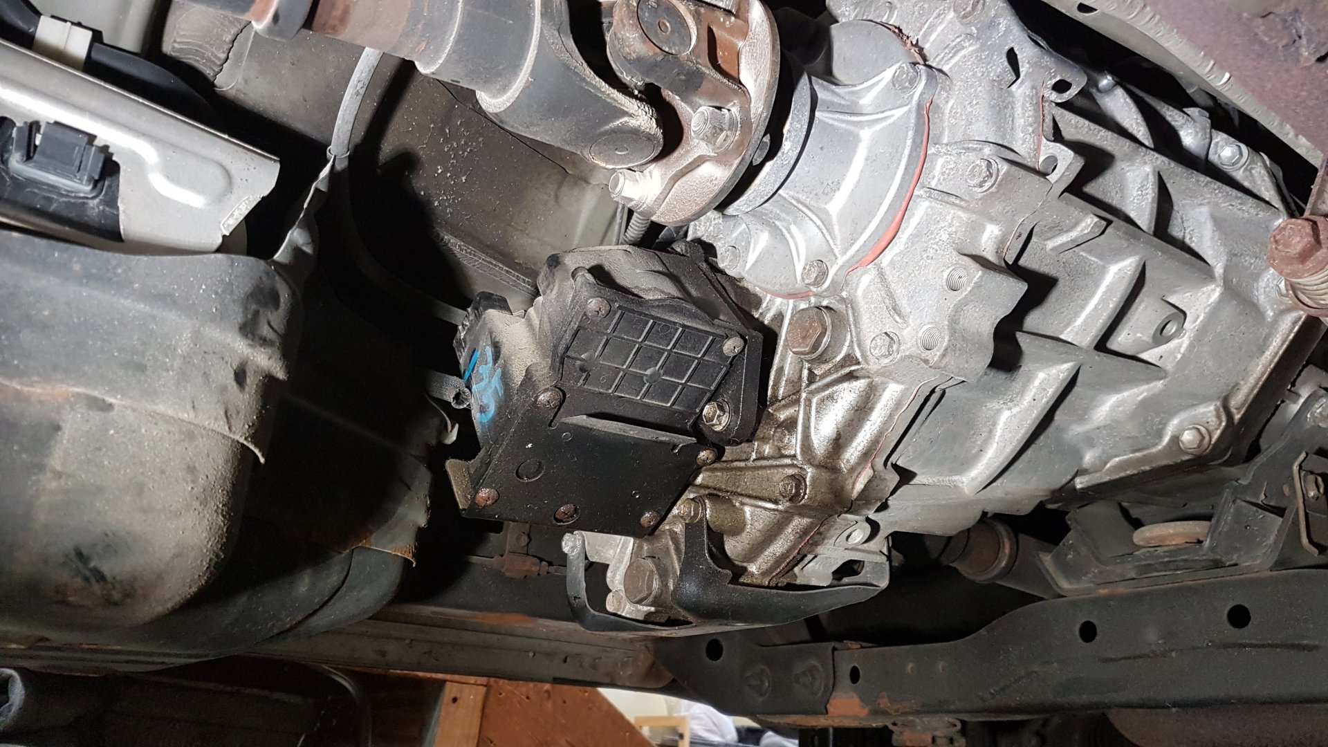

Transfer case actuator leak at 182,500. Took an hour with about 4 attempts to get it back on and having to put the gater spring back in

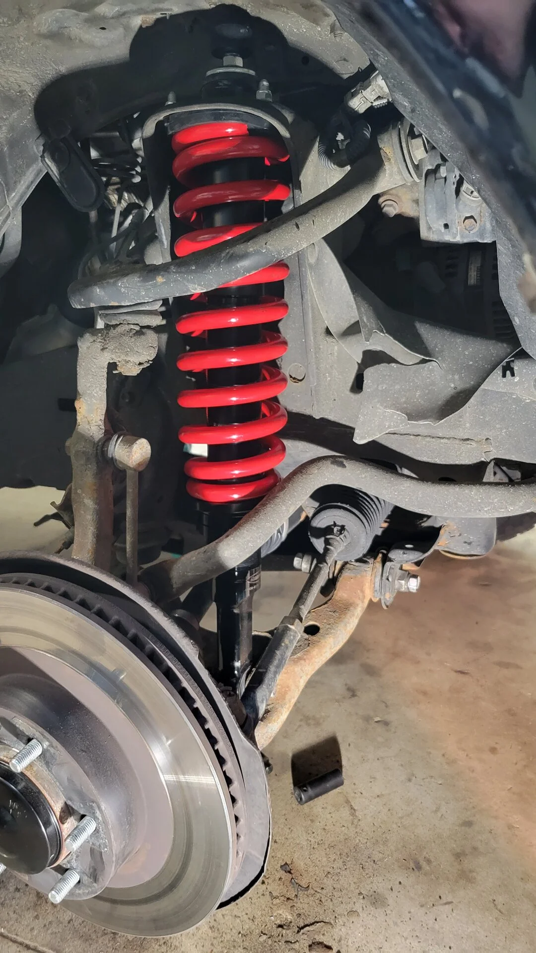

Replaced both front wheel bearings with Yota bearings and hubs with koyos
Replaced both front CVs with OEM 460 axles.

Dobinson IMS 1.25" lift
