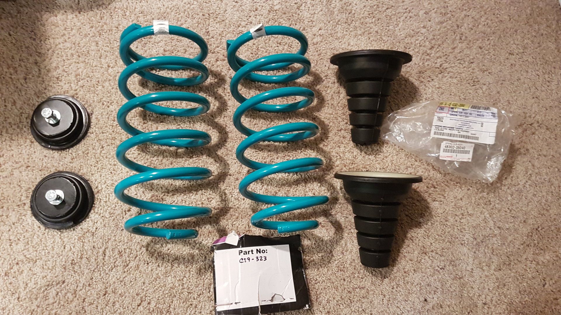

Leaking air suspension, riding on the bump stops after a 2 hour drive on the highway.
Dobinsons C59-313 stock height springs
Metal tech coil conversion kit
Toyota secondary spring isolators 48302-35040

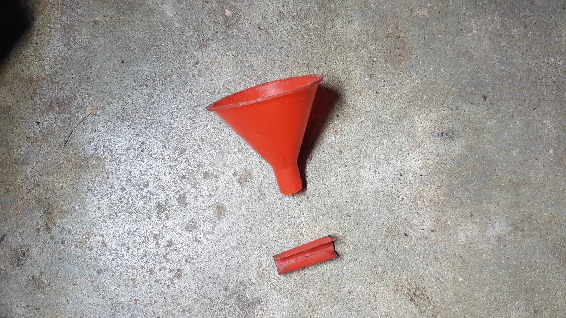

My service tool was a funnel tip and instead of long nose pliers, the bent wire with a tug worked really well.
22" from the hub to fender both sides before and after
If you get the driver side lean, you might need a trim packer.

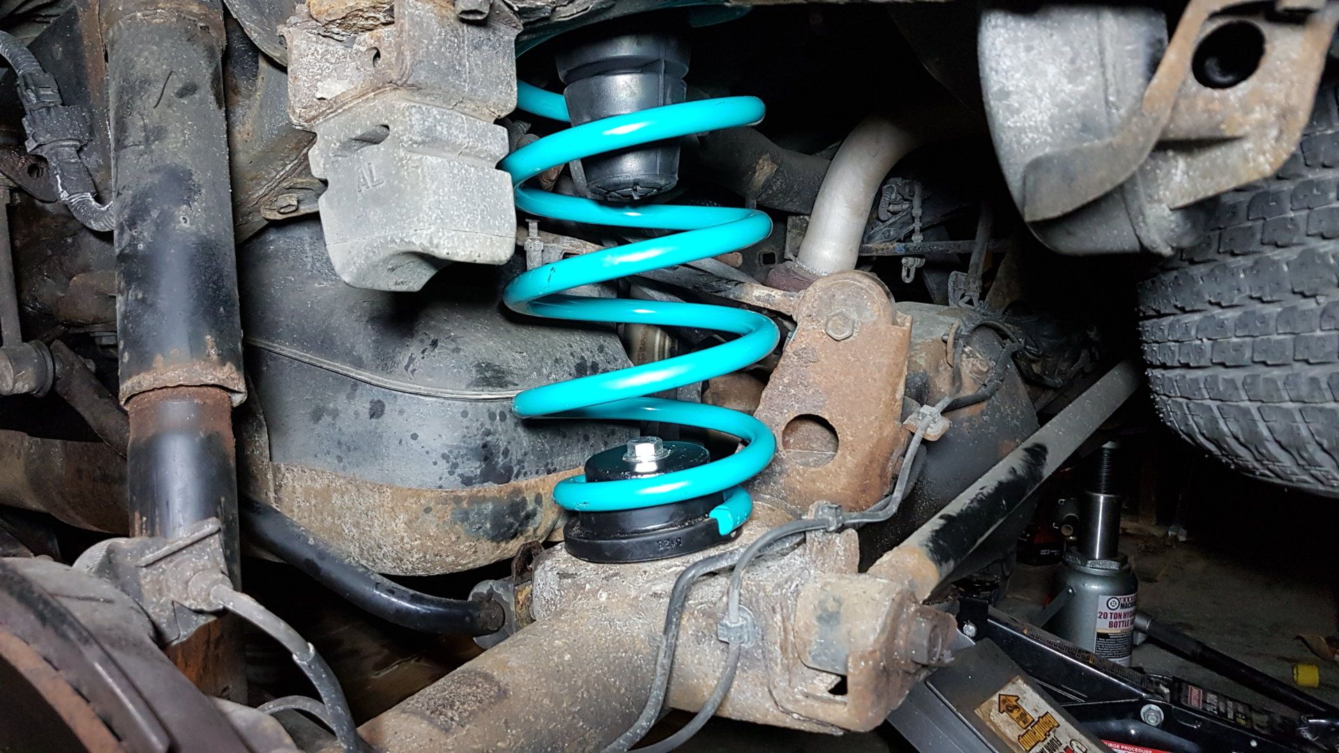

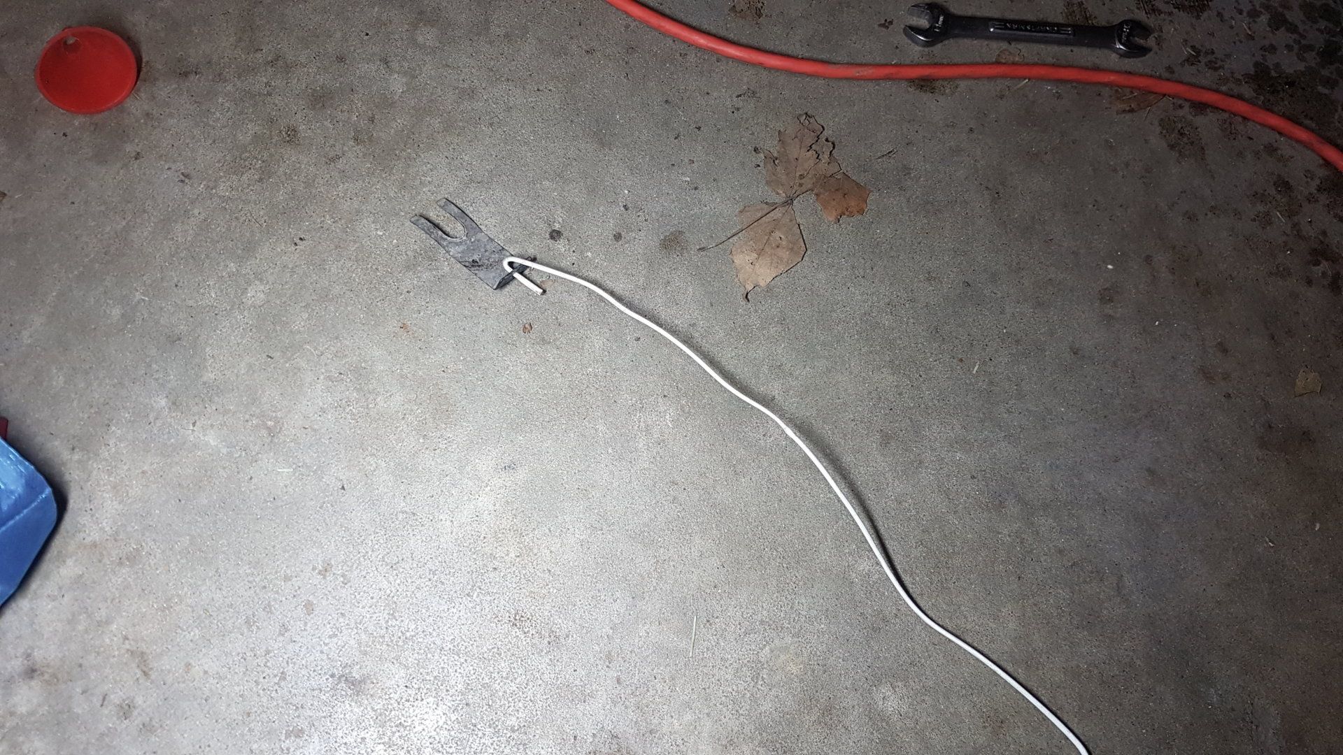

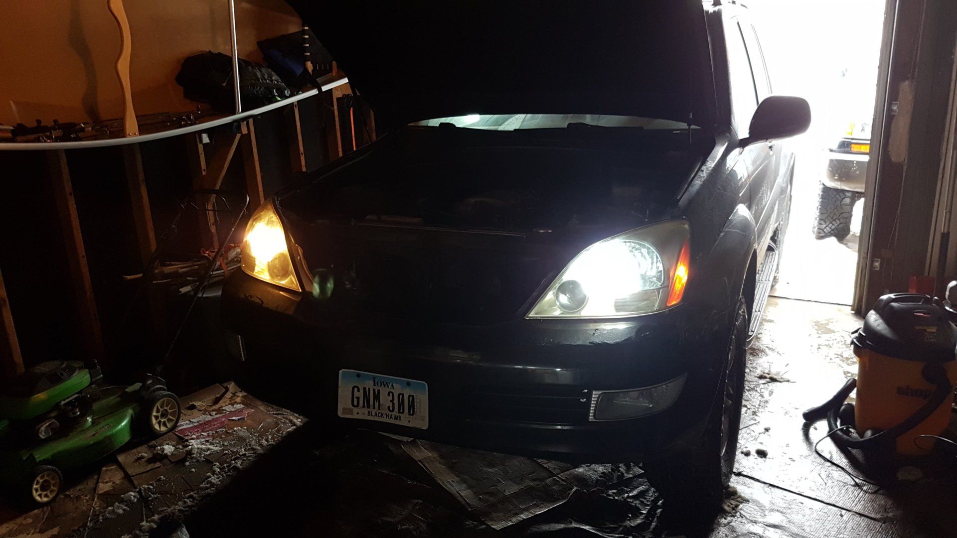

How do you like those bulbs??
Replaced the nasty Lexus chrome wheels with Method MR701 17X8.5 0 offset. Added a second car seat in 2020 and road tripped to SW Florida with a 2 year old and a 4 month old, clocked over 180k and ordered parts to do timing belt/water pump.
Awesome to see another GX getting heavy family duty - they really make a great dad ride and a family road-trip vehicle. My 3-y/o and 5-y/o love ours. Unlike a crossover with a high belt line, they can actually see out the windows from the carseats, and the OEM DVD player works just fine. When we ask the kids which vehicle they want to take somewhere, 9/10 times they choose the GX. Often times it feels odd to be using our 14-y/o GX as the primary family car when we have newer vehicles, but the GX just works better. We're planning to take ours to CO/UT this summer for vacation.
They are definitely bright and haven't crapped out yet in 2 years. Fan noise is minimal, plug and play. I don't know what to compare them to though. With all LEDs, they wont melt headlight snow/ice. Debating getting sport headlights and trying HID conversion though
Where did you buy them? Any adjustments needed?
