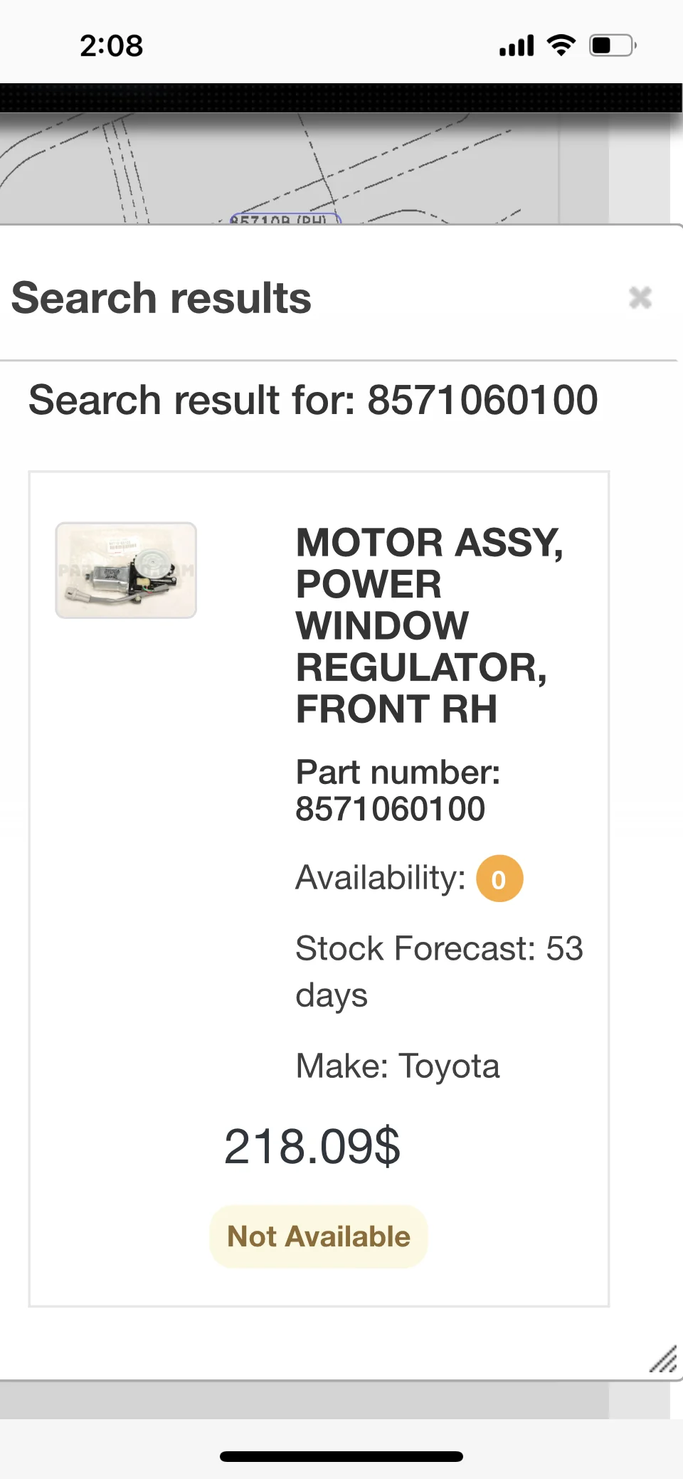

Thanks. On yoshiparts, all the online oem Toyota sites and partsouq it calls for 85710-60100. All of which show not available. The partsouq at least shows possible stock in 53 days. I can’t imagine there would be difference from other 100s, but it appears so. I was actually hoping
To get the whole assembly (with regulator) but would do just the motor if necessary. Maybe the dealer can give me explanation/number that is available/works. Rather use oem if possible.
forgot to mention all the hits on crusin4parts came up negative for availability but thanks for those sites, new to me and I’m sure will be helpful for the many other things on the list of to-dos

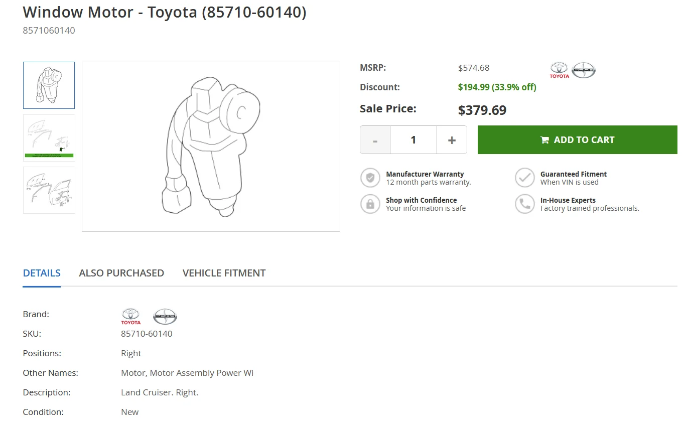

Bumping this thread: I need a RH front window motor. Mine is 2-wire/no auto up. Partsouq calls for 85710-60100. It appears NLA.
85710-60140 provided above appears to be a 3 wire. Also Cardone 82-10002 I ordered from Amazon is a 3 wire.
Somebody give me a part # for a 2 wire RH window motor!

Hope this helps
Thank you! So this looks to confirm that the part is NLA. 😢
Not really interested in a used unit. Anyone have an aftermarket suggestion?
