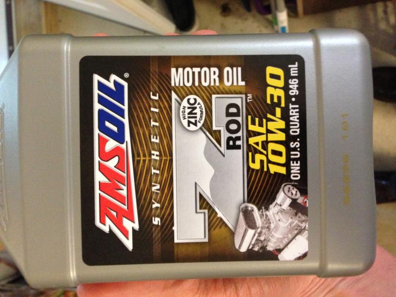

I just purchased 3 quarts of Z-Rod for my Karmann Ghia...$30.00 bucks! I wish I could afford it for the 2F!
Zack
