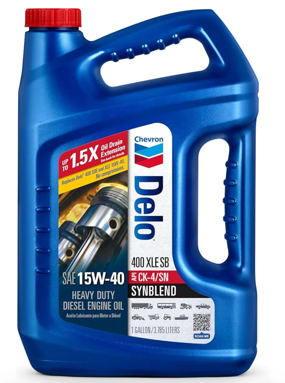

Can I use Delo 400 LE 15w40 in my 2F?

So is this the right oil for my 1978 fj40 2F Gas???
@Landlover12 I see you're in Maine, so with severe Winters, you may want to run Rotella T5 during the cold months, and give the truck a good 3 min warm up before driving.
totally agree 15-40 is more of a diesel weight. in cold i’d want a 5-30 for a gasser and 10-30 in summer. it’s hard on the engine not having enough lubrication when cold. 15 weight is a little too thick for my liking but as you’ll find in every oil related thread you’ll get as many different answers as posts!! also good to add a zinc additive that modern oils don’t have. i took out a cam and lifters in my chevelle unfortunately not knowing that detail.
