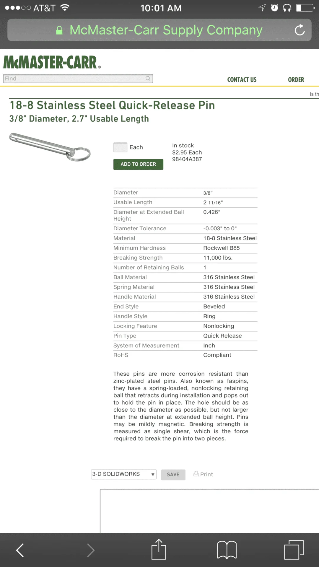

Want a quick way to fit two 6 ft + dudes in the back? Drill out the bottom hing pins for quick release. Pull the bottom bench and slide the front seats forward. In the rear footwell put bags or gear to fill the void and stretch out.

That's sweet! just a hitch pin? Did it create any unwanted effects like rattles or slop in the seat?
Nothing that I can tell (audibly). There was some negative feedback about this on the forums due to the lack of a pin clip to retain bottom seat mount.
Overall this is great and very convenient. I can look up the McMaster-Car order of that helps at all.

Sweet! Yes, I'd love the part numbers you used if you have them handy.

Part number is in the photo just under the price.
