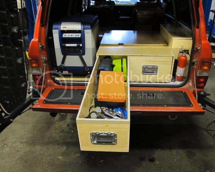

AMAZING job. So cool that you put all the measurements in that thread. I've been looking for that level of detail. Thanks!
The only major difference I want for my conversion is to have the sleeper area fold out over the 2nd row seats. Of course, it will make for less headroom but the vehicle can then move up to 5 (even if some have to sleep in tents.)
Love the slide out fridge! And the extra netting panel draped over the tailgate is a great idea.
Thanks for the comments. Yeah, put a lot of thought into it, there was too much expensive wood involved to mess things up. Do second guess all those measurements, but they should give you something to work with.
The second row area is sectional, but since it's just the wife and I, I've never taken it out to reinstall the 2nd row.
