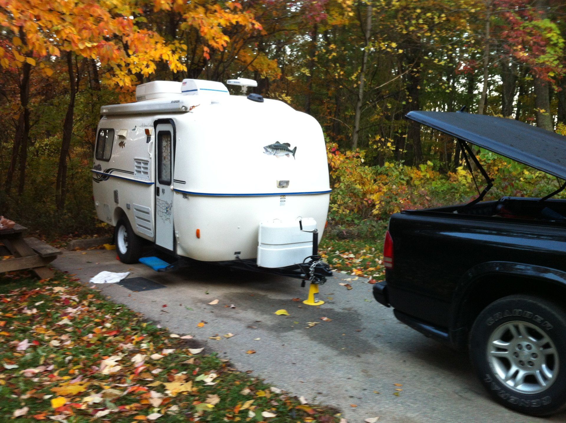

The first pic with the Tundy is my current trailer its a 17' Casita Freedom Deluxe which means it has the Captains Chairs on the side where the SD model has a bench that can be a bed too.Those models can have bunks modded into them for the kids as well but a lot of us make the little heathens sleep outside in a tent too!
I have had an SD but got rid of it when I found this FD as it is just a nicer rig all around.
I have never and will never buy a new one.
I don't buy new vehicles of any kind,I simply would rather someone else take the hit on the newness premium and like the LC the FGRV are just put together differently and they really do last.
This is my 7th one I guess and I have only made money on every one of them.
The biggest problem with FGRV is finding one and snagging it before someone else,really.

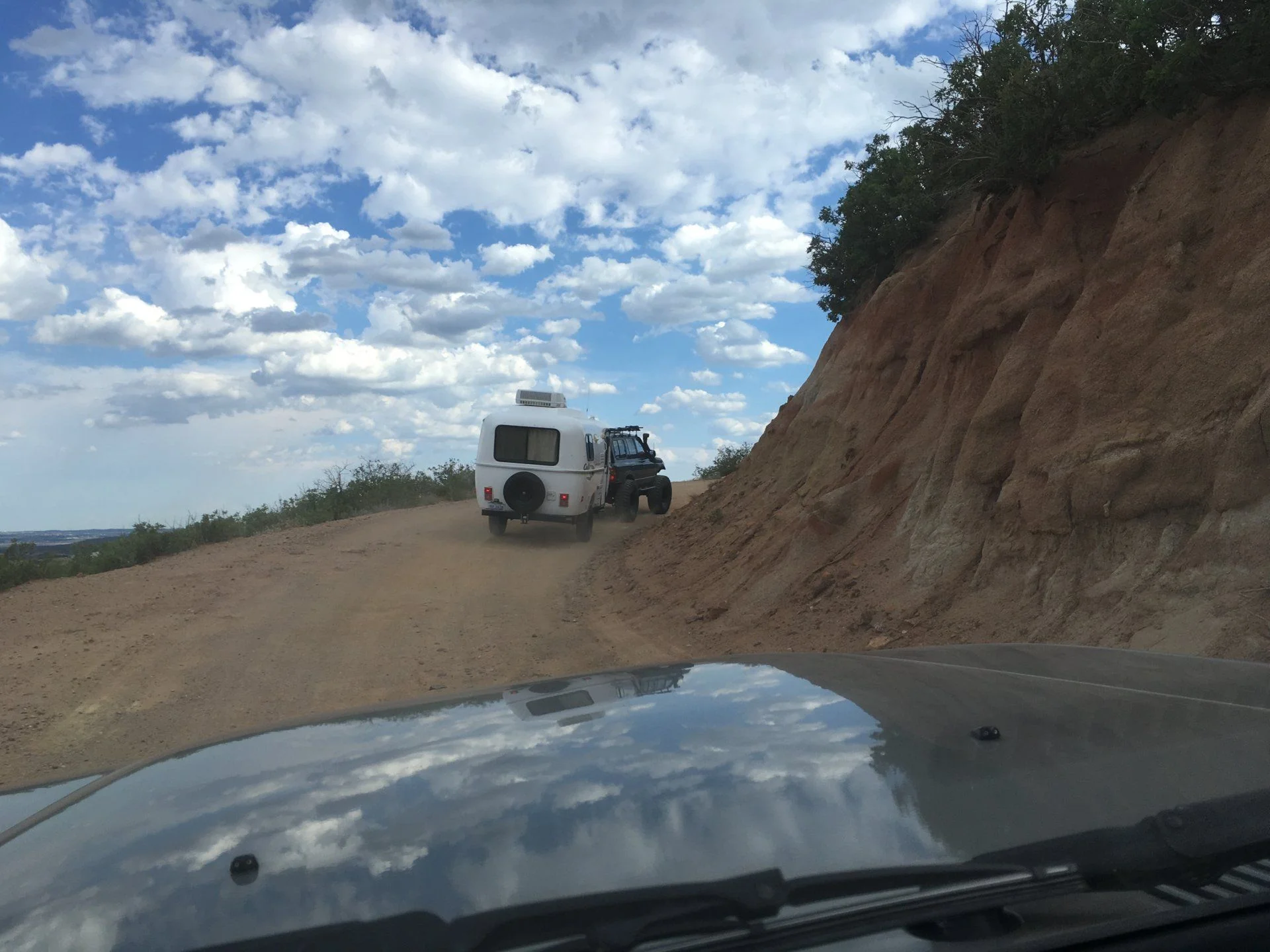

The biggest issue that people have driving off the beaten path is the same as on the road these days I think.
If you want to beat the crap out of them just drive too fast.
If not then crawl along,you are dragging an Egg with wheels and treat them as such.
Also like anything else 4wd related it requires training and practice to get around and don't try to act like it doesn't?
So I go Slooooooow and nothing ever gets killed.Pretty simple.
There are lift kits and suspensions made for these too and I have sure considered doing something but I also feel like if its not broke why fix it so I haven't tried to.
I will likely get larger wheels and tires next and start there though to gain a little tank plumbing clearance but I do have timy skidplates on mine and when I sense scraping I go even slower.
I have dragged these to Tuscon,Santa Fe.all over Colorado western slope mainly though,Florida,Maine and everywhere in between and I am a beleiver.
Most of us over on that site I linked to above are and we have Rallies all over the place all the time.
There will be 100 trailers in Sebring Florida next week for example for the 16th year I think.
I have and keep having a lot of fun and yet these are so small and simple it is just a dofferent kind of camping.
Feel free to ask anything you like.

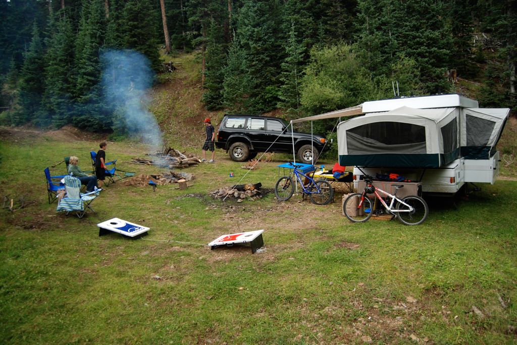

I like the TetonX Hybrid as well, but here are my thoughts on what I have been through. Personally, if I was to do it all again and depending on the age of my kids, I would do another tent trailer. Here is the short story of my trailers. On a side note, I only sleep in paved campgrounds when absolutely necessary and most sites are completely off grid, meaning no hookups or services.
Back in 2008 I picked up my first tent trailer. Family of five and sometimes my mom went so I needed the capability to sleep six. The tent trailer was perfect. I bought a large one with a slide out galley, two kings and then the dinette would convert to a bed if needed. I did a spring over immediately to get a bit more height. My family and myself absolutely loved this trailer. I probably pulled it 20K miles all over the place and very often on rough roads. Never really had any material problems, but after owning it and really using it for 8 years it was showing a bit of wear. Little cracks, lots of rock chips, etc. It just began to look worn. Still my families favorite trailer to this day. Weighed in about 3300lbs fully loaded for a four day trip for six people. Personally, I don't think it gets much better than this for my family and myself.
The upsides
Low price of entry
Plenty of room for everyone to have their own space
Comfortable inside
Low overall height when traveling
Easy to tow - this does not mean light, just easy to tow - good characteristics, easy to see around and over, etc.
Lots of storage
Downsides
Cheap cabinets and plastic shell prone to damage from washboards and rough roads.
long rear hang over prone to dragging
Hard to run large tires
Soft tent canvas sides.
Cold inside when its cold outside - the heater would run a lot on cold Colorado nights

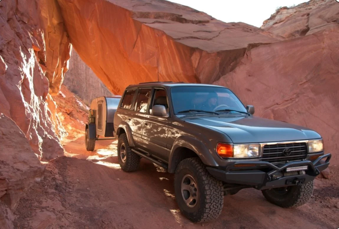

During this time, I also owned a teardrop trailer that I had built with my father a number of years ago. I really like the teardrop, but its too small for a family. I love how small and easy it is to pull, but standing outside in crappy weather or when it is really cold just sucks. I do like how easy it tows, you don't even feel it, and I really like how warm it is inside when sleeping. No room for kids and my wife isn't a real fan of there being no shower like the pop-up had, but its still pretty great. If I had it my way, I would throw a tent on the top for the kids, but they are old enough now that probably won't happen. IMO, its the epitome of what I want in order to be able to do hard trails and still sleep on a normal bed. I have also used and slept in this trailer a lot.
The upsides
Home made
Very light to tow - approx 750lbs
Can get it back in anywhere
Comfortable and warm inside - regular queen mattress to sleep on:)
Easy to tow
With long leaf springs (from FJ60) and shocks on it, it rides super smooth on rough roads. Nothing breaks, nothing cracks, all food and things are in their place when we get to camp.
Easy to run large off road tires on it.
Downsides
Small
Only holds 12 gallons of water
Only sleeps two
Have to cook outside
Have to shower outside in a shower tent.
My son had a Casita for a short time and it was really nice. Definitely worth the price, but not large enough for more than two people in my mind. It was very well built, we did a 4" lift on it as he dragged that thing lots of places, but it was pretty tall and didn't ride overly good on bumpy roads. If I was to ever do a Casita, I would probably swap the torsion axle for one with long leaf springs.
It was super warm and comfortable. Nice kitchen, plenty of capacity, inside shower, etc. Pulled nicely too. It was just a bit big to get back into tight spots in the forest.
That's my 2 cents.
