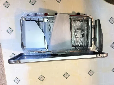

So I ordered two Denali 3 burner units (2 plus small grill) based on their reputation for performance. The units I received both have warped lids. They will open and shut alright and the wind flaps mostly work (at least one side) but before I put these in the field and live with the lids I want to hear from you. My recent Coleman Perfect Flow Grill/Stove units seem built better and with tighter tolerances. The CC lids are thin and flexible.
Should I return these and get the coleman 2 burner units? Is this a fluke and I got two bad Camp Chef units? Shoudl I just use them and not worry about the lids?
Looks defective to me. Something's askew. I'm pretty sure Camp Chef would agree. It's the sort of thing that might get missed in whaetver quality control that's done, as you'd have to do more than quickly than simply slamming the lid shut and checking it would latch.
If they're brand new, the vendor you purchased from may just want to make it good, depending on their policy. If not, contact Camp Chef. They seem like a stand-up outfit, although I've had no need for any warranty service with our Camp Stove.
Greentruck - I bought one and it was skewed - got the replacement - it was skewed - both brand new never used. Amazon is the vendor and they are totally easy to deal with for returns.
I contacted Camp Chef today by telephone and email and recieved an initial reply of that's they way it is. I reiterated my point to them in a reply and I'm waiting for their second attempt at customer service. I did include that photo.

Well, that's interesting. I'm sure no one drew it that way.
Sounds like there's a bunch of 'em out there, too. In fact, what it may do is help makes sure there's tension where the side shields hook in to give it more rigidity when set up. Depends on if it bothers you or not, as it works, sorta.
And if you have two and it bothers you, I'd take advantage of Amazon's good will to get you something that works the way you like.
... what it may do is help makes sure there's tension where the side shields hook in to give it more rigidity when set up. Depends on if it bothers you or not, as it works, sorta.
I sort of thought that at the beginning and it would certainly be true for one side but when you slot the second wind block into the lid notch it basically flops around.
I can probably make it work with a little "attention".

If it was me, and the one end is going to be flapping in the wind, that could be an issue. That's when you want it to work best, not gape open so it doesn't shelter your flame. There may be a way to squeeze it so that it does latch better -- maybe adjust the clip thingee that does the connection between back and side when it's open?
Thanks for the input guys.
From Camp Chef's Director of Engineering:
"... On this particular model of stove
because of the way the lid is formed it does have some warp to it. This is
normal and all of our production is this way."
So there you have it. It's not visually pleasing but on the other hand I'm interested in the performance for cooking. I went ahead and fired it up and all systems are working so I'm going to go ahead and keep it. I have given the unit some "attention" so I think it work out.

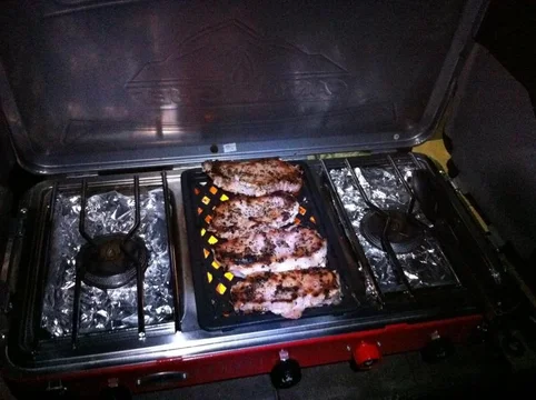

So I took this stove out and used on a two nighter this past weekend. The warped lid isn't a functional problem but one of design esthetic. It does work as intended.
Here are the two standout things that are apparent after this camp out.
1. The burner performance and control is very good. Much Better than my Coleman Insta-start. Plenty of heat. The small grill functions well - I grilled 4 Pork chops on it to perfection. Clean up was pretty easy. One thing to note on the grill - the burner tube's last two inches (toward the control side of the stove) doesn't have any flame holes. It seemed to run slightly cooler in that spot.

I wonder if you could drill a few more holes in the tube for the grill, or would that compromise it?
I think the stove will continue to work well - I just expected it to at least be Coleman quality in it's finish. It was $90 so it's not the end of the world. I have a chuck box under construction similar to yours Corey so size and weight are considerations.
I considered the drill method - I need to take the stove apart to see whats what. If you look at yours you will see some kind hole below the missing holes. I need to determine what that does. The drip hole is at the back of the stove.
