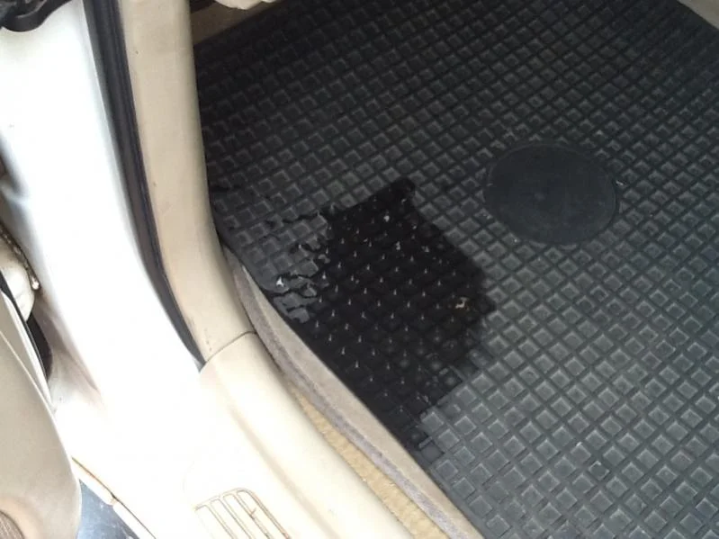

Found this on both front right & front left after the rains, any idea's as to what causes this? In my wife's Chrysler Grand Voyager it was a blocked cabin air intake system that sits between the windshield and the bonnet. Usually it has drain pipes that run inside the engine compartment but if during Autumn it fills up with small things from the trees, and gets blocked, then the water fills up and spills in through the cabin air system... Is this the case on the LC100?

Trunk Monkey, Texas 996 & Yukon LX, thanks for the help, I had a look this morning, found the holes mentioned above, bought a roll of plastic wire that fits on a weed killer machine from the hardware store & pushed 2m of wire down the LHS & 1m down the RHS and then cleaned all the dust off where the seals let the water in, and then poured a little water down the holes & both sides the water came out on the front mudguards... Next is to spray a little WD 40 onto the railings that I cleaned up & it should be good as new

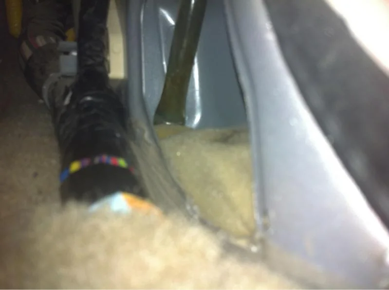

I tried to the weed eater cord but to no avail, but there was a good reason why... the hose that connects to the drain was kinked! The kink was near where the hose exits behind the footwell kickplate underneath the glovebox. I can take a picture and post later. Initially I didn't know where the hose exited but I found in short order after blowing it out. I attached a small silicon hose to my air compressor and ran it about 2ft into the drain itself before turning it on. It built up some pressure and... boom! the kink had aimed the hose back into the cabin so water and sludge shot out all over the carpet and seat... (the kickplate was already off because I has to lift the carpet in an attempt to dry it out). I squeezed the hose a few times to work out the kink, aimed it back into the right direction and now I'm good to go.
tl; dr version
the drain hose exits behind the kickplate, check for kinks there if you can't get the drain unclogged.
Edit to add pictures. The hose is the brownish looking thing
