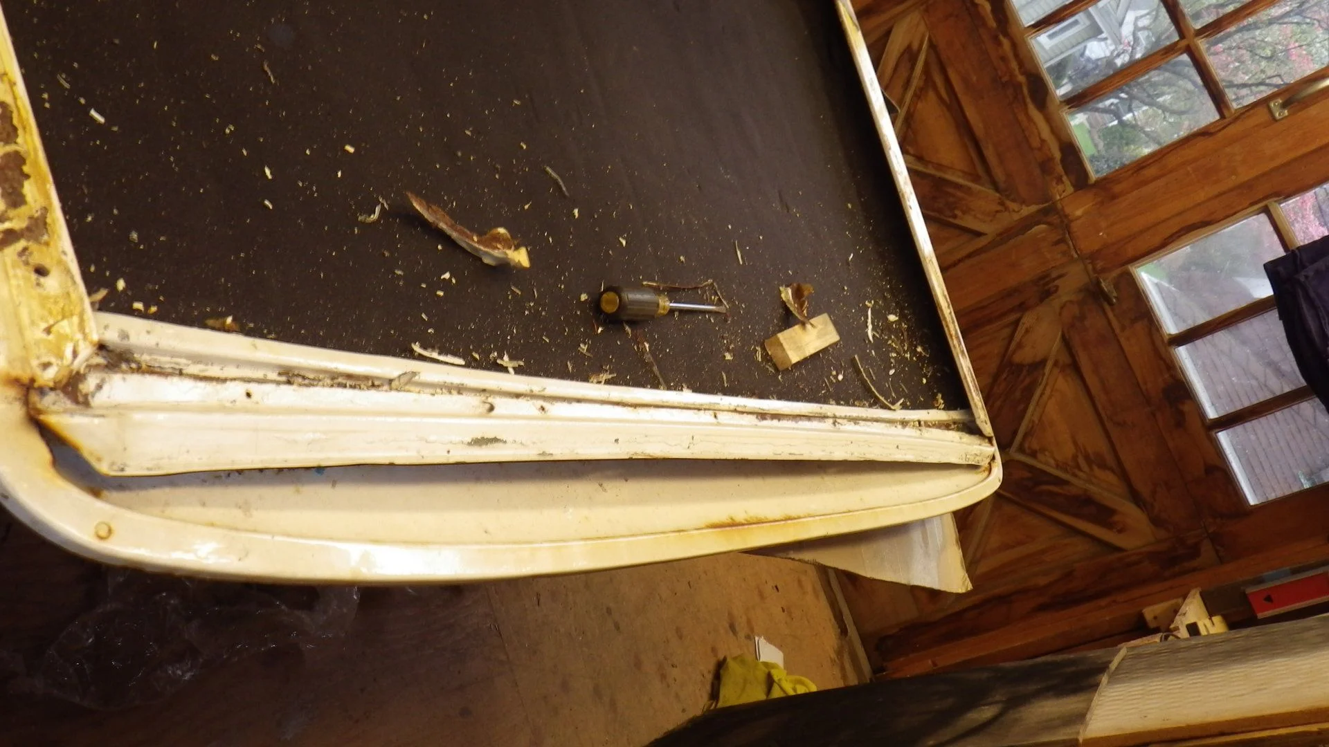

I have moved this thread from the 40-& 55-Series Tech forum I'm trying to find out what I have here.

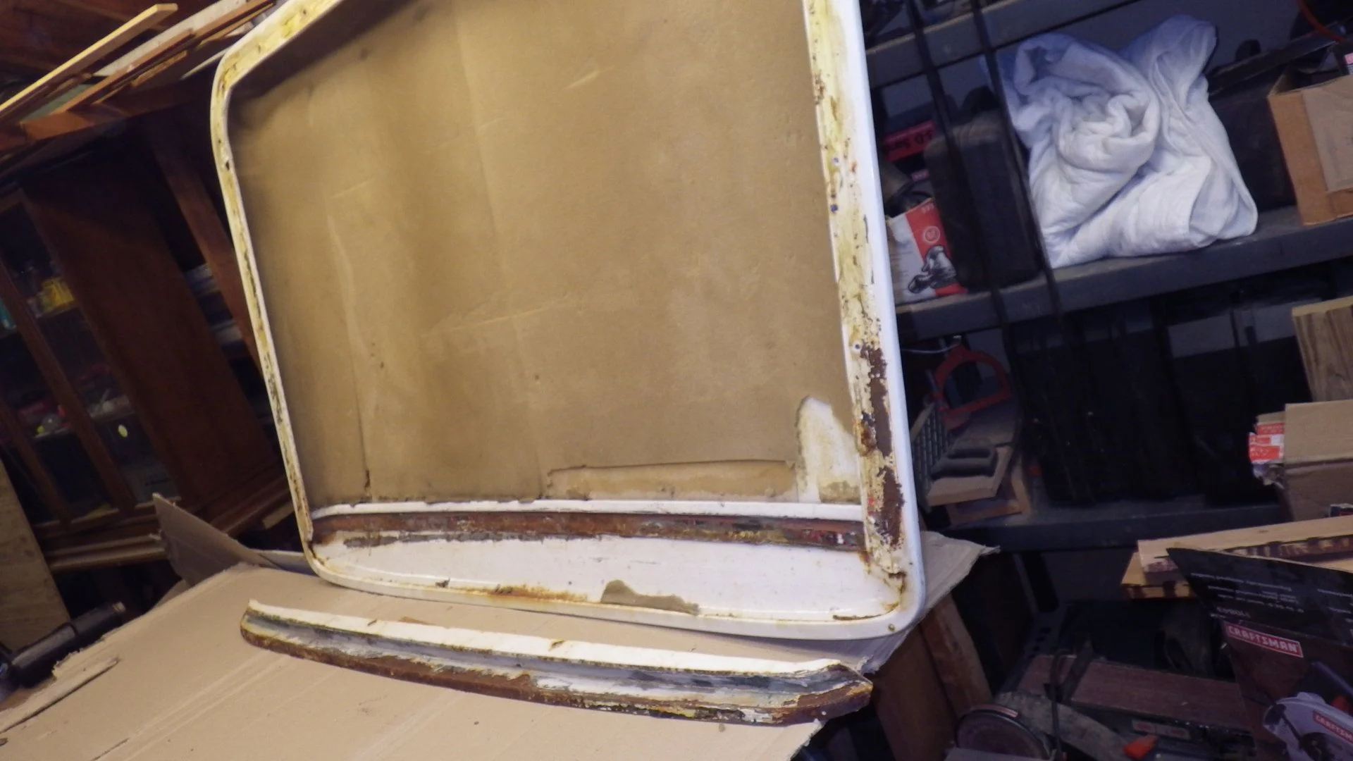

This roof is all steel. The ribs are covered by cardboard and then foam for the lining. The cab is a FJ45 with a long bed, the roof year is anyone's guess.
I'm trying to figure out if I'm working with a poorly restored stock roof, an aftermarket or something someone just made up, to work?
Is this a one piece roof, aftermarket or something different? Diagrams of cab roofs I've seen aren't one piece and don't show the mounting rail around three sides like mine. Having just used a heat gun on the, glued, windshield guard to separate it from the rest of the roof has me thinking this isn't the way Toyota manufactured this.
The windshield guard has holes in it that could have been from spot welds or for bolts but I don't see where they would have been attached prior to the glue.
Can someone tell me what I'm working with here?
Year helps also. Looks newer without clips and with front lip

Angelo,

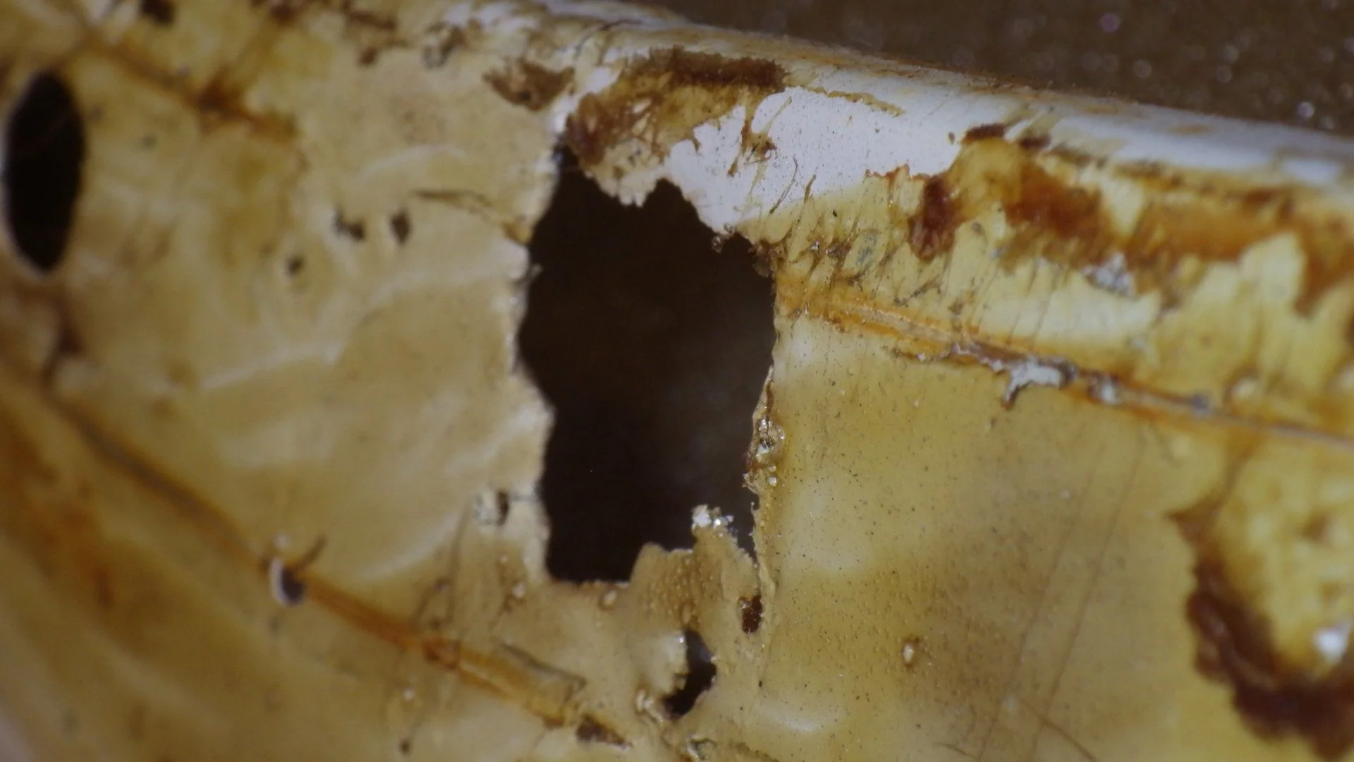

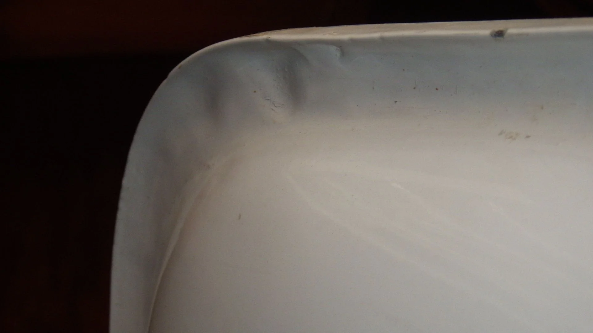

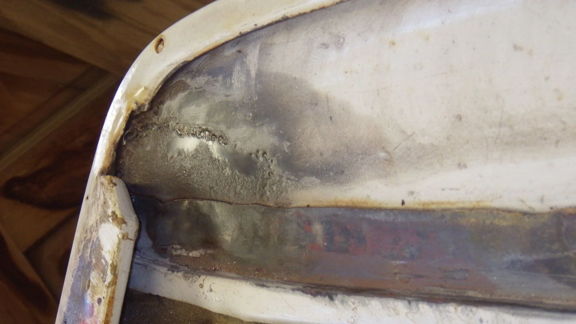

The exterior looks pretty good from your photo. It looks like a seam sealer or some type of putty may have been laid into the outer drain lip; the drain holes can be re-drilled. The weld in the underside corner is at a stress point that can open and looks like it was repaired. I have trouble understanding your underside setup at the front. Without the three loops attached to the crossbar, I think you have a later non 64-67 roof.
I am not familiar with the 10/67-1975 roofs, but you could have the roof that began in 1975 and ran thru the end of production. That roof has two metal tabs attached to a crossbar fairly close to the front outer edge that allow bolts to the outer top of the windshield frame. Does your windshield frame have 2 threaded holes where the roof may have been bolted before? Where did your truck originate? Do you have any underside photos from before you started disassembling things?

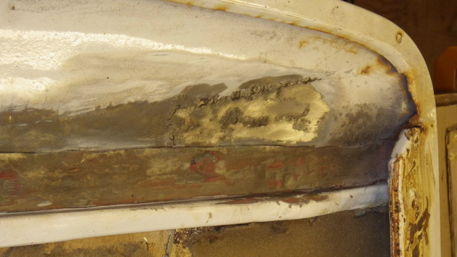

Bear, Thank you for your help.

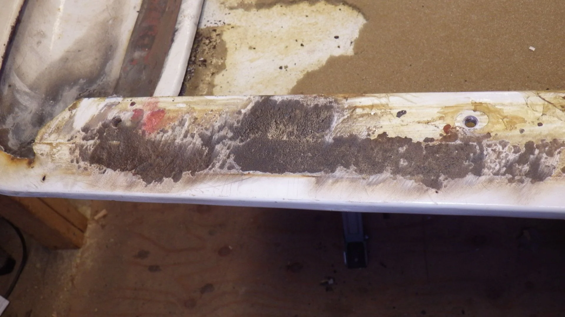

The part I unglued sat forward of the crossbar and has the two holes you speak of. It is molded to the shape of the windshield and there is a foam like weatherstripping that sits between. I have seen aftermarket roofs that have this part attached, possibly spot welded, about an inch forward of the cross bar, mine was glued right up against it. You can get a better look at it in the opening post of this thread.

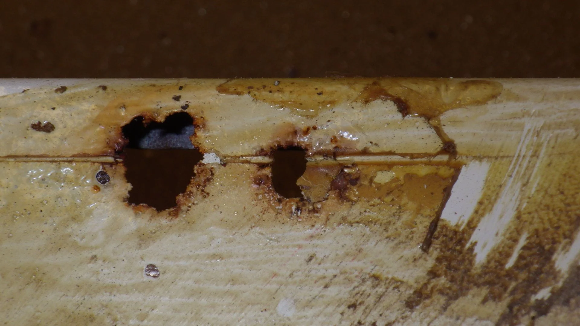

Light rust, on pics above, seems to be between the mounting rail and the outer roof top. especially in the middle of the front underside and corners. It's not clear if they were separate parts or if the rust entered from the weep holes and started, before they were sealed. I hesitate disturbing the putty on the corners of the outer roof for fear of what might not be there if I were to open it up. This has been worked on before as there are rot holes that were left and painted over along the mounting rail sides and rear corners, on the inside.

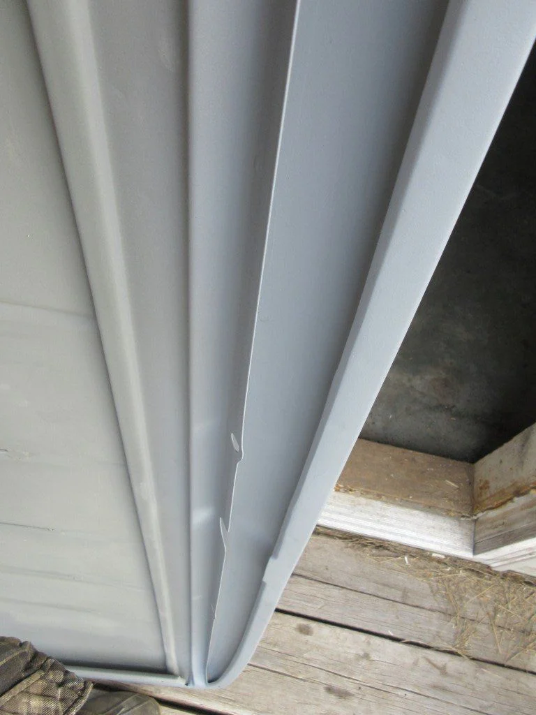

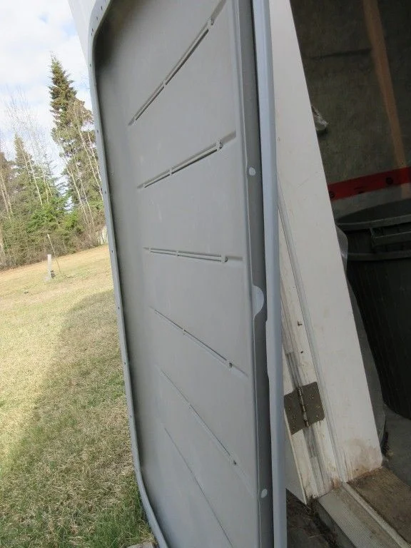

Snapped a few shots of the roof for a 1978 if that helps.
Thank you, it does help.
Nice and clean.
Mine doesn't have the ridge supports or the flattened tab in the middle of the front lip but the windshield bracket is the same and now the welds on mine make more sense.
Is that factory metal of aftermarket aluminum?
Nice and clean.
Factory metal (with some rust repairs and added round stock in the ribs to stiffen it up a little)
