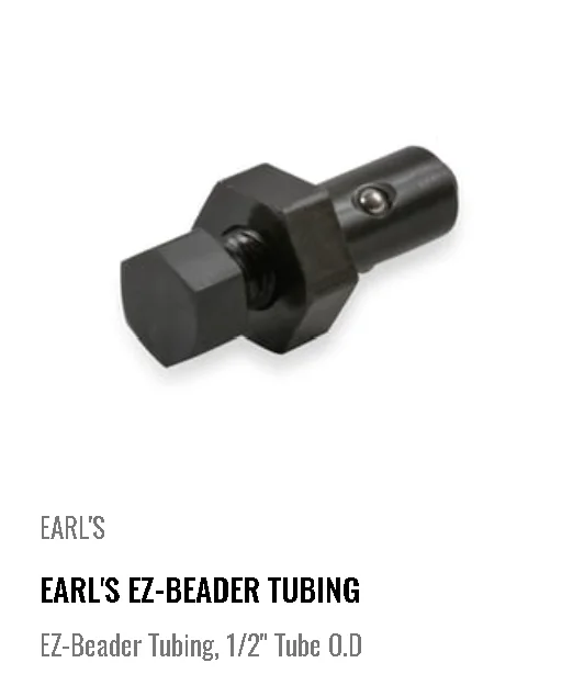

well if I choose to AN hose I'm going to need a 37 deg flare tool and hose something like .
and if I choose rubber or silicone I'm going to need good clamps hose and a beading tool such as
