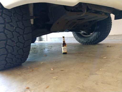

Ever thought of doing the "sensor lift"?
Nada. I've put it through the ringer including towing 14,000 lbs of rig, chasing Raptors down desert washes, technical trails, and most important to me, excellent handling dynamics on road. It's for the latter reason that I don't want to give up any on-road traction and handling that I opt for wider AT tires. AT tires do give up traction to HT type tires with their tread configuration and compound.
Same reason I did not sensor lift. It's already a bit over 1" taller with the 33" tire lift. With AHC, outside of wanting to look taller all the time, IMO there's no real functional reason to sensor lift. As there's always 3" of lift on demand when really wanting to traverse obstacles anyways. By keeping the suspension at its stock height, good dynamic handling traits and some better fuel efficiency is maintained without the compromises of a static lift.
I guess if it ain't broke...
The 470 has a decent amount of clearance, so I'll probably just stick to that for trickier terrain.
