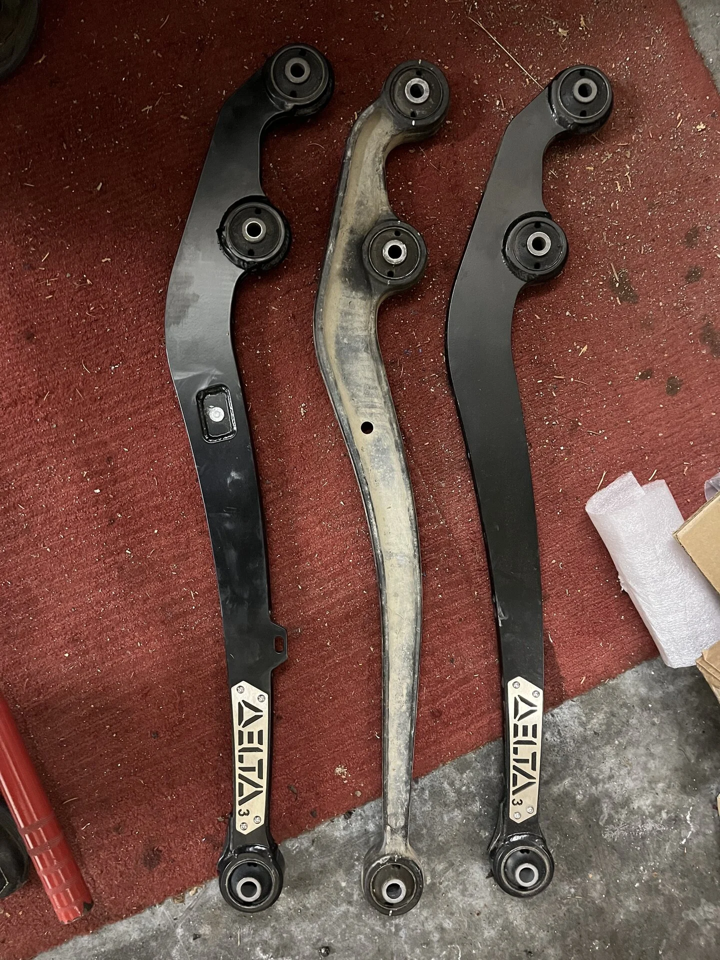

I am an hour north of you in Mount Vernon and just put brand new OEM bushings in my clean not abused arms from a 1996. Might be an option. I just went through ordering bushings and paying a machinist to put them in but ordered Delta arms. Wasted a bit of time and money, but looking to sell them to someone local. Reach out if you’re interested.
Thank you for the reply! I actually need the caster correction bushings to accommodate my lift kit. Those delta arms look sweet. GLWS
