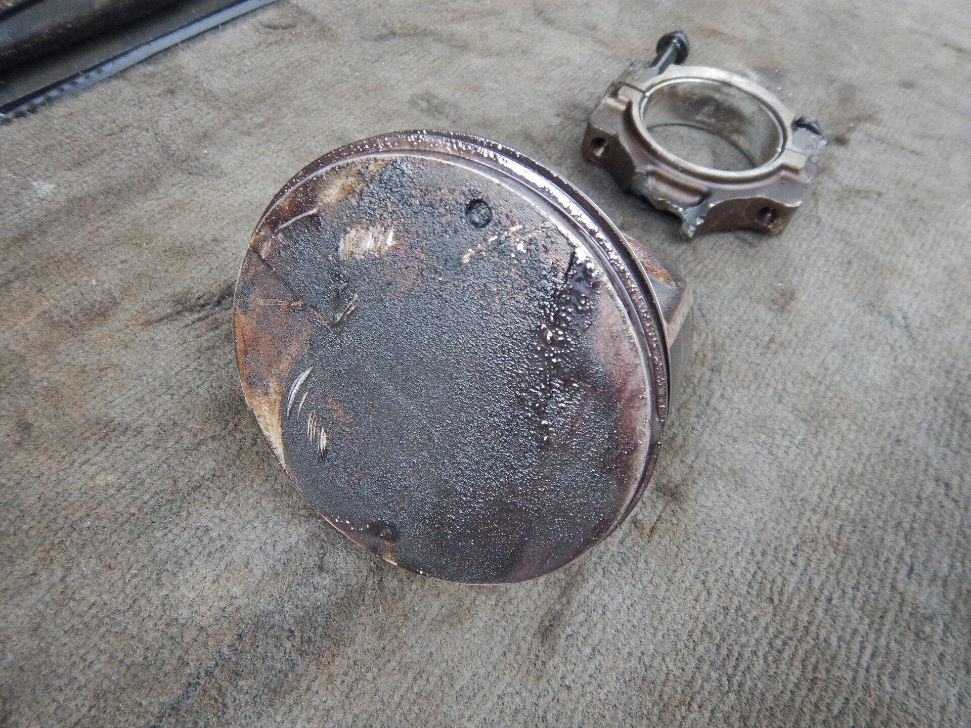

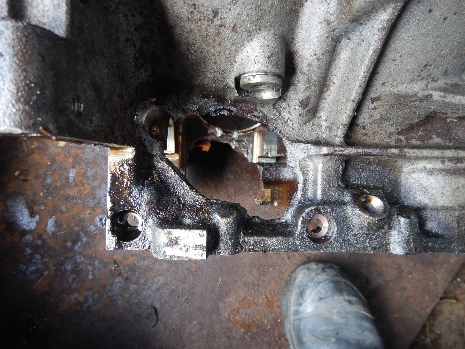

I took the truck for a thrash around the paddock after work today, and found the first new casualty from the fire (apart from the melted washer bottle hose) The water temp gauge suddenly jumped from operating temp to zero, the sender was a bit melted and only just now fell off. That was the 3rd temp sender Ive bought for this truck . The first one i broke when i forgot to disconnect it when i was pulling out the blown up motor, so i replaced it and broke the new one off on the shock tower, while i was putting the new motor in, and now i melted the 3rd one with fire. haha . now that im whingeing about problems Ive had, the original brass adapter for the temp sender i got with the LS conversion kit, broke off in the block before id even driven it. So i had to muck around getting the broken bit out of the block , then spend almost half a day making a new adapter. 👍 The joys of building your own vehicle.
