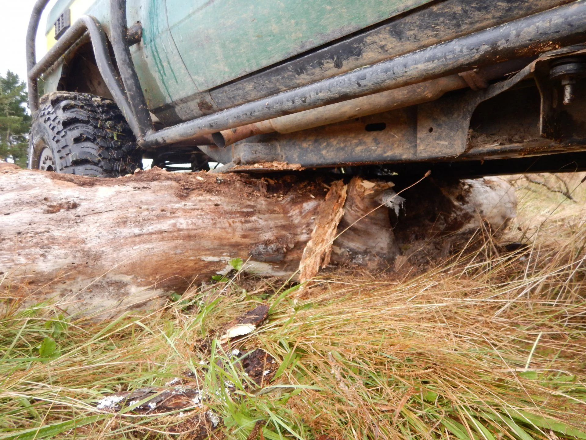

This is where mounting the gearbox high up above the chassis rails comes in handy. it means you can drive over logs as carelessly as you like and you dont have to worry about smashing the transfer case to bits

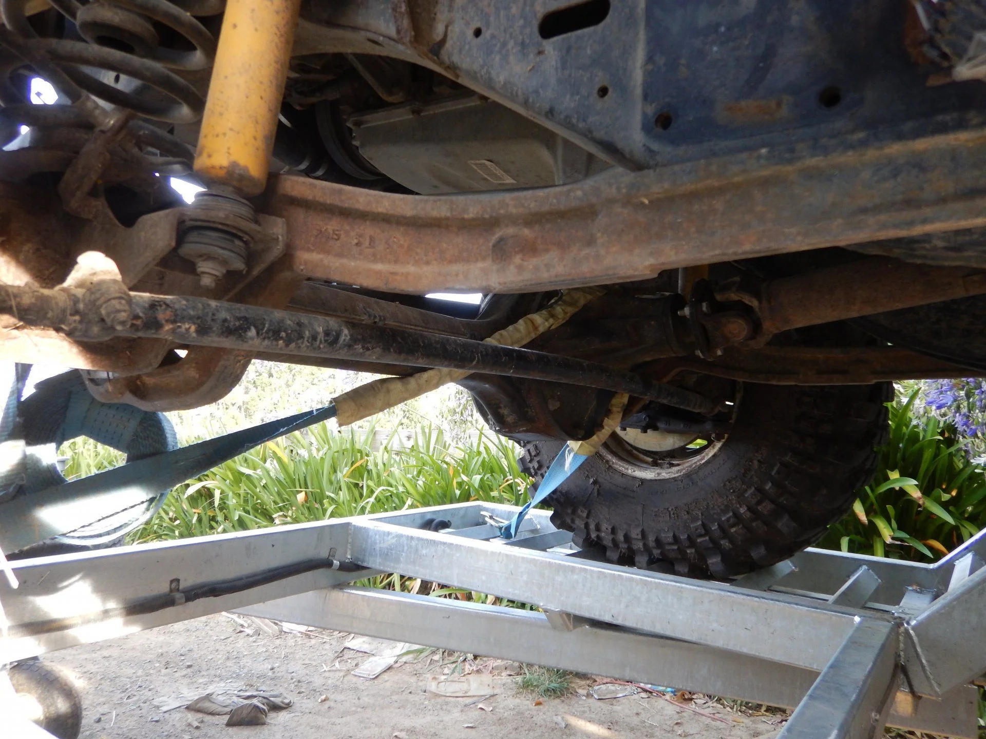

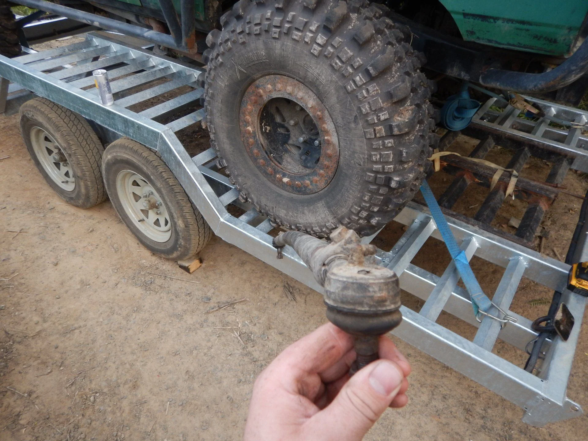

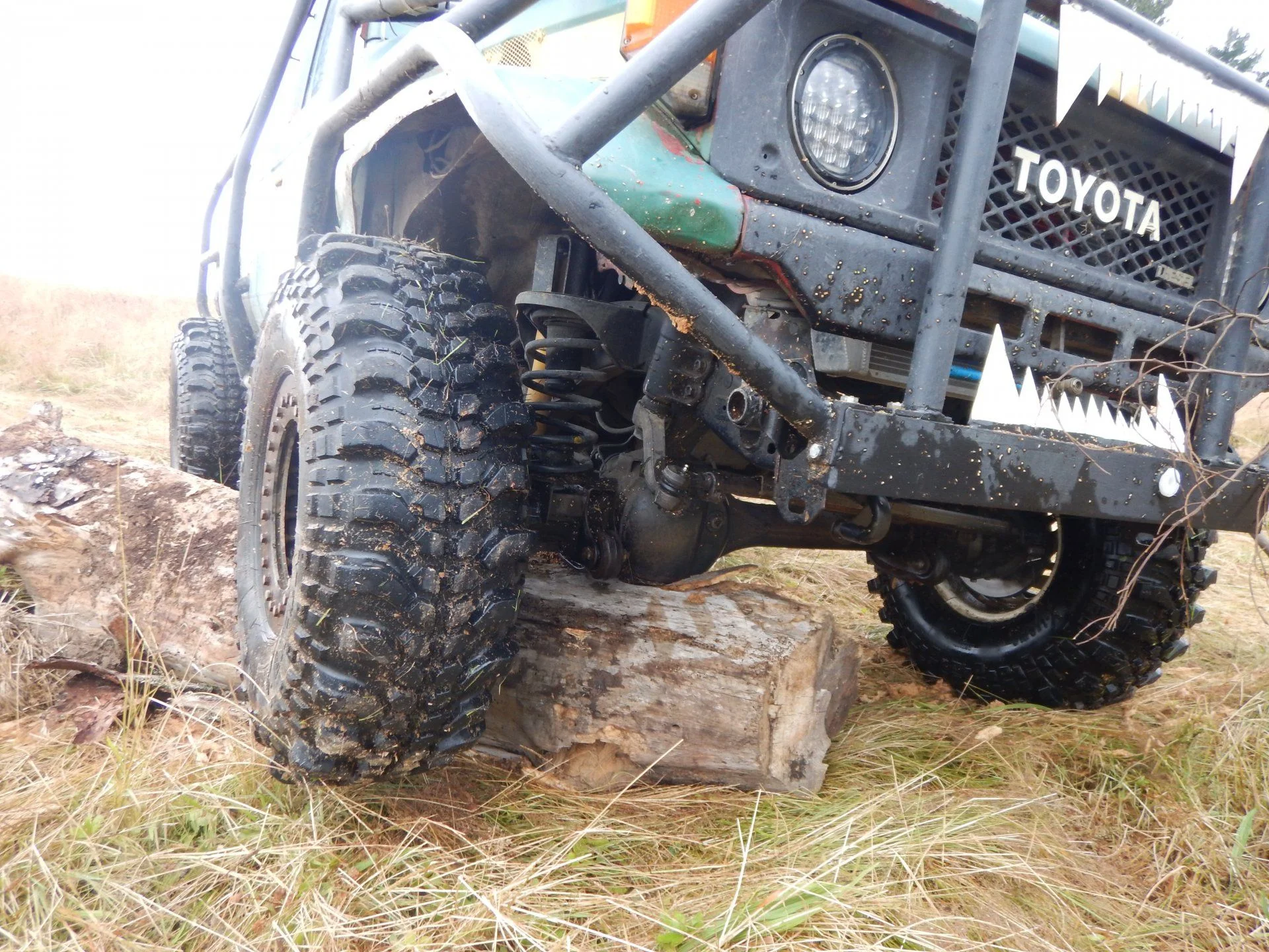

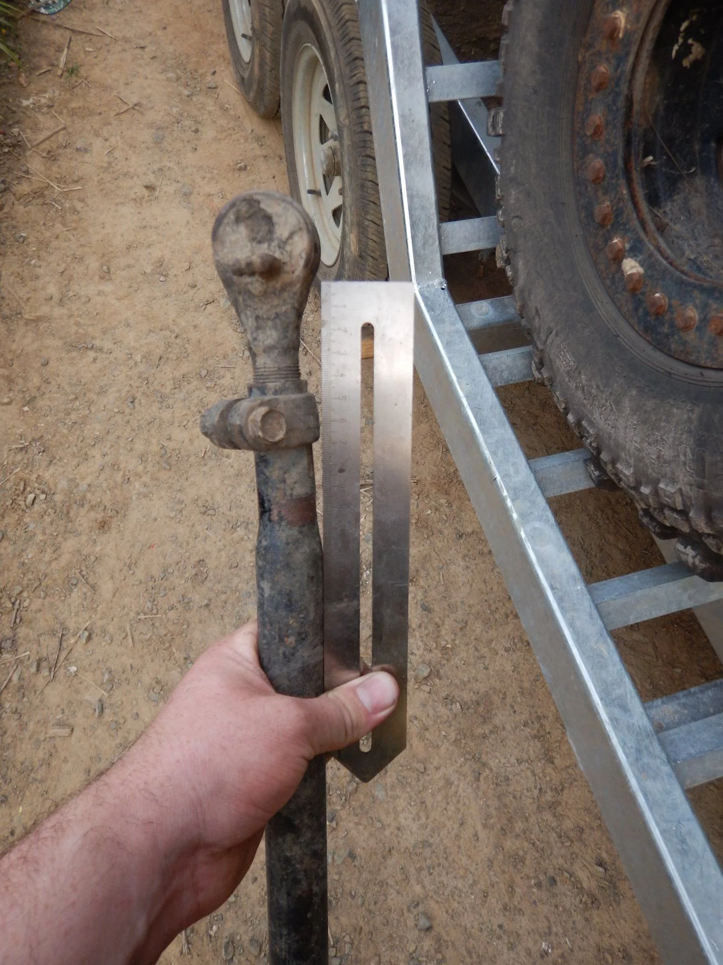

The next problem, my standard Nissan steering arms aren't up to it.
I bent it the other way too.
So i gave them a straighten and welded a bit of Corten angle to both of them, well see how long that lasts
Cheers

A bit of angle is sometimes all it takes - worked good for years on my old Suzuki.
That link has survived ok so far on mine, probably should beef it up one day though. For the front drag link I used schedule 80 pipe, machined some bar to the required ID sizes & got the local hydraulic hose guys to swage the pipe ends down on to that, then cut the threads for the std rod ends.
The next step is to go to solid bar + GU Patrol rod ends. The GU ends have a female thread so you can just turn a thread on a bit of bar & fit them up, I forget the size though, 30mm maybe.

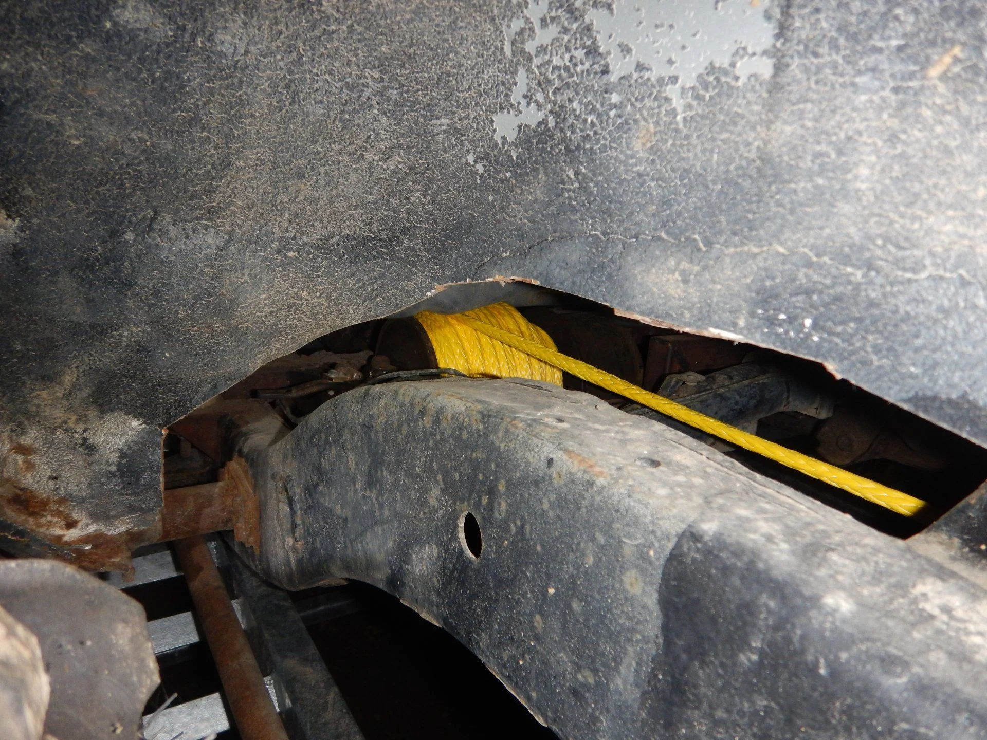

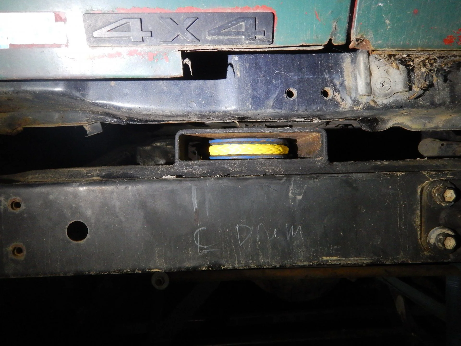

I put the winch rope on today, it seems to spool in and out nicely, it doesn't snarl up on anything. and it rolls on to the drum nicely. I still haven't worked out the free spool, so i have to feed it out in gear. its not too much slower.
I still need to load it up and see if every thing still works properly.
hopefully it will take up less space on the drum when it spooled in with a bit of load on it

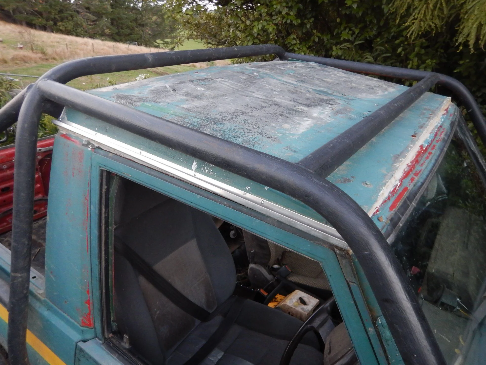

I took it out for a good test run, while it was pissing it down with rain, and got soaking wet because all the water runs off the roof, under the door seals and on to the driver and passenger. So i folded up some roof gutters and riveted them on.

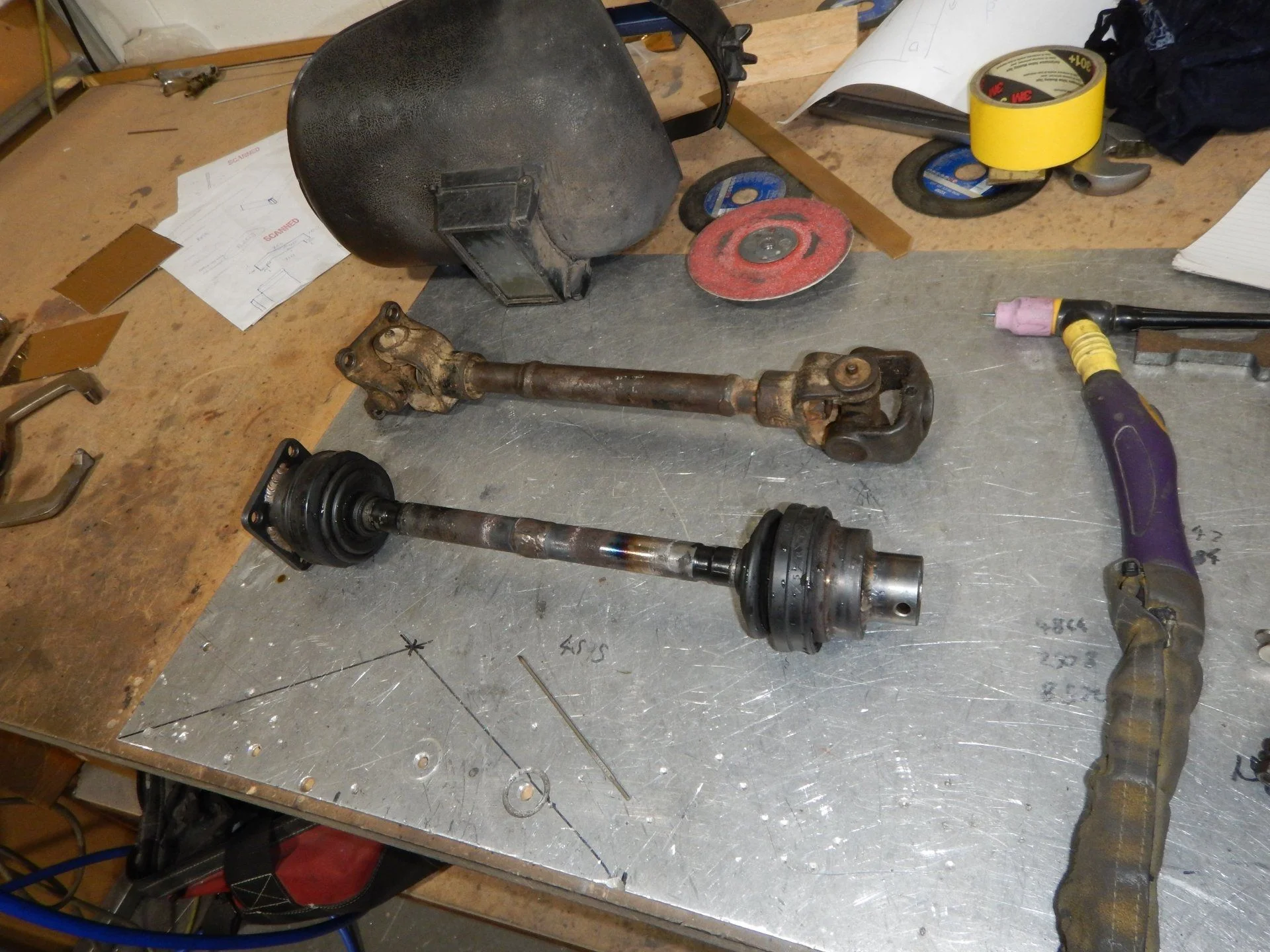

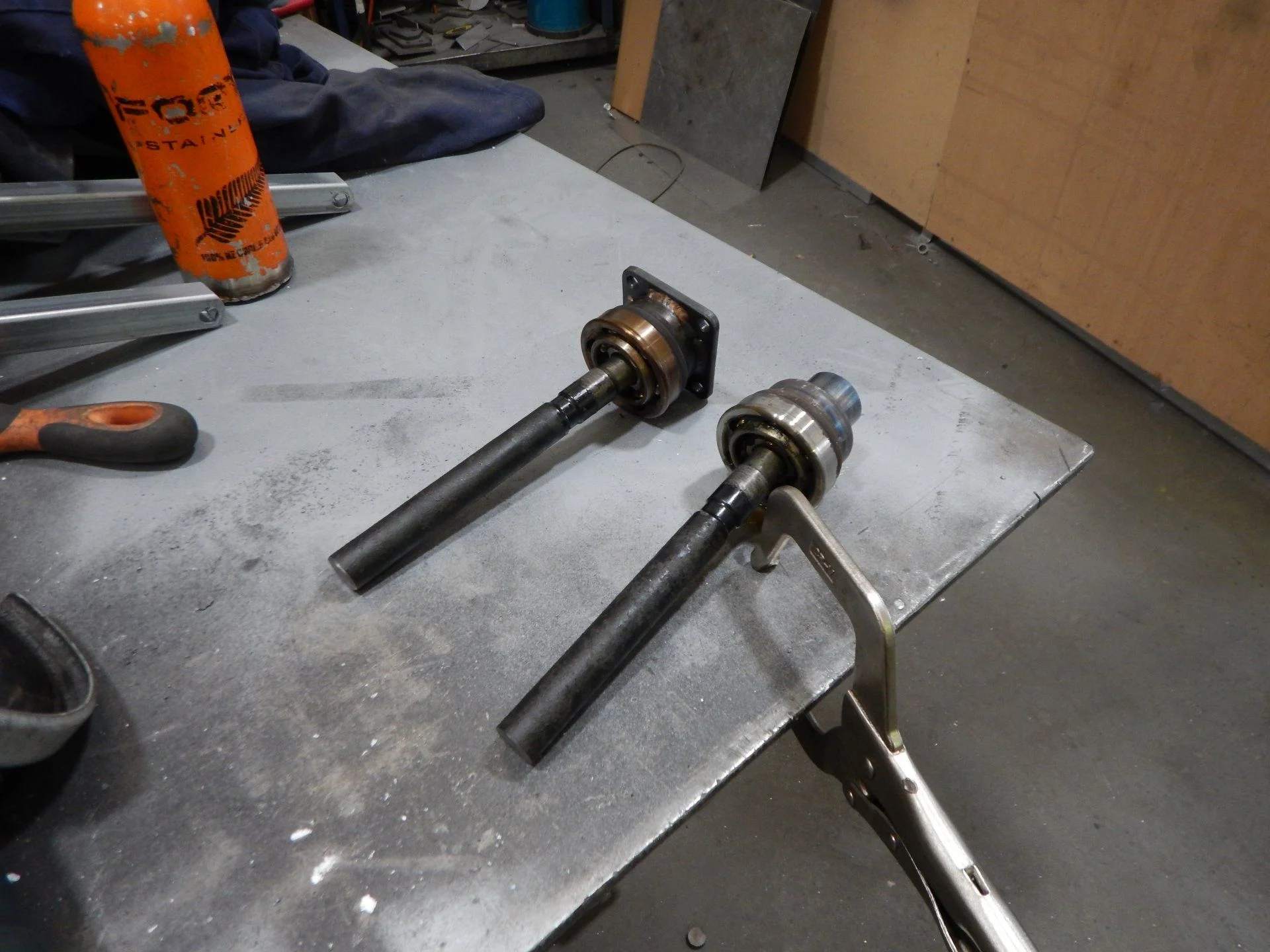

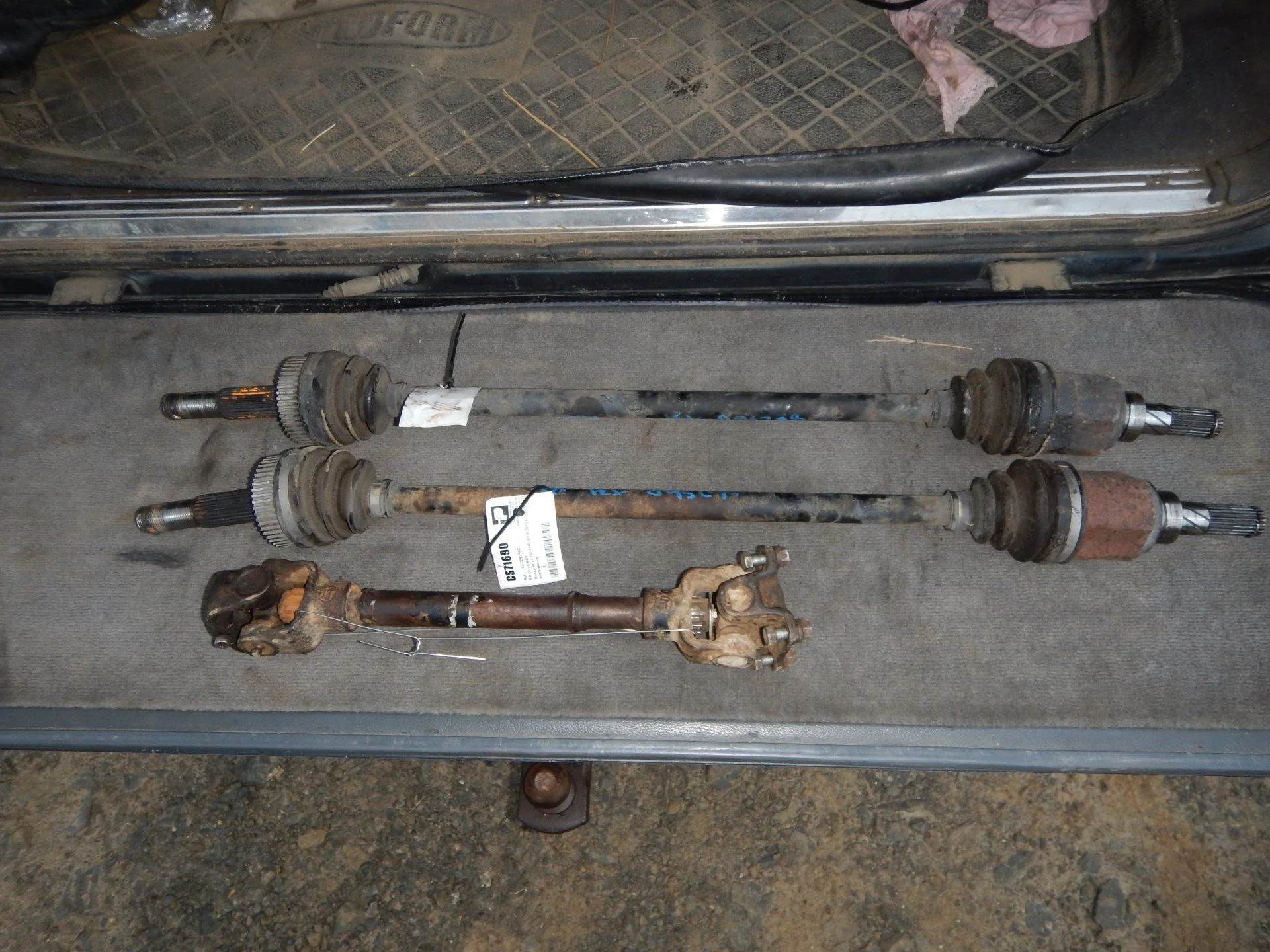

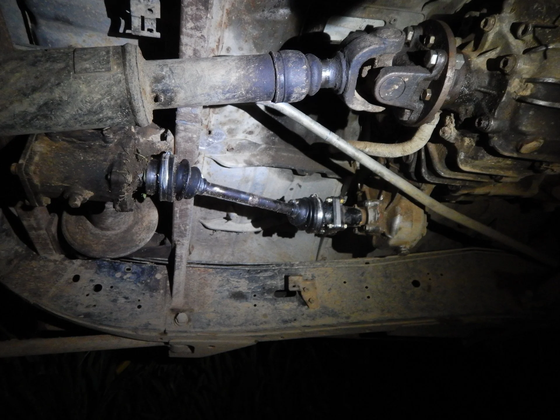

The winch driveshaft knocks like f**k so i made a replacement.
The smallest CVs i could find are from the rear driveshafts of a Nissan Xtrail
The axle shaft from the xtrail has one fixed CV and one with a slip joint. The one with the slip joint cant handle as much of an angle as the fixed one. so i bought 2, and used the 2 fixed CVs.
I welded a flange to one, and a bush to the other. Its not ideal welding to axle steel, but i think it will be alright. I used MG600 wire and theres not going to be that much stress on the welds.
The hardest part of welding the shafts together was keeping the middle hot, so the weld was strong and the ends cold so it didn't f**k the rubber boots
Ill keep the old one in the truck somewhere just in case it f**ks out
