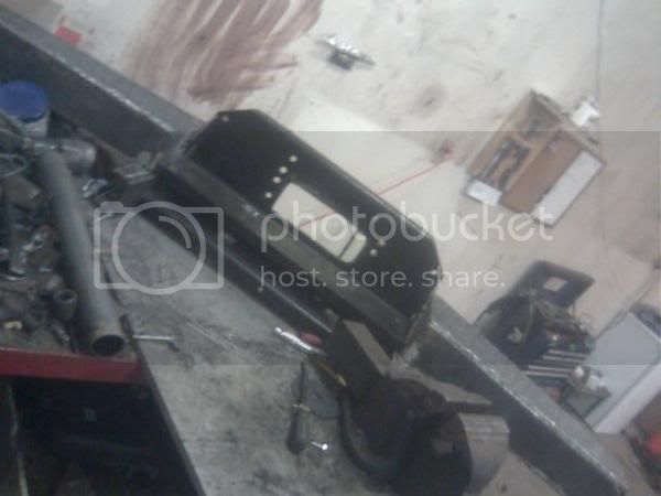

bumper wings

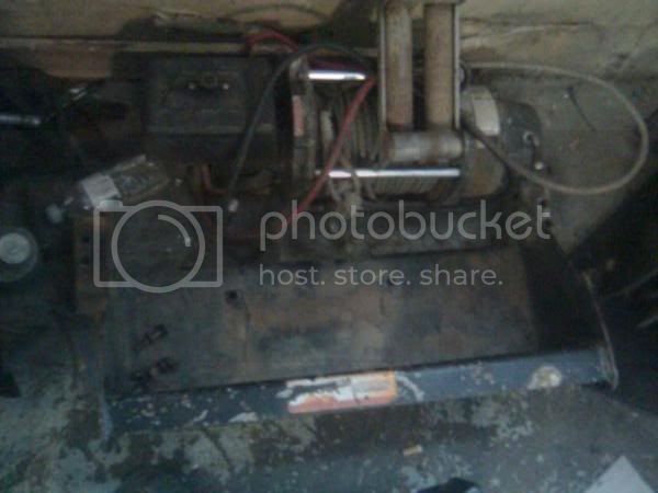

old mount that i cut the sides and front off so i can welded new winch mount onto

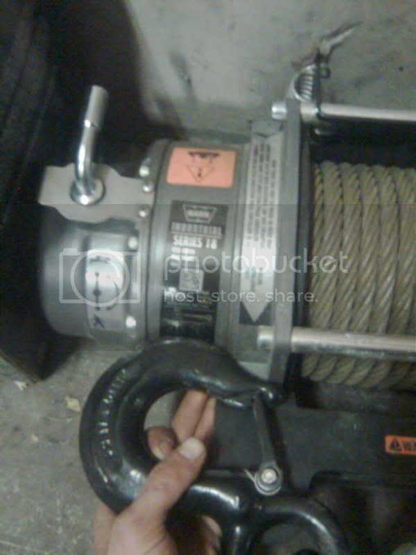

warn 18k (badass)

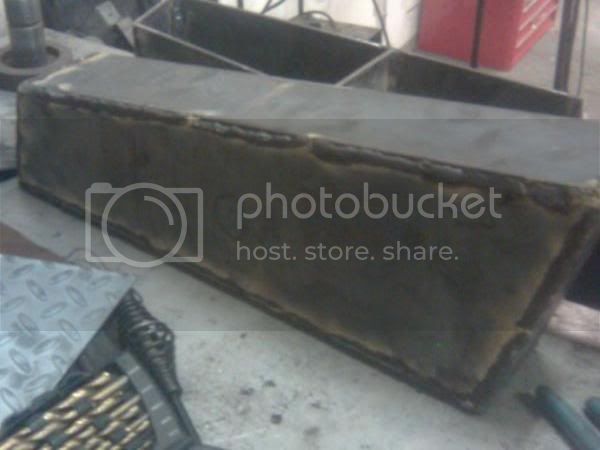

progress, sorry for the sgitty camera phone pics
por15 wet
dry
i put a second coat on before leaving the shop; on the bumper, and my hands :s
tomorrow i paint it ultra flat black and mount it along with the winch :D

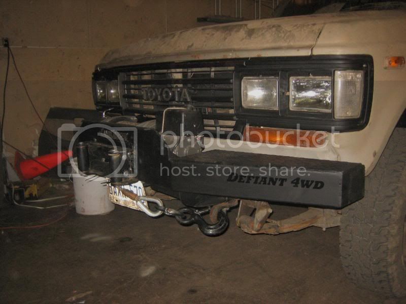

its on
i still got to figure out how to hook it up, then see if it work :P
ill get some better shots, ill take em outside,

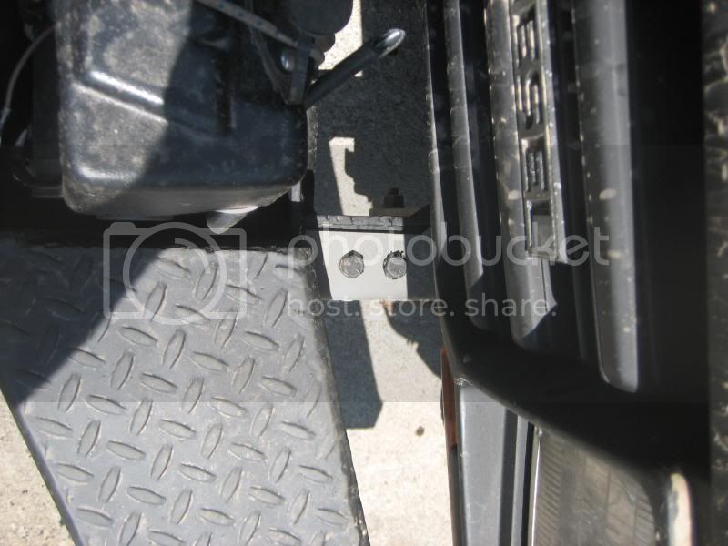

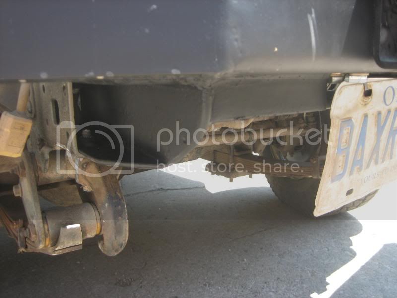

this bumper is a bolt on affair; i really like that for easy removal if ever necessary
ill get some pics from under as well

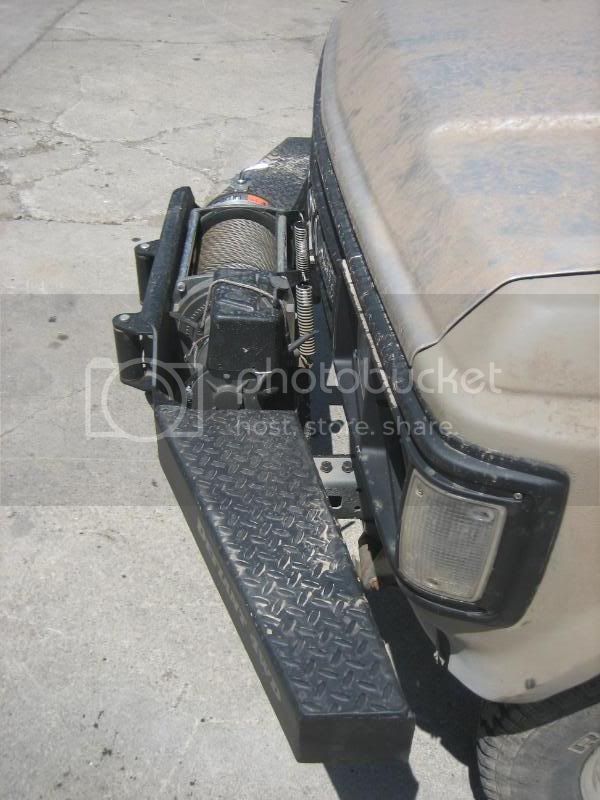

better lighting:
top bolts
hooks need to get welded on
side
far
