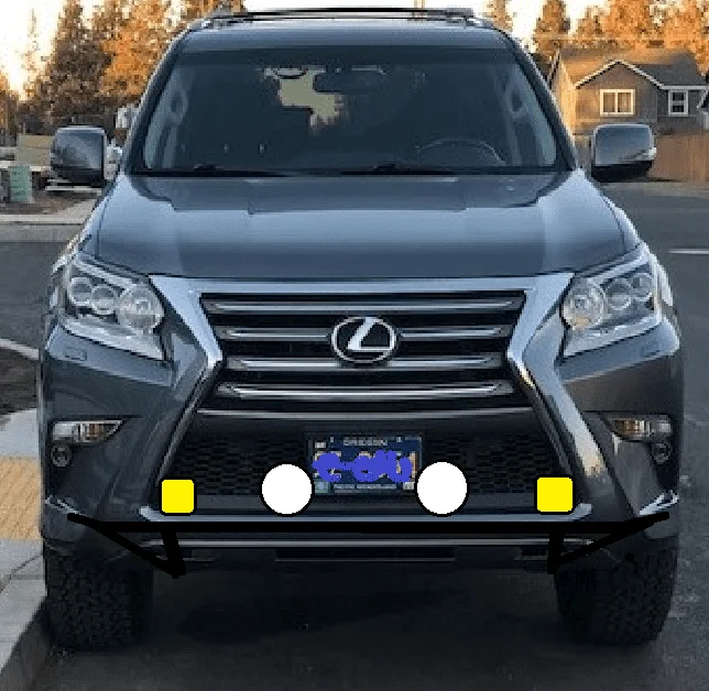

I am finally going to tackle having a bumper bar/light bar built for my 460, since there are no decent commercially available options. I anticipate some will say it's a "damage multiplier" and that's ok, but hopefully we can agree to not agree on that one. I had a basic Westin bull bar on my 470...it was so so, but I did like the ability to mount the lights and the look.
With this one, I hope for it to stand out a little less or look more like it belongs. I need it to hold some SS3 fogs and some off road lights (I have some Aux Beams for now but hoping for some LP4s or LP6s) and also be a place to tie down straps to the fronts of my Kayaks (and of course Christmas trees). Maybe it can offer a little front end protection from the occasional shopping cart, very small squirrels , tumbleweeds or small shrubberies. The other thing I am going to do is mount the bar to two of the bolt on recovery points from Kyle at Treaty Oak Off-road. So the bar can be unbolted if need be. It will be smaller diameter (approx 1.5"), so a little less bulky looking.
The shape I am hoping for is to follow the angles/lines on the lower hourglass grill and top of the hoop to cross over at the mid section of the grill. Then some extensions out to the corners, staying clear of the sensors as much as possible. and it probably needs to be wide enough at the bottom so it does not impede using the recovery points with a strap. And last, on color, I'm thinking anywhere from flat black to a version of gray to blend in with the rig color.

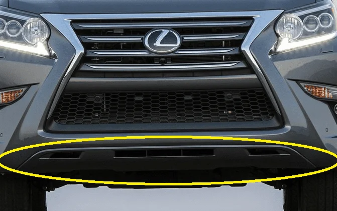

One quick question I can think of now, is how to best cut that lower air dam or do I remove it?
I appreciate hearing feedback on the LP4 vs LP6 vs other options for a good all purpose, trail, "see deer" light and any feedback on powder coat vs bed liner paint vs actual commercial bed liner might be worth discussing
Wish me luck, it might look ridiculous, but I will post pictures anyway. Always appreciate everyone's comments, encouragement or ideas. These pics will get it started.

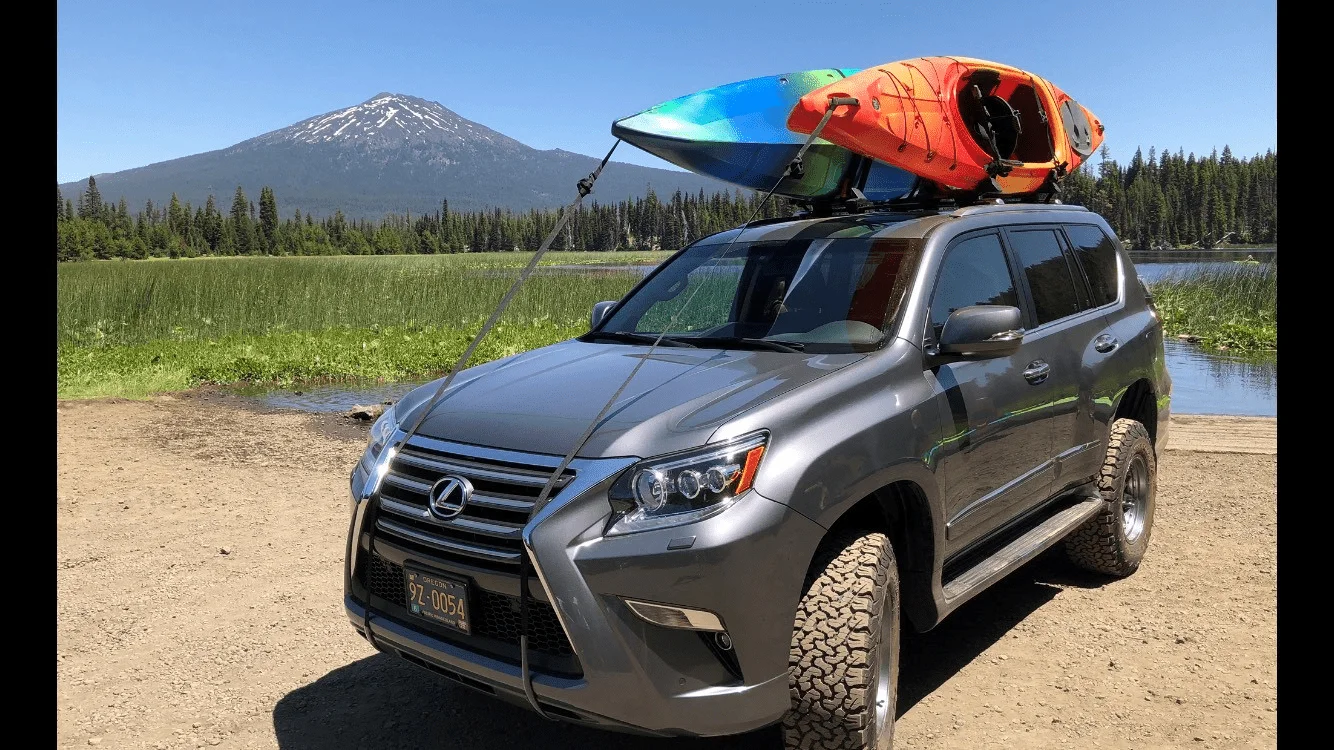

Pic 1 is with the kayaks to show ties downs

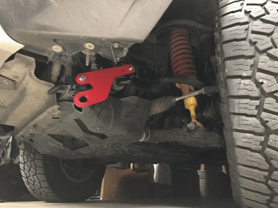

Pic 2 is the recovery point design

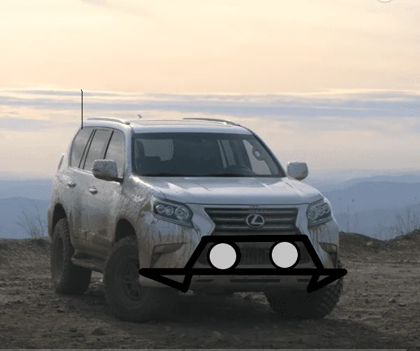

Pic 3 is a poor attempt at a sketch but somewhat along the lines of design (using the lifestyle overland rig as my model, I really like the look of theirs)
Pic 4 is the lower air dam that I might remove or cut slot into for the bar

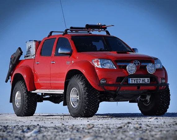

Thanks, I do like that victory blitz and also the CBI unit...I was just trying to be honest with myself this time and didn't feel I needed a heavy front bumper (and this will be removeable if I totally mess up). I love some of the Arctic truck bars and that is what got me wanting to do this. I have an appointment with the fab shop tomorrow morning so I guess I will soon see what craziness we can dream up with bent tubing.
I see, I had to google the artic truck bars and was immediately drawn to this. I like the angles and supports, but maybe have them done in the rough 'head-on' profile of the Victory Blitz bumper (flat/horizontal on the edges and follow the grill line in the center, to mid-grill height or a little lower). A main bottom bar that extends past the front of the bumper but then support arms that cross through the lower grill to tie back into the main support arms.

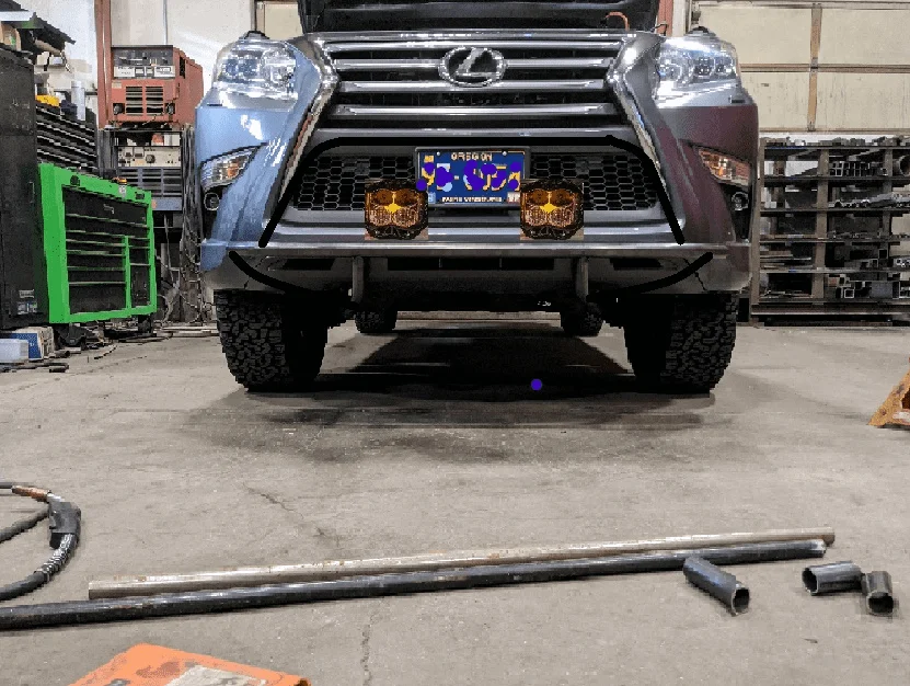

Today's progress... The recovery points are mounted on the frame and we are attaching the brush bar to those (they will be bolted onto the recovery points so the bar can be removed to repaint, etc as needed). The bar is tacked into position and still making some bends and adjustments. It actually tucks up under pretty well and the riser bars fit into the two indentations in the air dam.
Then the next steps are to put in the side support tubes (slightly smaller tubes) as drawn in. We are going to fab the upper hoop, but it looks like the way it's designed it might look a little large, so we are looking at ways to de-emphasize it somehow and we are not going to weld it on until the last step. Might just tack it on and stare at it for a day or two before welding it on. It might even look ok without it. The lights are just LP4s cut and pasted for reference.
