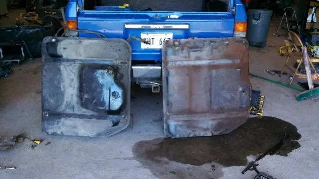

Well, got the old tank pulled

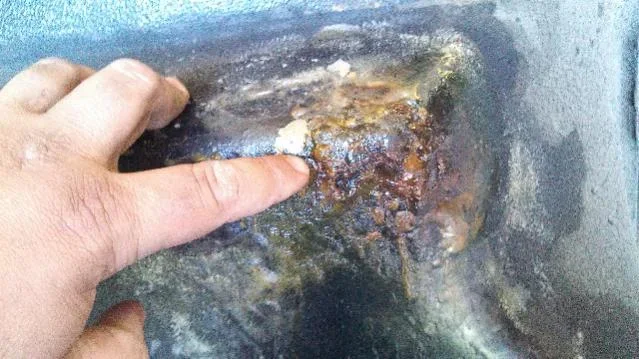

the Seal-All did its job for 2 weeks but I don't know how much longer it would have lasted. It had made like a gasoline blister, while I was man handling the tank it popped.

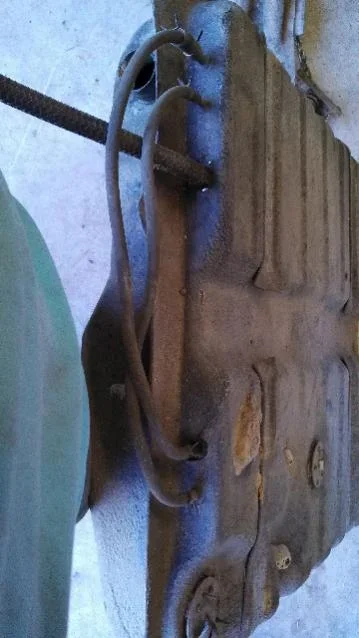

Also, check out then way the tank vents are routed :)
They vented the tank to itself. Lol

Good to see the progress bud, nasty looking spot on that old tank. I'd put a good epoxy paint job on it so you'll get years of worry free use out of it :)

I bought a few cans of 3M undercoating. going to pressure wash the tank, use some osphoon a few surface rust spots it has, then undercoat the whole tank. not 100% sure how I am going to run a vent on it looks like all the original stuff to pipe it to the charcoal canaster was removed. also I think I got mixed up on which of the hardlines are the fuel suction and which wa the return >.<

Ok I am not a happy camper. Started prepping the tank to close it up so I can pressure wash and paint it. The flange the fuel pickup and return screws to only has one screw hole with threads, one of the holes has a broken screw stuck in it, already fixed the cross threaded drain plug, and while i was getting ready to pressure wash it I found a hole rusted in the top of the tank.
Took those jokers a damn month to send me the first one. I wonder how long it will take them to get another one.
So now I have two Toyota paperweights in my shed. Until I get another new tank.
