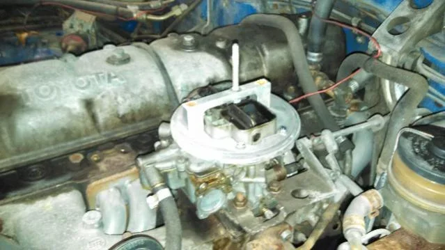

Almost titled this "BikerTrash's No S#!t Build" but I know we are supposed to be family friendly and all. While I was robbing parts of the 4runner i just kept looking at all jankey BS i did with that build. The example that i am gonna rat my self out on today is the air filter adaptor on the Webber.
Didn't take a picture of it on the 4runner ever but that's not important. I couldn't figure out how to remove it from the 4runner, there were no bolts. I had just siliconed it in place because I was to lazy to drive 3 miles to the hardware store.
Today though i an $1.32 poorer and it is mounted right.

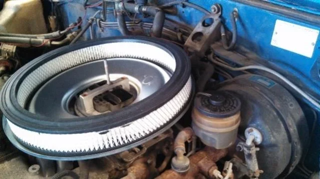

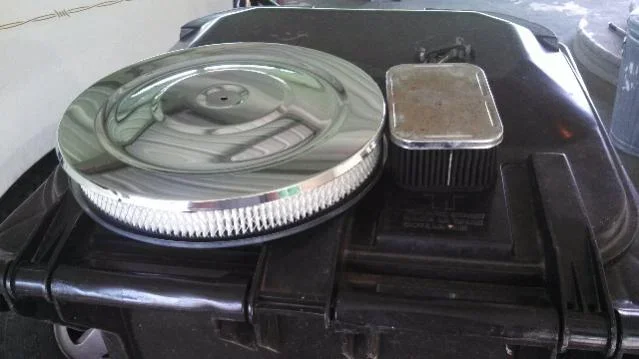

With the size of the engine I have read the rectangular filter that comes with the webbers is slightly restrictive so i bought a 14" open element filter.
Just look how pretty and how much more surface area. Bling bling!
Now check out how it doesn't fit :(

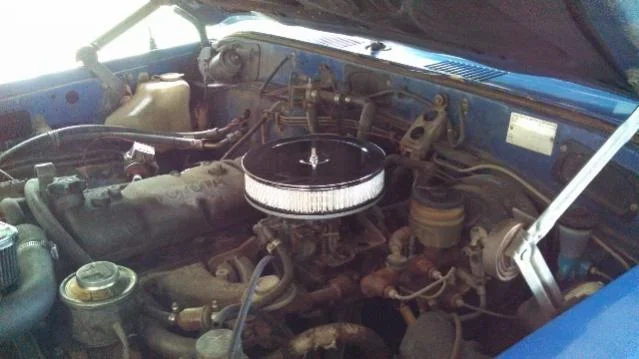

9 inch is better, no more interference with the brake fluid reservoir. When it is time to replace I will be changing to a wix filter about half an inch taller.
But anyway, if y'all see me do something stupid, just remind me to keep the s*** out of this build k?

Found a Haynes manual in a milk create in the back, looking at the diagram of the vac lines looks pretty nightmarish. Went outside to start comparing and teaching things and i found 2 problems so far, when the PO installed the headers he disconnected the EGR but left the bottom port wide open.
I don't have a clue weather it even still works or not but I am going to try and plug it, maybe try to find some block of plates and just eliminate it all together.
Second is that when the Webber was installed the vac lines for the advance on the distributor are just teed of and going to the same signal so i am getting no timing advance.
I had planned on leaving the emissions intact on this thing, but i guess with the Webber it would be a lost cause anyway. Gonna read up on desmogging a 2F the right way (if that is not a contradiction in terms ;) )

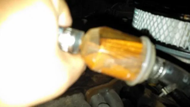

P.S. Check out the awesome stuff in this fuel filter! Apparently a 2F will run on just about anything that will burn i guess.

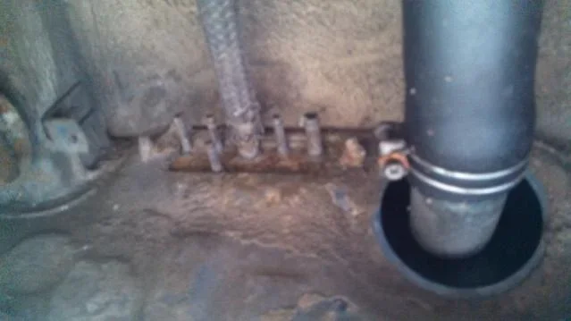

I have been reading the haynes manual and I have noticed something that may be a problem. On the side of the tank there are several vacuum ports that are just open, aparently they go to a "Fuel Vapor Separator" and then that goes to the charcoal canister to vent the tank. But like I said there are no lines going to it so I am wondering how the tank is actually getting vented now. Is the massive suction I have on the tank actually because the tank is not propperly vented and the reason that the JBweld patches failed because the tank flexed due to vacuum and as soon as the leaks allowed enough air in to equalize the pressure then the fuel leaks started again though the now cracked JB Weld. When i drop the tank going to have to check it out and posibly just run a new vacuum line directly to the canister.
These are the fittings I was talking about that I belive are supposed to be the tank vents leading to the vapor separator.
Josh, the 40's have a similar set up. I have the vent ports on the tank just capped and mine vents through a vented gas cap. The charcoal canister and the fuel separator were missing from the rig when I got it. I was going to put it back in but can't find a good reason to do it.
Problems I ran into with my 40's if you did away with the vent system and just capped it you would get the smell of gas faintly on the passenger side but it was worse with the hard top on so I vented it back to charcoal like factory on the 78 but on the 67 and 70 there is only one vent line off the tank and I ran it to a T on the firewall with the diff vent. I'd recommend at least one vent line or a good vent cap like Mike suggested. I definitely would not leave them open :)
