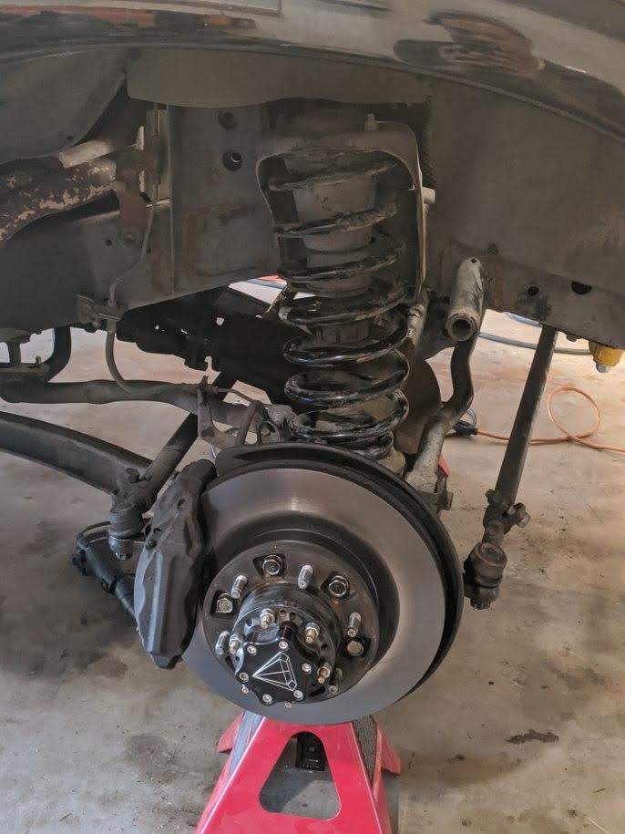

-Knuckles rebuilt, Front Range drive flanges, Hub and Steering studs
-OME 2.5" lift with Delta Vehicle Systems Caster Correction arms

How was it installing the Delta VS arms? Looks like a straight forward easy install? Have any issues?
So it is pretty straight forward, that being said I kinda screwed the pooch and the axle rolled forward which screwed me over. Had to winch it back but once one side was in it was cake. Definitely glad I bought them, the truck rides like stock if not better.
How would I prevent the axle rolling when I install the Delta arms?
Following the instructions better than I did. It tells you to jack under the frame and under the axle to unload some weight off the arms, I only did the axle side. Pretty sure that's what happened. Maybe have the parking brake on. And definitely only do one side at a time.
