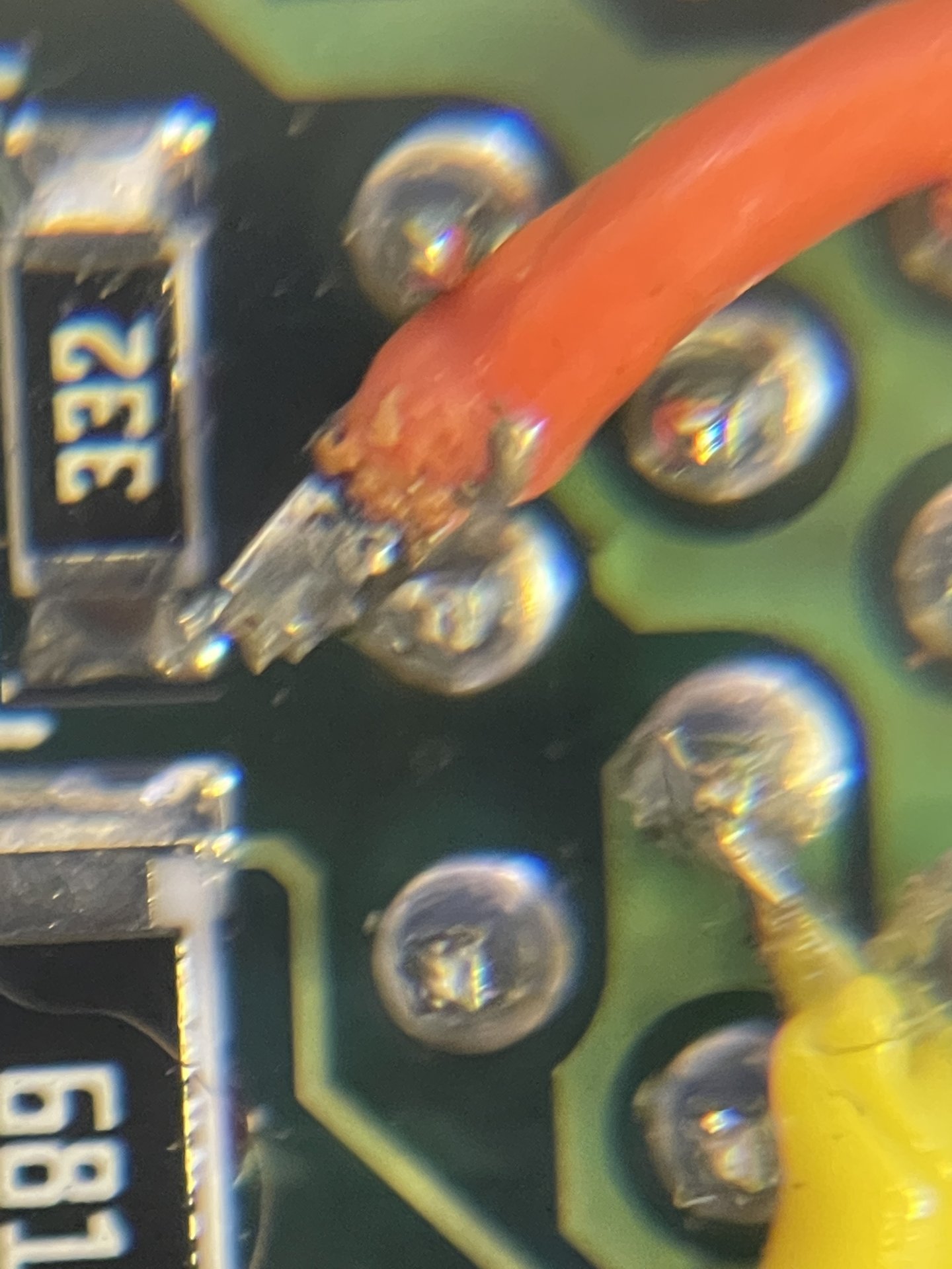

After two years or so on my 2uz swap I was having some issues with the thing starting reliably. I had convinced myself it was MAF harness related. Although there were mostly zero fault codes. This morning I got a p2799 - ecu immobilizer fault. I immediately dig into my Russian immobilizer hack in the ecu. I found a cracked solder joint. I reflowed it and strain relieved the wiring. Put it back in and fired right up.

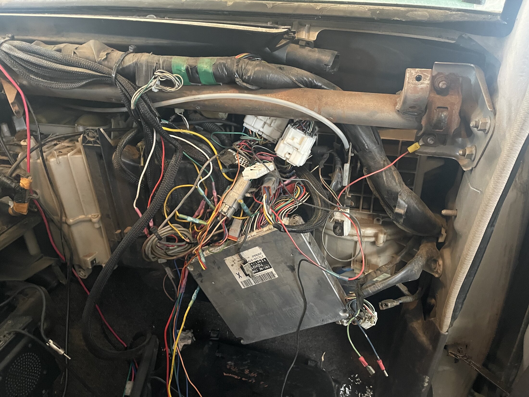

I’ve been doing a bit of pretty high end wiring lately at work. So I’ve decided to rip the wiring bandaid off on the cruiser while debugging the tcase issues.
The current list of tasks for wiring:
  1. The wire I used is already cracking in the insulation, so I’ll be replacing that with some nicer stuff.
  2. Redo the wire loom where I used chinese finger trap style loom.
  3. A lot of the wiring I did was crimp splicing to pig tails I got from the junk yard. I’m hoping to find the pins that I did that on and do a better job terminating those wires (fewer but crimps). And use Raychems where appropriate.
  4. Debug and repair tcase electronics operation
  5. Hook up reverse light to a250f reverse switch
  6. Evap system controls
  7. Maybe cruise control if I can get the VSS sensor wired in
I’ve been getting a bit further into the wiring. My goal now is to clean up the interface between the new and old wiring so that there is a single connector I can use to disconnect the engine from the chassis harness. Originally it was a mess of random connectors and direct wire interconnect.
Here are a couple photos of the status of the wiring.

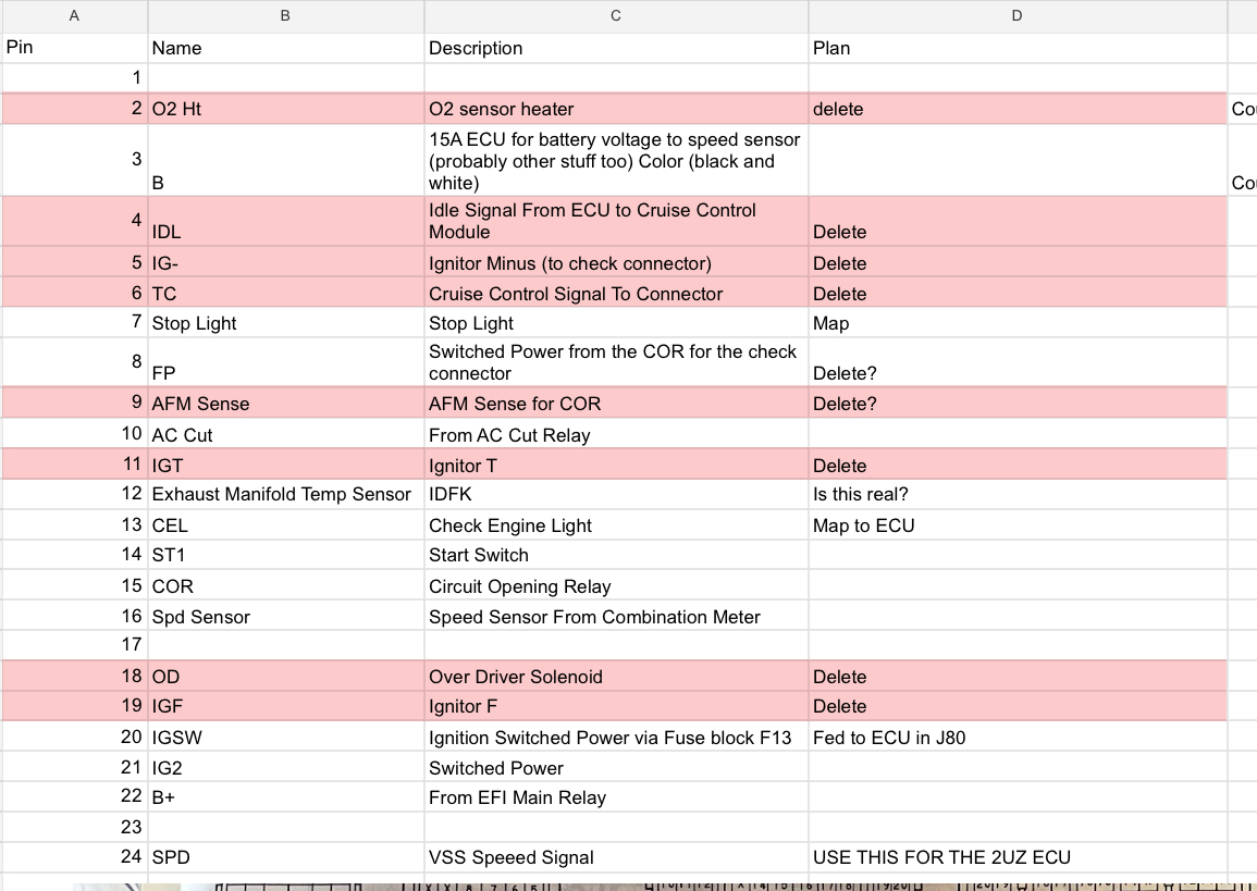

Here are a couple tables of the pinouts for ih2 and ih1 in the 91 fj80
And a provisional interface mapping (still need to figure out the transmission gear lights for the combination meter)
