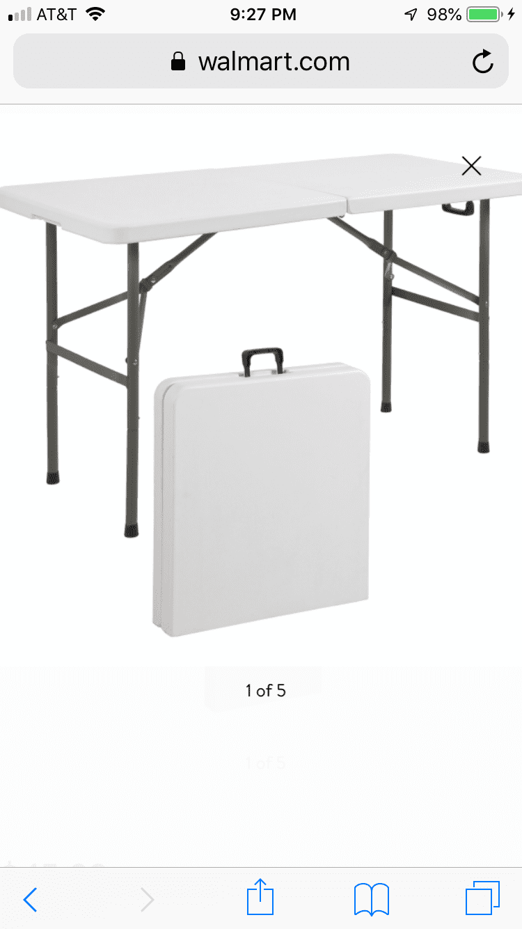

i just carry a folding plastic-topped 2’x4’ table, with folding telescoping legs... like this
It fits under my plywood sleep platform.
I’ve used it for cooking and eating, as well as as a workbench, for mechanical breakdowns... just add bleach, water and a scrubbrush and voila! It’s a culinary appliance again. ;)
I realize you said you are building an alum table. Alum will be sturdier, but I doubt it will lighter, or more functional... or as cheap.
Looks like these can be had for ~$45... IIRC I paid ~$25 several years ago.

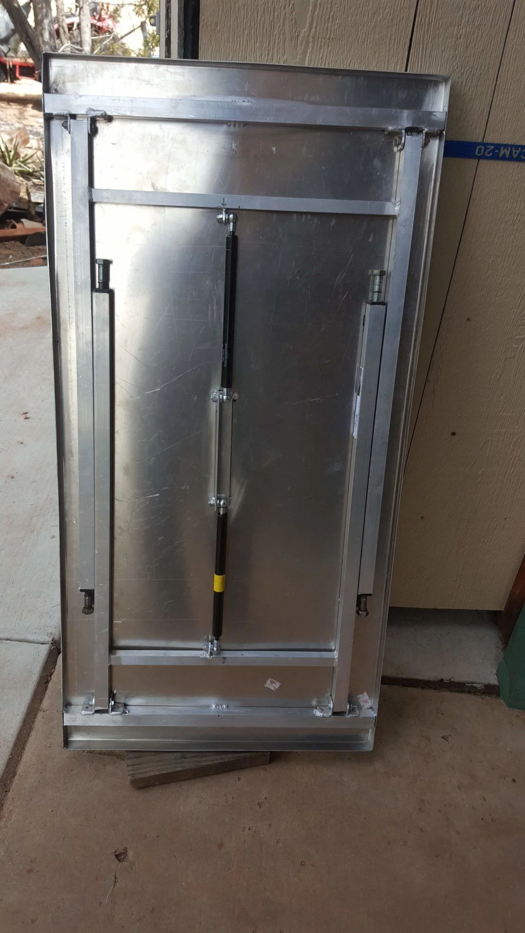

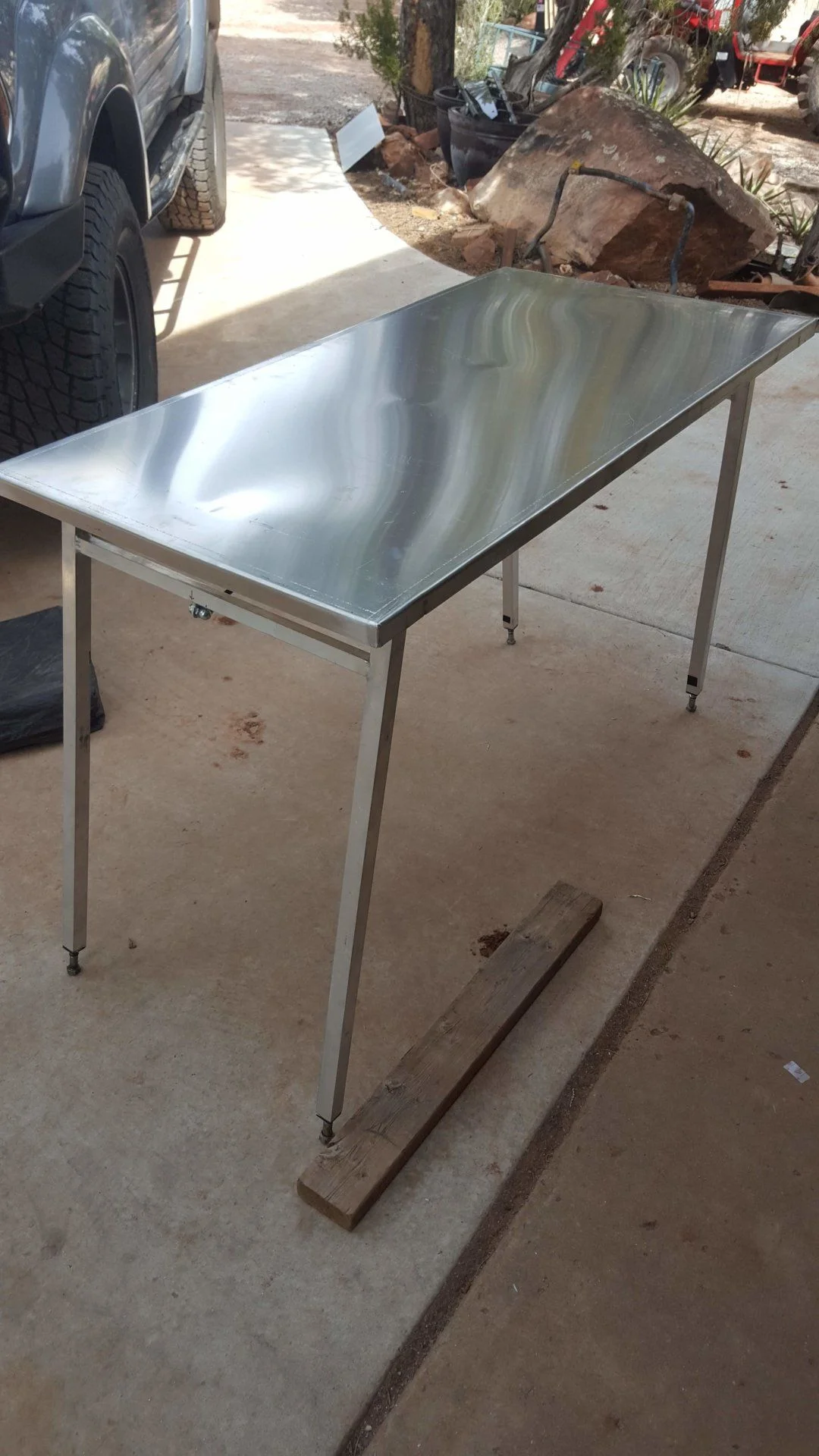

Alright, here she is, clocking in at a whopping 12 lbs. Nothing fancy but keeping with the KISS rule that @spressomon used, adjustable height achieved by 1/2"-13 bolts. After using it, I learned that I still need to run a gusset to the legs, like spresso did on his. By no means is she perfect but this was my first attempt and learned a few things. A HUGE thanks to @thegadgetguy for his TIG time on a nice Sat. This project wouldn't have been made possible w/o his TIG skills.
I rested my 60lbs Engel on it while packing for the camping trip and it did quite well. Due to the material being 0.0625", it's rather soft and dentable as you can imagine. One thought is to line the entire top with a super thin food grade cutting board material. Barring that, just a large cutting board glued to the surface on one end that can be wiped clean before usage.
Sadly, we didn't take it to the AZBDR trail over the weekend due to the storage solution not complete on time.
FWIW, I do use my stove(s) atop my table now and then. The down heat factor, especially with the Camp Chef Ranger II stove, can be an issue...check the melting point of the plastic you are thinking about using as a laminate top...as applicable :).
You make a good point Dan and perhaps I should just have a large, thin cutting board on one end only. This will allow us to put down hot pans/pots directly on the table nary a worry. Thanks.
