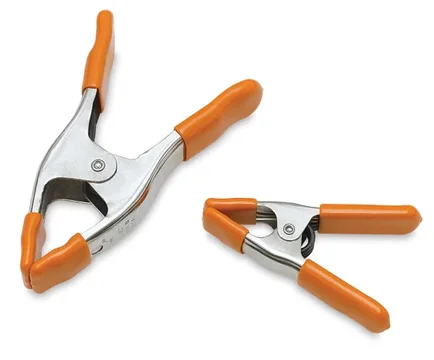

Once the 4 tubes are quickly placed on the roof rack, the sun tarp is simply clamped to it with spring loaded A-clamps that fit snug around a 1/2" pipe. These can be found at Home Depot too.
It only takes me a couple minutes to rig up the shade.
I bring a lot of these clamps so I can clamp the tarps in different ways depending on what I am doing. They hold the tarp very securely. Typically, only 3 per tube is needed.
Clamps are great because you can always reposition/remove/set up the tarps quickly and easily.
