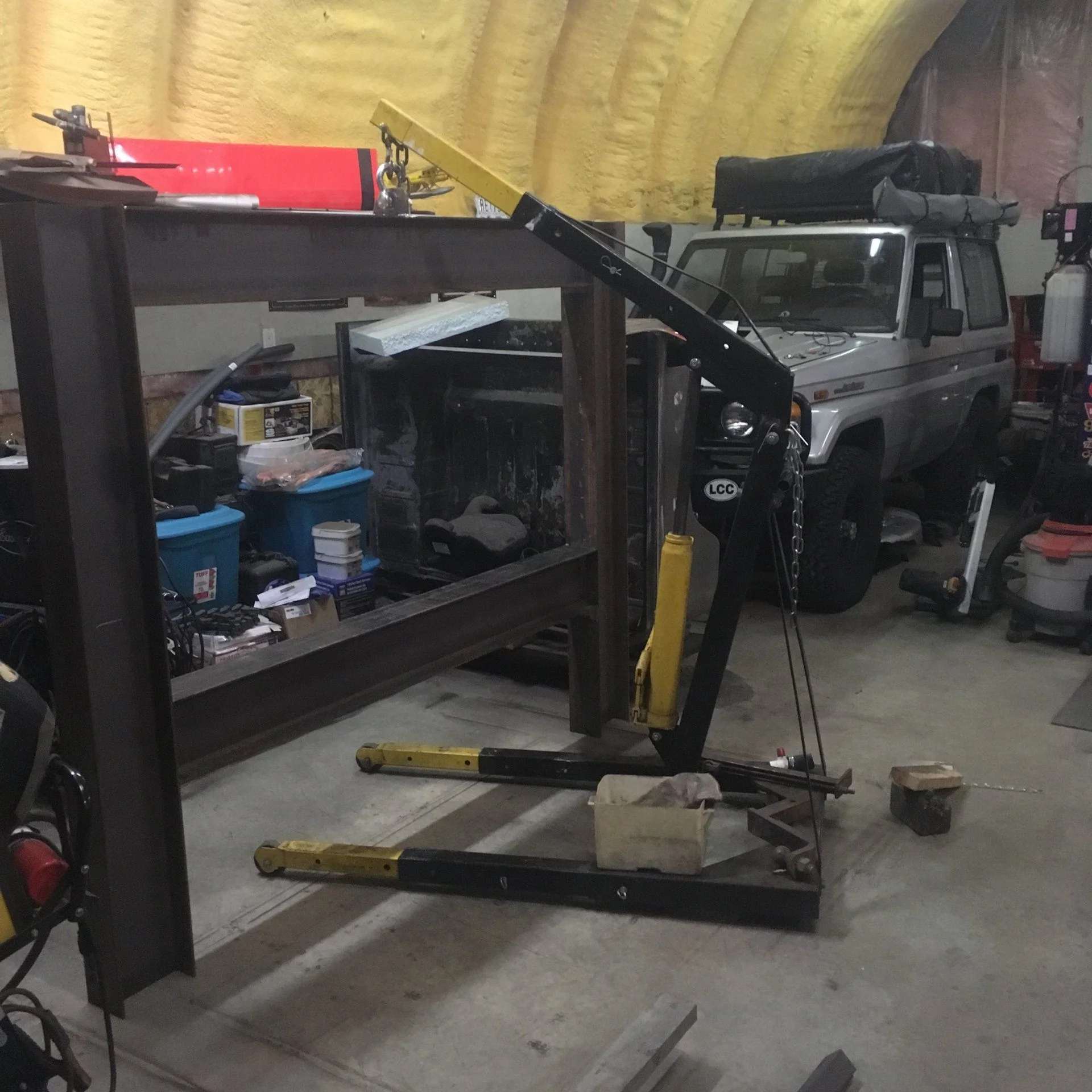

Well, I managed to get the main frame structure welded together today, was interesting flipping it over to weld the other side... involved a lot of “I probably shouldn’t be doing this” and “dont fall, don’t fall.... please don’t fall”
After measuring 27 times, and then a few more - I tacked the beams together and lifted the frame vertical so I could get at everything. Glad I welded a lifting eye on the beam first!

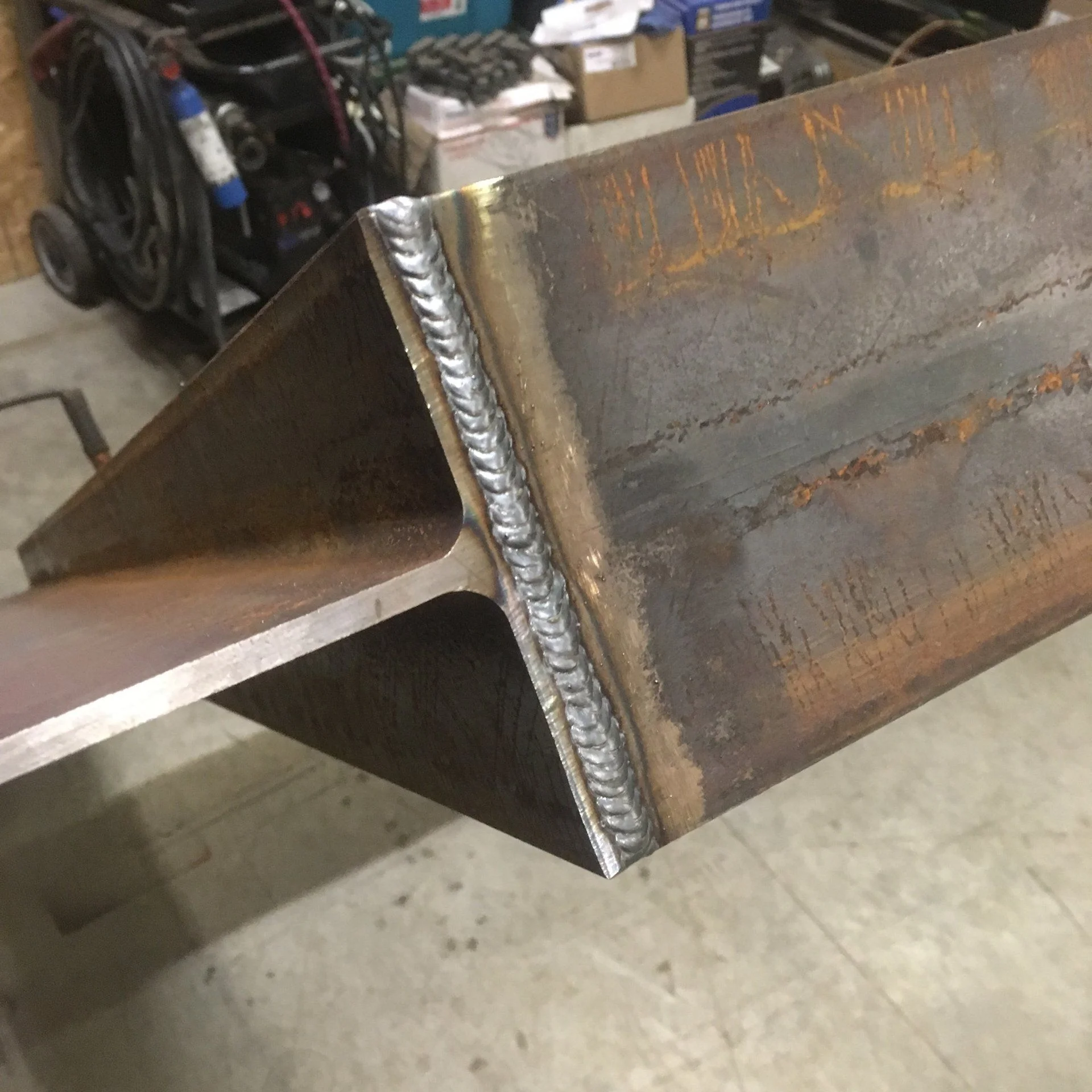

With it standing I welded the cross beam lower flanges, and the lower cross beam top sides. Once these were welded I did a big fat weave on the top of the top beam.

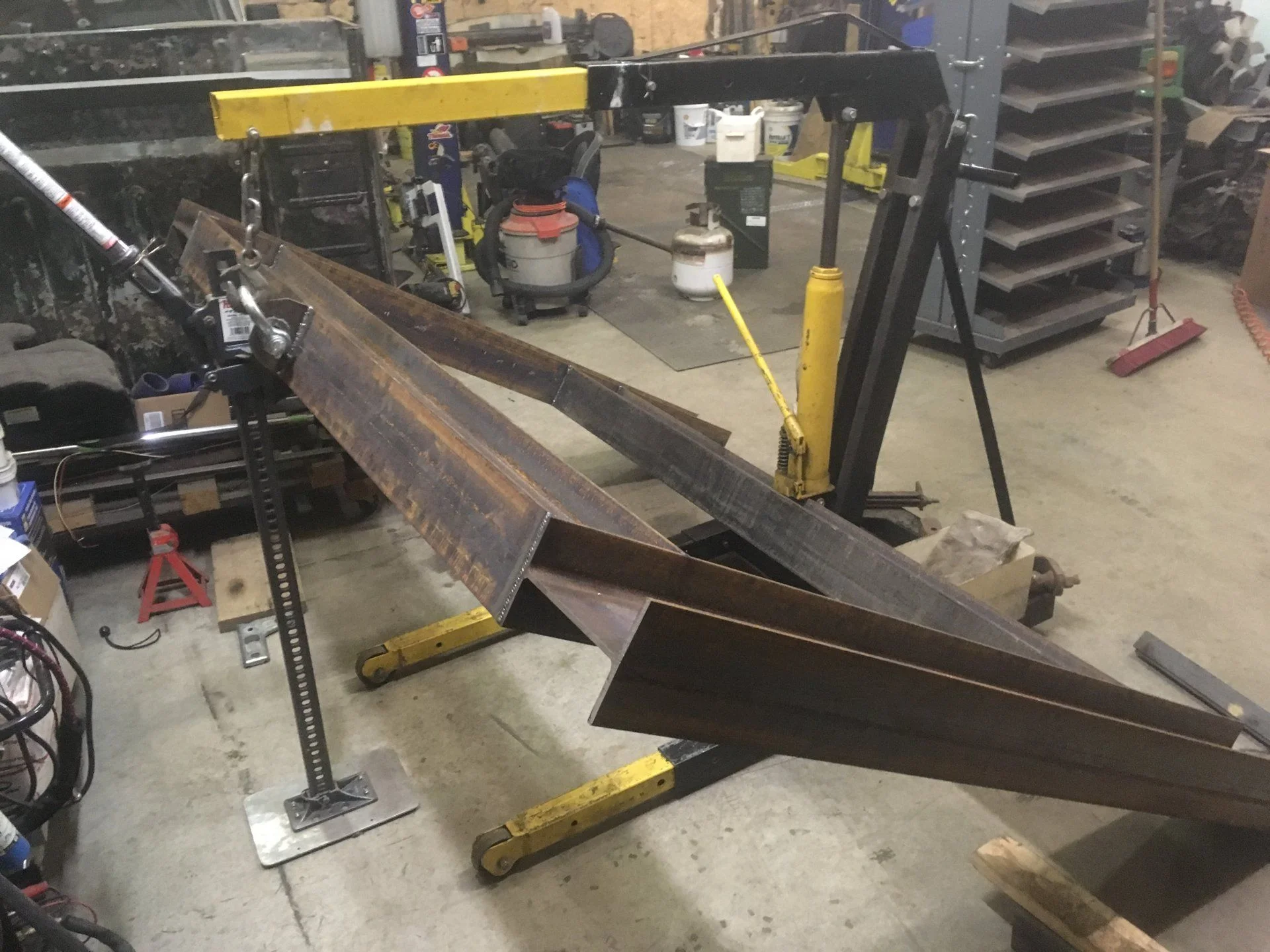

Next I lowered it down flat again and welded the webs. Had to use the high lift to re-position the cherry picker... (one of the moments listed above!)

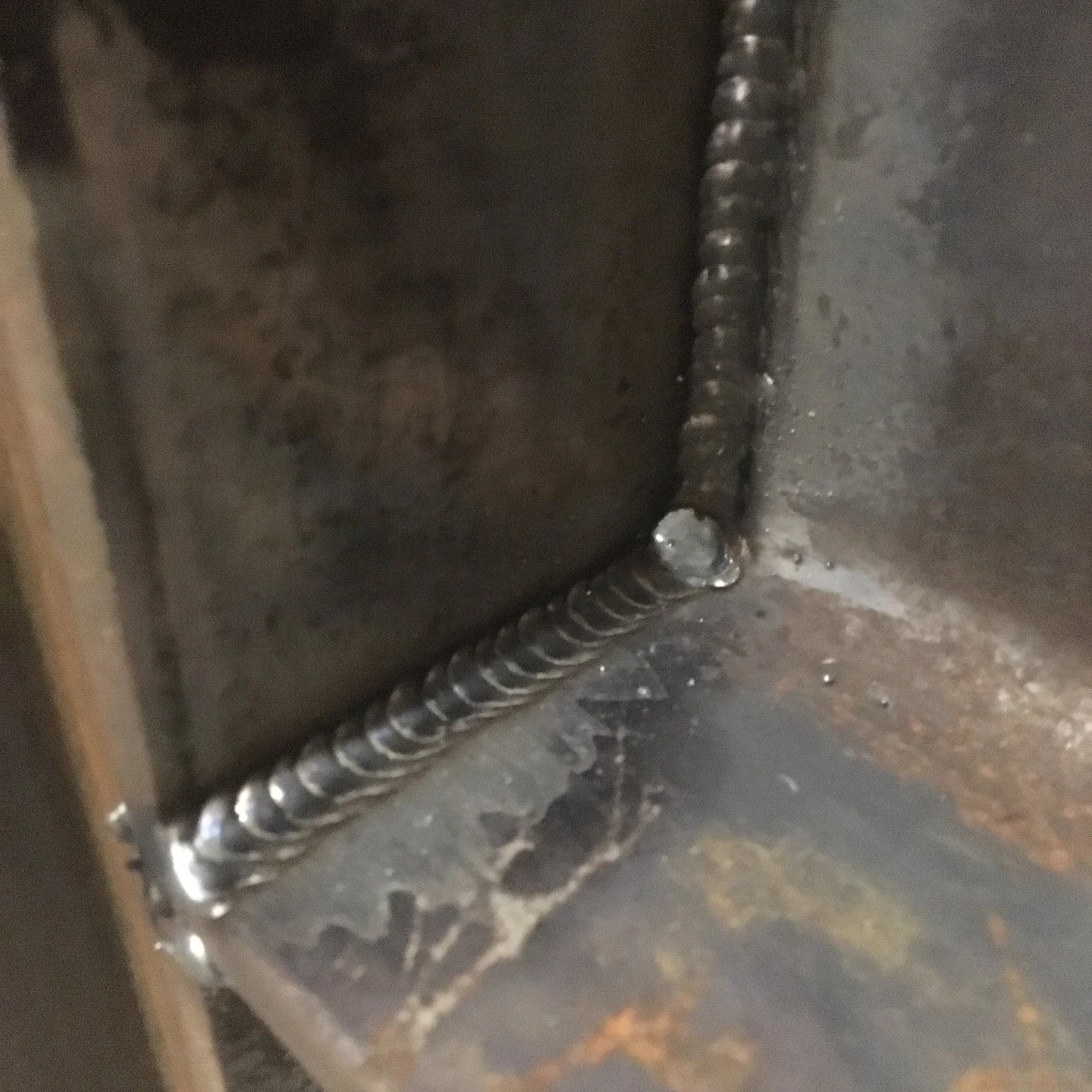

Then once the webs were welded I stood it upside down, and welded the rest of the flanges, and the under side of both beams. Flipped it again after that to weld the other side of the webs, and then once more to get it upright again!

Nice welds!
