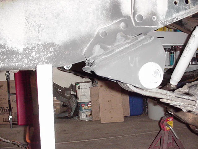

Rear Springs
got everything all done on the rear axle this weekend..
The Springs are FJ60 Rear Leafs Flipped and redrilled. This puts my wheelbase right over 100"
Spring hangers are made of 4x4 1/4 wall Sq tubing..
