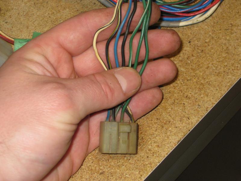

anyone help me out with the wiring harness. im going threw and removing the radio/emissions gear and relocating the starter wires for my 3b conversion.
anyone know what these two are for? the big one was real close to the emission computer if that helps.
