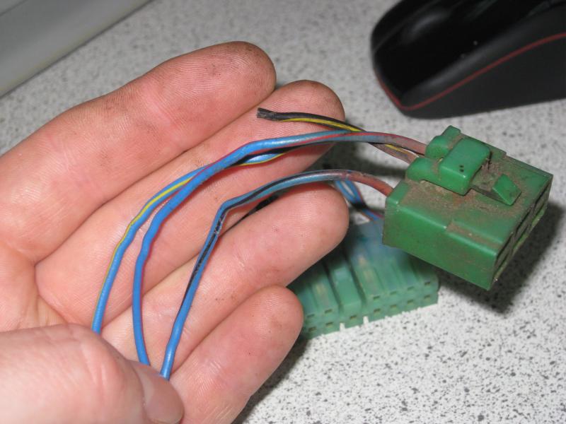

also removed these two. the big one i know to lead to the emissions computer, but what about the one in the foreground?
that little one on the last page i believe could go to the windshield washer fluid motor or the horn relay or something but its hard to say without knowing where these plugs are located on the harness..

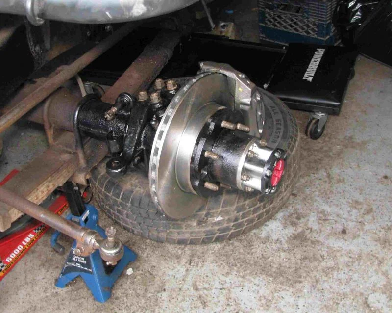

Looks like your flying through it. It doesn't look like you've painted your calipers yet. I bolted mine up and rolled the truck outside to put the body back on when it was raining and they began rusting almost immediately. It might be worth painting them before you have the lines attached and bled. Just my experience and suggestion.
by NO mean am i flying threw it but the pace has picked up . iv owned it for just over a year now. i think i will shoot them with a bit of paint, im waiting on new pads to come in. Napa said they were loaded but all they came with was hardware?
